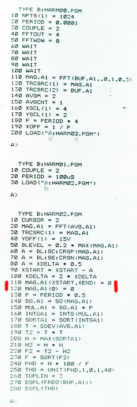

Thanks, nice files, give also good idea how sounds -40db of K2 to K6.
It shows 0,035% for the clean wave and 1,001% for K2, dropping to 0.99% for K6.
I increased sampling points x4 and it dropped down to 0,015% for the clean wave.
Still much 2 much, maybe more averaging could help.
Don't know how good was the guy who wrote the program, I understand maybe 50%.
