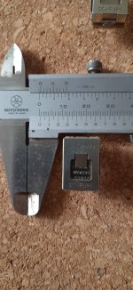

I just install SC-PURE clocks and seems like the Q7 clock-sockets do not hold them very good - this is kind of disappointing because I never remove the stock clocks and from what Ian said the sockets should hold the SC-PURE. It is not a desired thing that I have to order the new sockets and then solder them on Q7
Any ideas how to use a anti-vibrating material on top of the clocks just to hold them a bit pressed on the Q7 sockets and to provide anti-vibration solution? As you see in the pictures, above the Q7 I have HDMIPiPRO and TransportPiAES.

maybe use Blu Tack for the Clock's.I just install SC-PURE clocks and seems like the Q7 clock-sockets do not hold them very good - this is kind of disappointing because I never remove the stock clocks and from what Ian said the sockets should hold the SC-PURE. It is not a desired thing that I have to order the new sockets and then solder them on Q7
You're correct, there's a small but inconviniant difference in size.I just install SC-PURE clocks and seems like the Q7 clock-sockets do not hold them very good - this is kind of disappointing because I never remove the stock clocks and from what Ian said the sockets should hold the SC-PURE. It is not a desired thing that I have to order the new sockets and then solder them on Q7
For the time being I resolved it as you can see in the attached pictures.

I wonder about that RTOM Moongel if is ok with the temperature of the clocks... I don't want it melt on the clocks or maybe became sticky so that could damage the clocks?
I think I need something on top of the clocks to keep them pressed downmaybe use Blu Tack for the Clock's.
