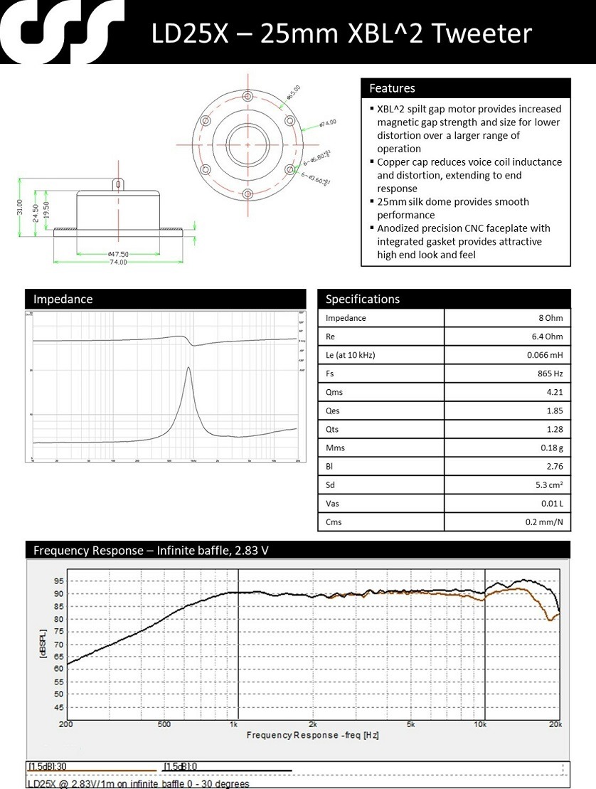

I'm not going to pretend that I really understand this subject, but I'm intrigued by the idea of Zobel networks and would like to learn if it would improve my speakers, which are currently leaning toward a harsh top end.
They are small T-M-M towers, with the 25mm silk dome CSS LD25x XBL tweeter above a pair of CSS LDW7 7" midwoofers, crossed at 1800Hz. Crossovers have good quality components by Erse and Jantzen.
Actual construction of a Zobel network seems pretty simple, but I don't really understand how to design one that's right for my speakers. Can anyone help?

Looking at the specs for that tweeter, the FR seems to rise at higher frequencies. The slight rise in impedance will result in a rise in voltage as well. A zobel can tame the rise in impedance, but not the natural rise in FR. I've used a parallel trap circuit to tame a similar bump in FR. There may be a better way?

I think of putting a zobel on a woofer, in the case where there is significant inductive impedance rise at high frequency in the woofer, which would reduce the expected attenuation of the woofers low pass. A zobel would counteract the woofer inductance rise, and in conjunction with the woofer LP provide some additional attenuation on undesired HF features of the woofer. I used a zobel to good effect once on a speaker with a 1st order electrical LP on a woofer with a breakup that was intruding on tweeter performance. That being said, it looks like the CSS LDW7 doesn't have a whole lot of impedance rise at HF (fancy motors in modern woofers have features to control inductance), so I wouldn't expect one in this application.

As noted though, with this driver's very low inductance (Le) it will have no audible impact on its usable HF passband.
