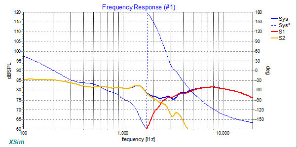

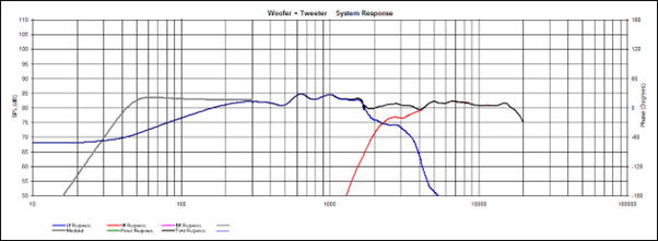

I've posted this here before, but have a look at the result for Paul Carmody's Classix II speaker: the top graph was from Dayton's files for the DC160 and my fptrace for the tweeter from Vifa BC25 data sheet. Bottom is the real speaker.
