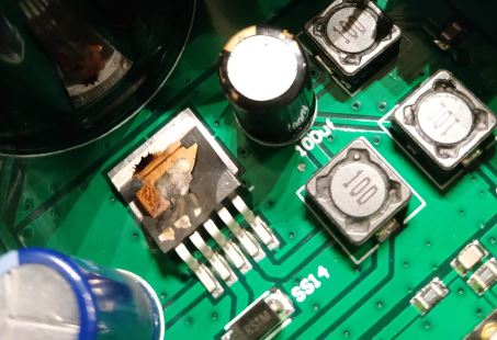

A forum member just bought a Zero Zone TPA3255 amplifier board and supplied it with just below the recommended 2x28Vac. A nice looking board. Quickly, the LM2575 chip (buck) for the auxiliary 12V supply burned off to an extent where a part of the chip-housing left the chip.
Photos from "before" showed it was an LM2575S Buck regulator with an absolute maximum for the input voltage of 40V. The recommended supply voltage (2x28Vac), when rectified, can pass 40Vdc in idle mode of the amplifier. We believe(d) this to be a reason for the LM2575S to break down and an LM2575HVS should have been used instead.
Studying the LM2575 datasheet, 330uH is shown as the Buck choke. On a photo of the board I notice a "100" marked choke of the type used for cheap class D amplifier output filters. "100" should mean only 10uH. I made an estimate of the ripple current in the choke and I arrive at 16A peak!
The switching frequency of the LM2575 is 52KHz which should correspond to a switching period of 19.2us. The Buck ON-period is found to be (12V/40V)x19.2us=5.8us. The current rise in the 10uH choke during 5.8us with 28V across the choke (40V-12V), I find to be (28V/10uH)x5.8us=16.2A!
The 1A rated LM2575 is trying to handle a current ripple that should be 16A. If I'm right, it will never succeed and the Buck choke is far too small. Very likely the reason for the LM2575 to burn.
Can anybody see if I make a mistake in my calculations?

May be no error or several of them, First, check that really 100µH coil is really 100 and no 10.
Second, LM IC's are known to be faulty. For buck regulator, my experience that L4970's from ST are the bests, with MOSFET output, easy to sync and has soft start circuitry.
Also, larger choke inductance means less current ripple, but slower compensation network, so, more sag under audio peaks.

Thanks Dani, 1x28Vac. I have been dealing with too many symmetrical power supplies lately.
NB: I believe I have more 330uH in my cupboard so I can send you one if you like.

Hi Dani,
Let's wait a bit more for comments if I am wrong in my assumption. Else, the 10uH choke should be replaced with a choke having a much higher value. TI suggests 330uH which should leave a current ripple of some 0.5A. With the present 10uH choke, you just risk blowing your replacement LM2575 as well. The impedance of 10uH is far too low.

Can you show me the choke you are talking about ?
Of course. It is the choke marked with "100" closest to the LM2575 IC. It corresponds to the 330uH choke on the top of page 2 of the LM2575 datasheet: https://www.onsemi.com/pub/Collateral/LM2575-D.PDF
On the board they have put 10uH while 330uH is advised. Quite a difference. 330uH has the marking "331".

I understand that my doubt about the Buck choke value is confusing. How come that a board that should just work is stated to have more important flaws?
ON Semi's datasheet ( https://www.onsemi.com/pub/Collateral/LM2575-D.PDF ) has a good explanation about continuous or discontinuous operation on page 17. A 10uH Buck choke should give a rather extreme discontinuous operation. ON Semi has, on page 13, choke selection graphs. For the LM2575-12, with 40V input voltage and a maximum output current near 0.4A, a Buck choke of 1500uH ("H1500") is recommended. Even above the 330uH I mentioned before.
This indicates support to my worry about the 10uH.

Even if you put back an LM2575S, you risk blowing that as well, even with less voltage. You need also to change the choke. It is likely that it was the 10uH choke that blew the LM2575S (current overload) and not the voltage.
