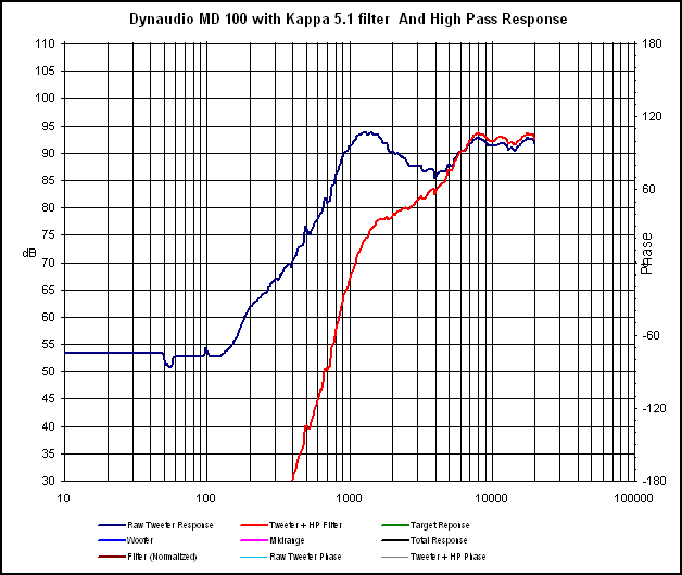

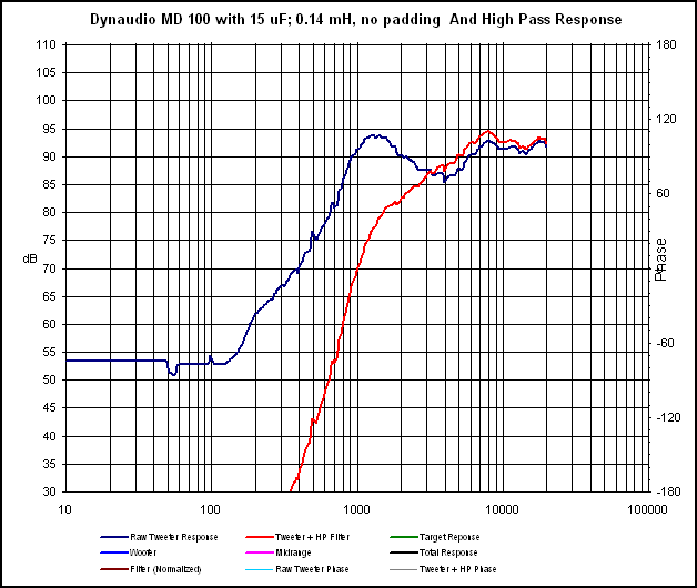

This is a quick sim of the MD 100 with original filter and some mods.
Might be very well that this is the lack of HF you have. Try to bypass
the existing 8uF with a 7 uF and leave the small inductor as is.
Oh, OK I have these 10uF's I pulled from something - nice audio grade, I'll swap that 8uF for the 10, and see if it needs more, then see if I can add 4.7's or some other.

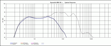

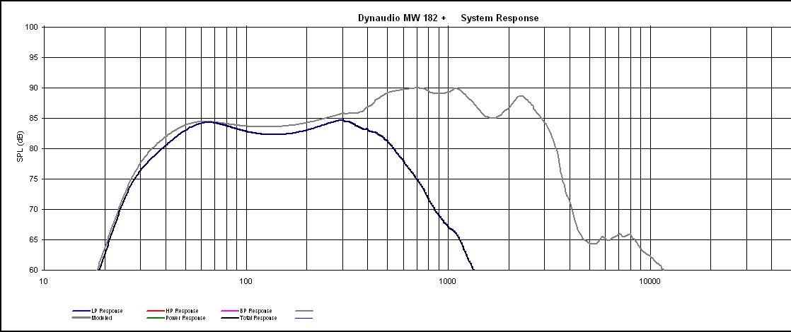

There is a 2.5mH inductor in series and 150 uF cap with the woofer - I think its a 350 hz 2nd order XO.
How much spl is it reducing especially in the lower bass. The inductor probably has 1-2 ohm resistance right ? That could make the difference for this set up.

Many forget that even if the woofer is straight wired, it *always* has an internal series inductor which cuts highs.The woofers are close relatives of the Dynaudio MW180's.

Relatively mild 6dB/oct and you can't choose the crossover frequency, you have what you have, but definitely attenuates highs and rises impedance ... exactly what an external series inductor does.

The tweeter benefitted from your tip of the cap in addition to the other cap. Its good with spl just a db or 2 below the mid and sounds damn good.

@JMFahey - you're talking about the coil's internal inductance with climbs as its frequency rises - which is why a Woofer isn't a full range speaker right ?
