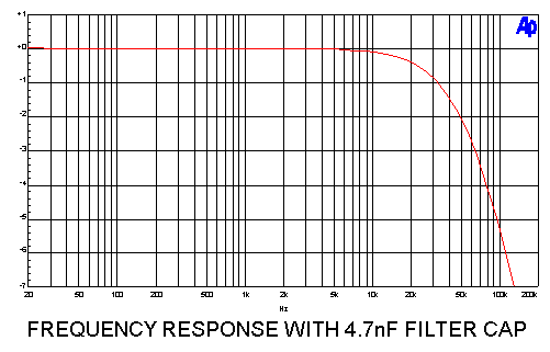

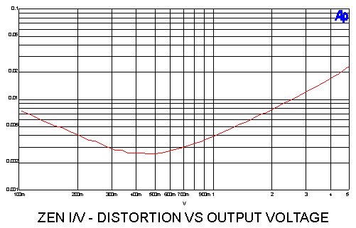

Below is the distortion versus output voltage and beside it is the response curve of the circuit as shown:
This curve was taken at 1 Khz, and does not vary over the audio band. The values below 0.4V output reflect broadband noise, which in my test setup was below -100 dBV, or 10 uV. The low frequency performance can be extended arbitrarily simply by increasing C1 through C4 or removing them altogether. Without C5 the bandwidth very high, and with C5 at 4.7 nF, the response starts to decline at 20 Khz. You probably want this, but maybe not. Conversely you may find that you need more filtering. You may add a capacitor from the input to ground, keeping in mind the approximately 15 ohm resistance for your RC calculation, and you may find that you want subsequent low pass filtering after the output.

On the graph is that volts rms or peak volts?
Also what is the load?
It would be nice to have 3 curves of distortion vs voltage at three different loads eg 10k, 47k, and 100k.
Edit: It would be nice to see what the distortion looks like. Is it predominantly third harmonic?
