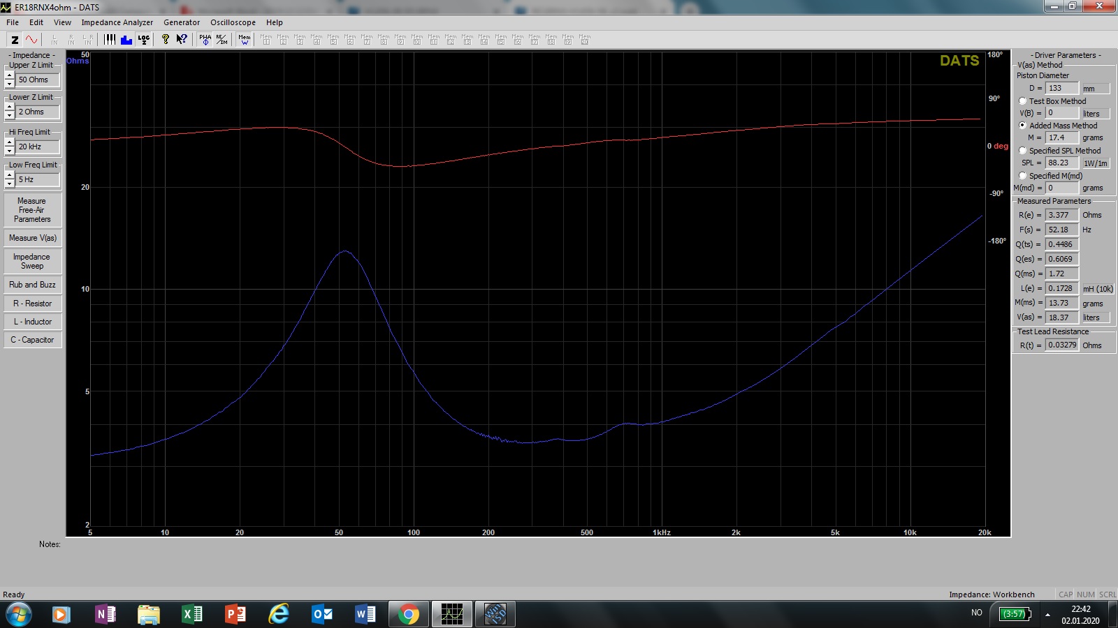

I can measure the impedance curve.
If it then turns out to be roughly the half of the 8 ohm, then adapting the crossover, should be straight forward?

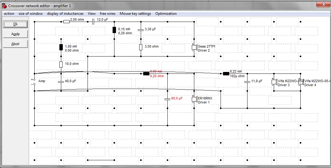

T/S parameters look way different to the 8ohm version. You're probably going to get a peaking midbass and a lack of lower bass in the enclosure designed for the 8ohm version. It'll probably want a sealed enclosure that is 20-50% larger. Vented enclosure will need a total redesign.
Aside from that, make all inductors and resistors in the woofer section half the value, make caps in the woofer section twice the value.
Adjust R0 to between 1-3ohm to set tweeter level to match.

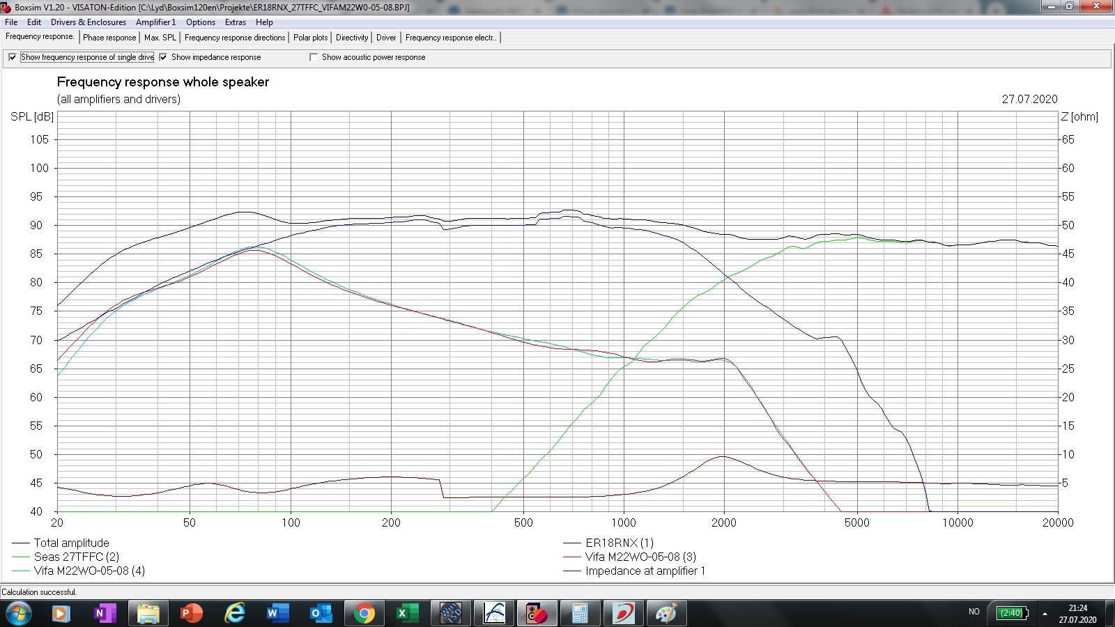

yes i see the t/s are different, but forgot to mention that i plan to use it in a sealed enclosure, and i will pair it with 2x8" vifa woofers below 100 Hz
- Zaphaudio SR71 with 4 ohm ER18RNX
