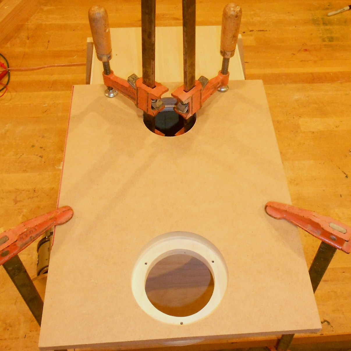

Since the boxes have a gloss finish, there's no question that you need a few templates, easy to make, and nearly fool proof. As many have said, woodworking is all in the prep, not a 5 minute router task.
First step is to cut you templates; Jasper setup, boards with nails, you can even super size the router base and use that with a nail. This could take a while to get the holes down to 1 mm tolerance.
As shown in pic, make a template to custom fit your work piece.
Need a good lam trim router, or mid-sized router. Two router bits:
1. 1/4 straight
2. Top bearing router bit. {bits can be bought on ebay - super cheap}
Saw some clamps like these at Harbor the other day, 3.99 each.
You can cut driver hole first and then come back and do the recess, or visa versa. Just do everything on top of the templates.
DON'T FORGET TO FLUSH YOUR DRIVERS!
