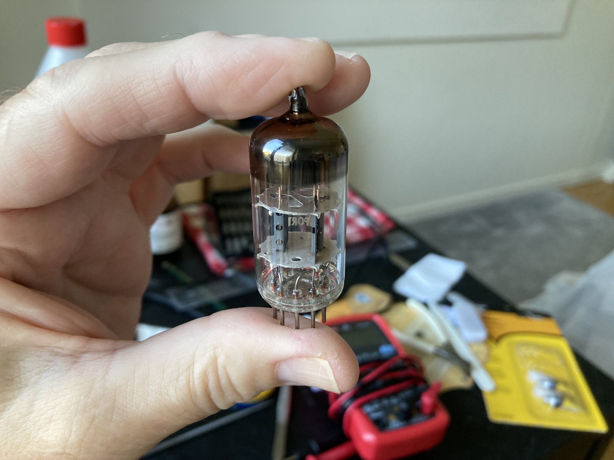

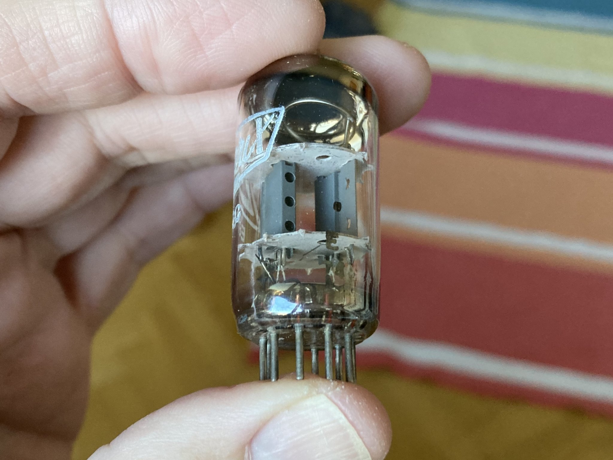

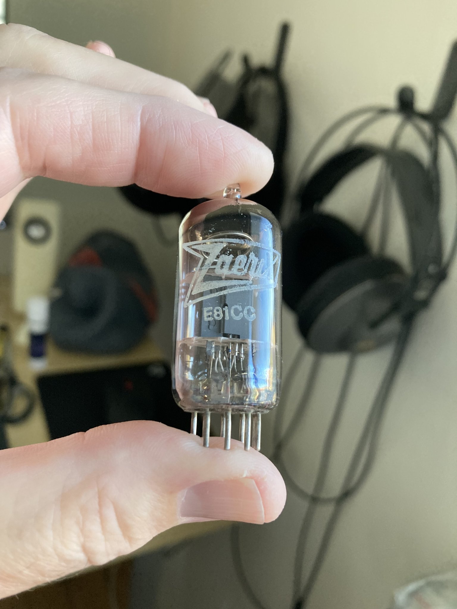

Wonder which factory manufactured this tube for Zaerix. It has a transparent disc with a strange pattern on the upper mica and is marked E74 on the glass. Four seams on top. The inner structure is askew, sloppily mounted or the result of bad handling. Doesn't sound bad, piqued my curiosity.

Yes, iPhone SE, got quite a good camera. Just afternoon daylight by the window and as close as the focus would let me.
E74 may be May (!) 1974, if that's any help. I've got tubes from most major manufacturers but have not seen anything like this before.

The etch code is incomplete and/or sloppy. It should be two lines of three digits. VFx for ECC81, VGx for E81CC. Below that the factory and date code.
The construction and mica looks like my Mullard, but in Blackburn they got the codes right.

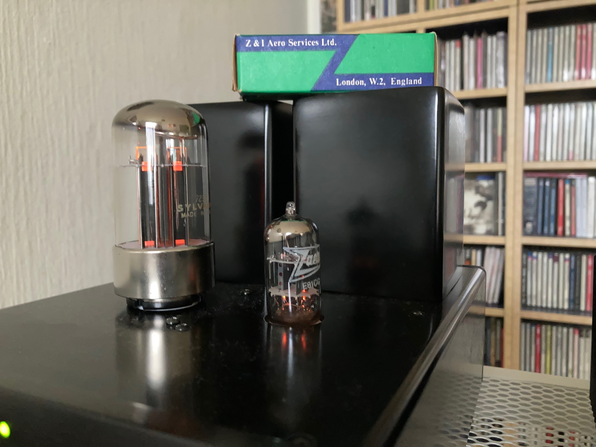

No way was anything from Z&I (Zagiel and Igel) Aero ever Brimar or Mullard. The shop (on London's Tottenham Court Road) sold exclusively Soviet stuff. Zaerix was their own brand. Quality control was what you would expect from 70s Soviet. I suppose you could call that "Special Quality"!

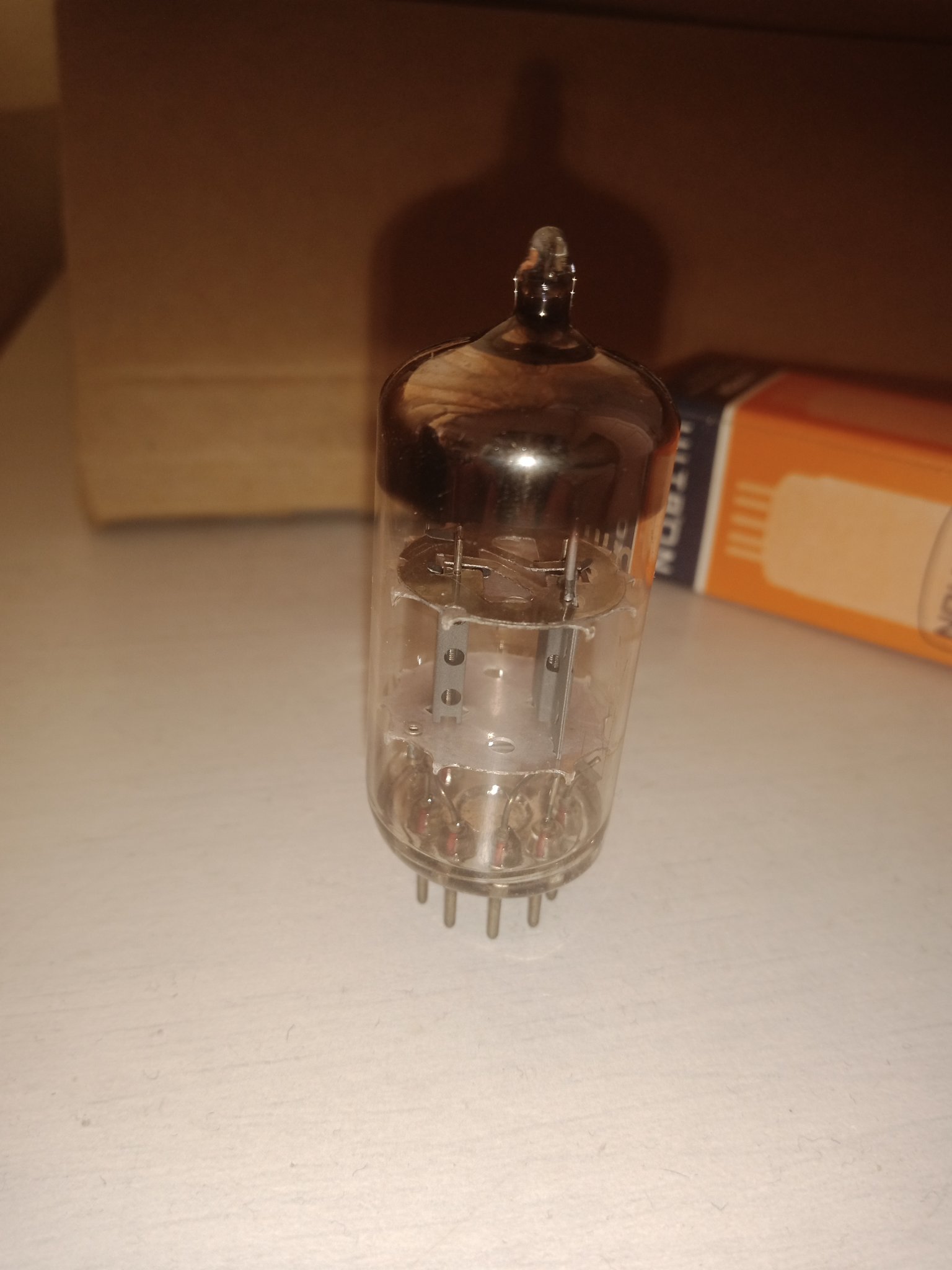

They don't look like soviet or east block tubes to me. Usually the eastern tubes have red-looking pins (insert smirk here) where they pass through the glass..
Here's a Philips marked ECC81, manufactured by Mullard in Blackburn (Heerlen manufactured ECC81 does not have that transparent disc on the top getter as far as I've seen).
The Mullard is almost identical to the Zaerix except that the latter has four seams on top which apparently no Mullard has. I think EI is a good guess as the factory behind the Zaerix. Is there any source confirming that EI took over Philips machines and tools in the 1970s?

According to my 1970 databook VALVO Handbuch Spezialröhren, Valvo (and probably any other other tube maker under Philips' care) never made any E81CC's. Instead, they called their SQ version of ECC81's 6201. Additionally, I'm missing the pinch envelope that was typical for genuine Philips/Valvo etc. SQ tubes. Hence, I agree with you who said that these tubes might have been made in Eastern Europe with the help of old Philips machines and can't even exclude that these are plain customer quality ECC81's, hence fakes.
Best regards!
Late reply, but with JacobLTA's photo and Kay Pirinha's comments I think we can safely identify this as an EI manufactured tube, a good but ordinary ECC81. Z&A Aero Services wouldn't hesitate to "improve" the tube by naming it E81CC, apparently they illegally sold American tubes to Cuba in the 60s.
