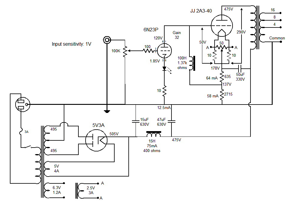

I haven't built the "free lunch" but I have built many "monkeys" (see Epsteins's page for the distinction.) Unless you build it exactly as Epstein did with the exact same power supply, these are not really beginner projects since they can require some juggling of resistor values and computations to figure out the needed values.
They are extremely clear sounding once you get the thing working properly thanks to the two stage design and the direct coupling. I would not suggest the 6C45P and battery bias for a beginner either. You would be better off with a the 6DJ8 family and LED bias; but again some engineering is required to get the amp to function at its best.
Here is an amp I built several years ago. The choke is by Electra Print although any choke with 100H at 15mA will work. Naturally the choke DCR will become part of the computation for the 2A3 bias resistor. This amp uses the 6N23P which works fine, but I found it far inferior in sound quality to the triode connected E180F (I am traveling and don't have the most recent schematics with me). So to build this amp you will have to be able to compute the two resistors in the cathode of the 2A3 to ensure both the 6N23P and 2A3 work in their most linear region.

I would like to ask what we use resistors to the cathode of 2a3(Watt).How much mA go through 2a3?
The amount of current through each resistor is marked on the schematic also notice that the voltages dropped by the resistors are marked on the schematic. Multiply the voltage by the current to get the wattage and then double that amount for safety.

Hi Tassos
For 2A3 the wattage i prefer the following
10 Ω and 50 Ω i prefer 1W
for 635 Ω is about 2.6w and i prefer to put 25 W
for 2Κ715 is 9.13W and i prefer 100W the total
All ten times for stability

demetrios, your numbers look good, but I don't like the 10× rule. Why? Because by the time you get close to a 100 watt resistor, you are also looking at wire wound, or other semi-inductive mode. Better to just use 2.5× as a good figure, and let it be.
2.7 kΩ with 137 volts across it is yes, 9 W. × 2.5 = 22.5 or about 25 watts. This can be had nearly trivially with 5 ea 5 watt non-inductive standard resistors, either ⅕ the ohmage in series, or 5× the ohmage in parallel. Makes little difference. Could even do it with a bunch (10) 2 watt resistors, since they and dirt are about the same price.
