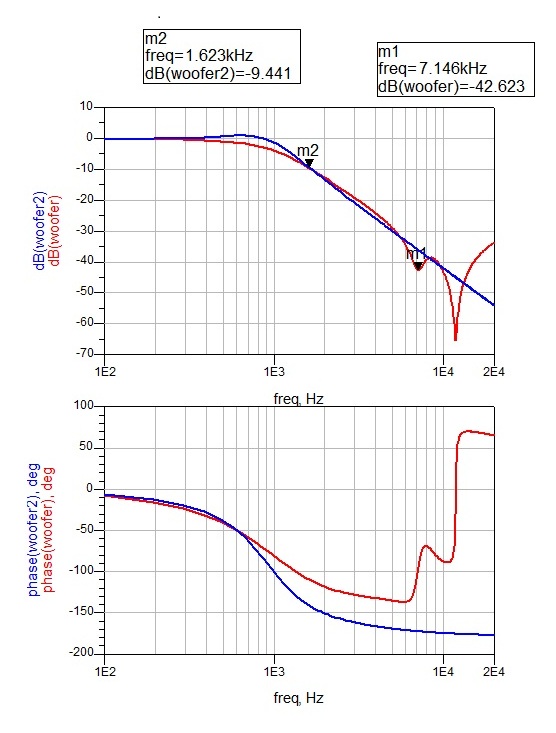

The breakup region is more than just a peak, it is an unevenness at different angles. Try to get the peak down, say -24dB and keep it smooth. This way the two drivers should be reasonably matched in directivity and the variations/sensitivity you are noticing should lessen.

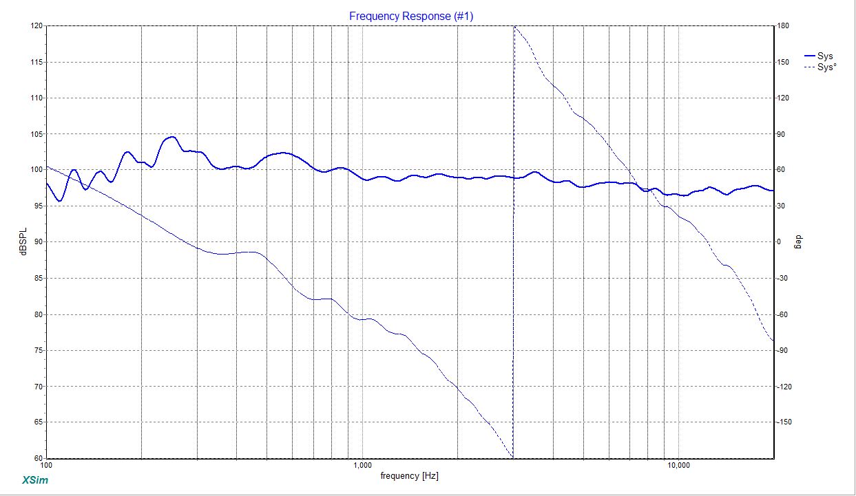

My current monitors are asymmetrical, with about a 2 1/2 order high pass and 1 1/2 order low pass if you measure order by db/octave. The principle I use for the phase matching is that they should work like Fred Astaire and Ginger Rogers. Like the famous dancing couple, they need to come together and then split apart, but not violently. The longer they linger together the better.
I know this will probably drive some people nuts, and I'm sure I'll learn more, but right now I'm just not that interested in close miked measurements for the overall crossover FR. I use close mike testing only to evaluate a driver and examine it's distortion so I can get a good idea of it's useful range.
The FR data I import into XSim are from 3' distances and a mix of gating and ungated measurements with the loudspeaker in place. I know there will be all sorts of confounding effects from the room but I prefer to leave those gremlins in and ignore them in exchange for the accurate bass to mid-range response. I know what the comb filtering and floor bounce notches are, I can ignore them and focus on the overall bass shape knowing it's accurate to the listening location.
Next, again going against the grain, I prefer speakers of controlled directivity, not wide or omni. This gives me the most clarity at my listening location with modest room treatment, as opposed to heavier room treatment that would be needed with wider dispersion speakers. This is something you can control somewhat by choosing the appropriate crossover locations.
Lastly, I don't use a flat FR. I use one I like, which is similar to one I got from Madisound a while ago. A mild boost around 100 - 600 Hz, descending to 1 kHz, where there's a knee, then very gently descending 2-3 db by 20kHz. Find an FR that works for you and your environments. I think many have given up on a flat FR, but there are variations everywhere. The famous East Coast Sound vs. West Coast Sound are examples of these ongoing arguments. The best part about being in DIY of course is you don't have to accept anything but your own taste. Make what you want. Make it do exactly what you want, and be happy. 🙂 But finding that out may take investigating on your part.

but what I import into XSim is the 3' distance measurements.
3' refer to feet, so approx 0.9/1m.

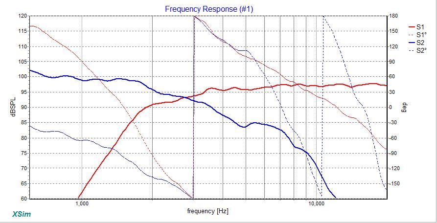

The target slope/filter alignment is not what I meant to focus on. I meant, regardless of whether you use 1st or 4th order, I like to align the phase of the drivers in more than just one place. Let me include a graph.
Notice that the phase curves (dashed) approaches gently from 2k and doesn't really separate until 3.5kHz.
To answer another point made elsewhere, drivers don't need or care about ideal Butterworth curves. We care about this in purely electronic filters, but in passive crossovers as some one else said, we care about amplitude and phase of the finished product. In electronics using LR4 or Butterworth, etc. is great because it helps us match up a low pass and high pass section that we know will be perfect, or at least very close to our desired result.
In speakers it's much harder to get all of this to happen. Within the realm of possible priorities during crossover design:

If you look at the chart above, you can see that the amplitudes don't match a standard curve, but look at the finished curves (note change in F scale):
Now, maybe you don't like my curve, or my speakers. That's OK! The point is I gave up "ideal filter curves" for everything else I wanted. 🙂

To Mario's point, yes you can wrangle (wrestle) any driver into a close-to-ideal 2nd order Butterworth for instance, however wrestling it and the matching driver across all the important paramters AllenB and I have mentioned is another story.
