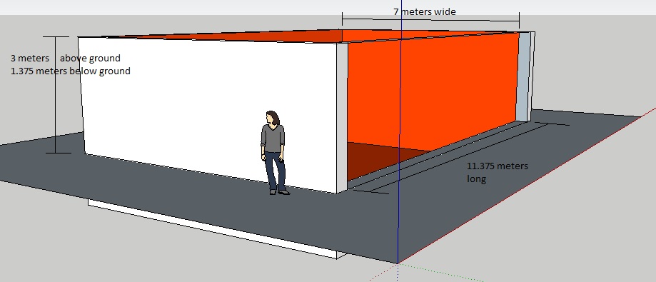

Just crunching some numbers to see if a golden ratio room is even possible with a large projector screen in the room.
I was originally looking at 8 meters wide, but to keep the room down to a sensible size I have reduced that to 7 meters, that gives me a length of 11.375 meters and height of 4.375 meters.
Length and width aren't major problems but the height is the tough one... Trying to build a home theatre room without it looking like an industrial building means I need to try and loose some of the height.
That gives me two options either reduce the length / width or sink the room. I think the later would be the way to go. If I sunk the room by 1.375 meters I could have a 3 meter ceiling height, the same as the room I am in.
Obviously any wall width and acoustic linings would need to be added to the outside dimensions. Also thinking that a second door would be a nice touch to help keep the noise away from the neighbours.
