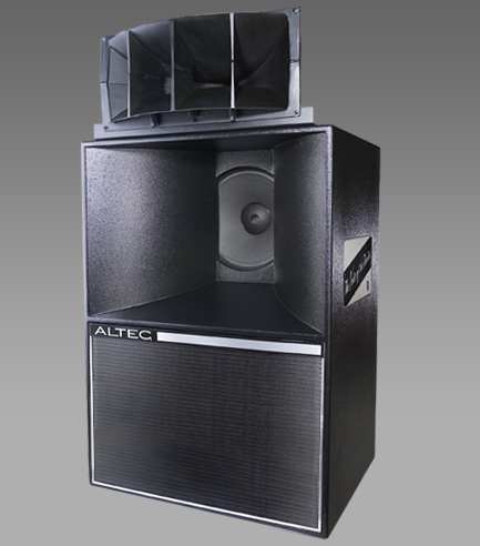

Eventually and very much depending on your woodworking skills you could build an Altec VOTT A7, the natural home of your 803s.
Whiich btw appear to be worth about $400ea on the s/h market.
PS: As far as I know the 803 woofer was renamed 416 in the mid '60s to avoid confusion with Altec's 800 series of compression drivers and horns.
Thanks for the info after reading your post i started doing some searching about Altec and run across the econowave and the Z19 crossover and i have the 803/416 and the BMS 4550 so i have decided to go in that direction. I will be keeping the L300 cabinets and little by little i will buy the components to restore them. My uncle is going to sell the beyma cp21 on ebay for me so that money will go toward buying crossover components and building cabinets.
