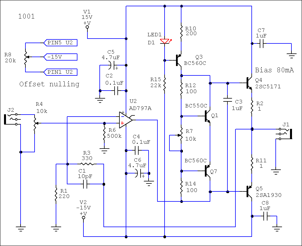

hello everybody,
I'm going to test this simple amplifier for my 32 ohm sennheiser hd 448, the voltage gain is 2.5, the rms output power is a little bit more then 100 mW (32 ohm load and my ipod nano), all discete bipolar never switch and the output stage of AD797 too. what do you think about this circuit? maybe there are some errors... 😕
It should work quite well, I would probably make C7/C8 larger. I'd probably make R2/R11 4.7 ohms as well
well, good tips, but what do you think about sound quality?
this net would be free of crossover distortion (AD797 too) due to class A biasing, it would has very low output offset (absolute and thermal drift) and very low noise.
I'm going to do this circuit and test for noise, stability, dc offset, stability of biasing current, offset thermal drift, quality of sound and reliability.

I will read Your comments so please keep posting. I like the low part number high quality designs. I'm also interested in how the final amplifier will look like (PCB mania or something...).
if you learned how to use this free schematic drawing tool you could gain some more insight about how the circuit works

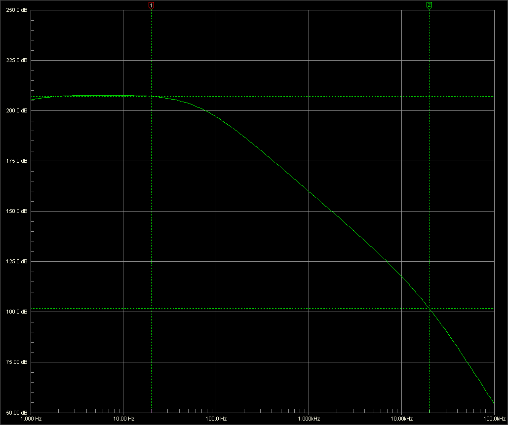

I did a preliminary sim of my circuit before a future testing to check the feasibility, I need to know if it is enough stable, how the thermal drift can change the biasing current of the output stage and possibly fix it.
if the circuit pass this test it 'would' be better for instance of any cmoy or O2 amp, with lower output impedance, lower distortion, lower noise but it needs more current because of its full class A design.

everything has its limits - feedback factor grossly exceeding your S/N is fairly useless, "costs" you in needing higher loop gain roll off rate, actually reducing available feedback factor at higher frequencies
http://trs-new.jpl.nasa.gov/dspace/bitstream/2014/19495/1/98-0905.pdf doesn't explain the noise limit but does show the basic "conservation law" of feedback
for headphones heavily biased output buffers can have few 0.1% "open loop" distortion, adding 80-120 dB loop gain likely gives as much performance as can be distinguished from system noise at audio frequencies - ears do not do 10s or 100s of seconds of averaging to reach down into the noise floor like we can with fft
my design has 102 dB @ 20 Khz open loop gain, I think no one opamp have the same gain. of course the stabilization network decrease available feedback factor but at higher frequencies, over 70-80 khz (in my design)....actually reducing available feedback factor at higher frequencies...

I just wanted to point out where there are limits and where there is real improvement – the “207 dB loop gain” isn’t a “real” improvement – emphasizing it may confuse/mislead the many here who haven’t mastered feedback theory
I certainly do think high loop gain feedback and composite amplifiers are great techniques, have built and verified some with distortion below –160 dB with an indirect IMD test and a Juli@ soundcard – a measurement that did take averaging to see into the noise may have a cool factor for feedback geeks but has little audio relevance beyond establishing that linearity for audio signals is not an issue

hi JCX, I saw the circuit you had simulated, very interesting. I would like to ask you which are the pro and cons of these high feedback amp in real audio world, are these not useful of usable, sound worse, don't offer real benefit?
thanks a lot for your posting 🙂
do headphone amps count as the "real world" even in audio?
Bode linear stability of high loop gain amps is the initial challenge - very fast output devices help with this - DSL driver op amps seem perfect for many dynamic headphones and audio signal line driving with extended GBW that makes the CFA DSL drivers usable inside many "audio" op amp's feedback loop without difficulty
if you want to go further than Bode's "Maximal Feedback" ~ 30 dB/decade loop gain you encounter "conditional stability" - reduced gain from clipping, slew rate limiting can cause higher order roll off loop gain amps to have nonlinear oscillations - clamping diodes for internal nodes, limiting "wind up", other measures can help but the clipping recovery will often look worse than "simpler", "low gain" amps
