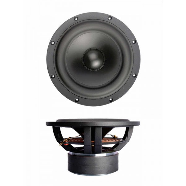

One aspect of this is the bass. So I've decided the woofers are going to be decent for small speakers: a pair of SB23MFCL45 that I have. Technically called subwoofers but small (for such things) and in my estimation able to go up to several hundred hz. Not very sensitive of course, but fine for a close listening situation. Physically just over 9" wide so could be used front mounted in a small cabinet, or side facing if the crossover were low enough, which might allow a 6" wide cabinet.

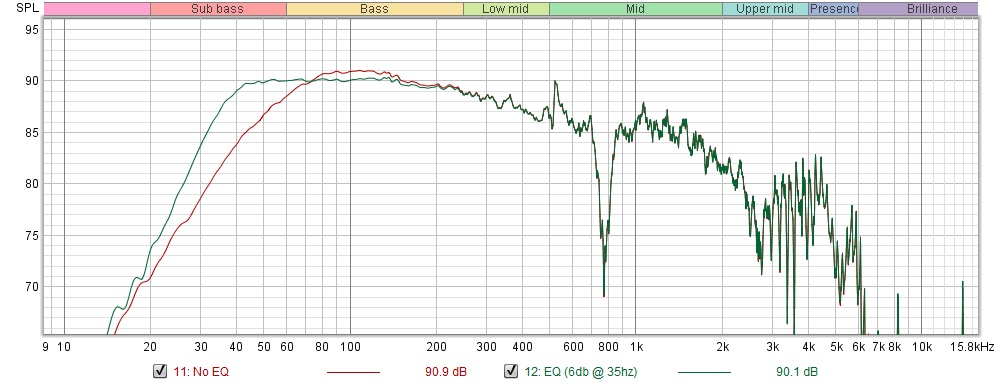

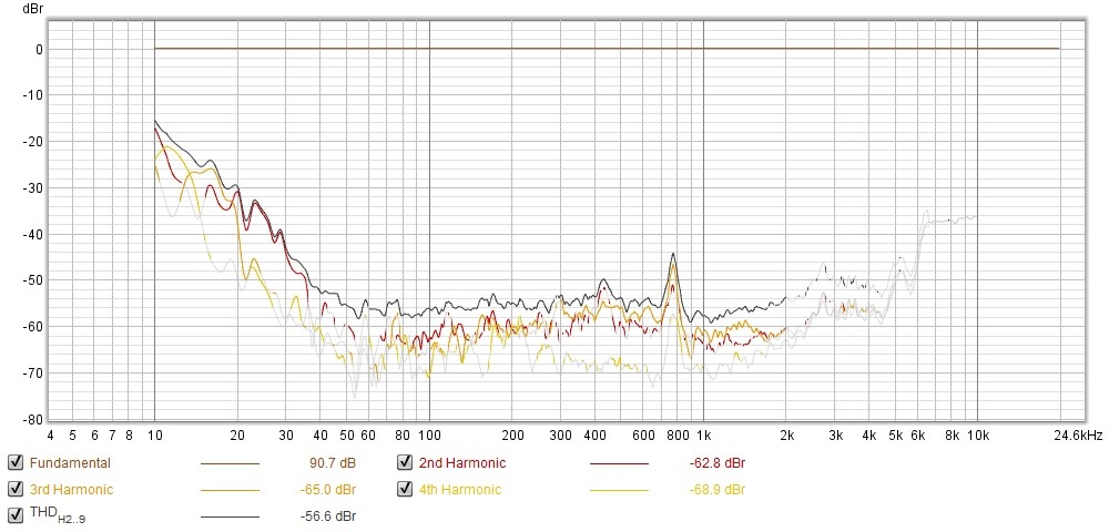

Thanks everyone. Yes they call the SB23MFCL45 subwoofers, but I agree they should make it up to a couple of hundred herts if wished. IMO perhaps a bit more (I've actually listened to them higher and they do very well). Though it is interesting (and useful) to hear that you dropped the idea, Andy - perhaps I need to evaluate them a bit more carefully before deciding what and where to cross over to.
Thanks for doing the sims, Richard; those numbers are around what I had thought too. My initial thought is to take advantage of their potential for a small sealed cabinet, as they reach low enough for me like that. Though they are small and inefficient, their SPL will be sufficient for close listening distances with one each side (one left, one right).
I just found a short thread by Graham in which he kindly shows a couple of frequency and distortion plots for these drivers in just 16L enclosures.
he was making subwoofers of course, but I find his results encouraging for my purposes too.
So I'll need to decide what drivers to pair them with, next. Through listening and looking at FR and distortion plots, the idea of crossing at a couple/few hundred herts to a wide-range driver as a mid looks possible, and is quite tempting. But I'm most interested in the midrange driver, and might want something smaller in that role than I would choose for crossing directly to 8" woofers, in which case an additional/intervening mid-bass unit (maybe around five or six inches) would be worthwhile considering; I suppose ultimately it might depend on how high I feel comfortable crossing the SB23s.
