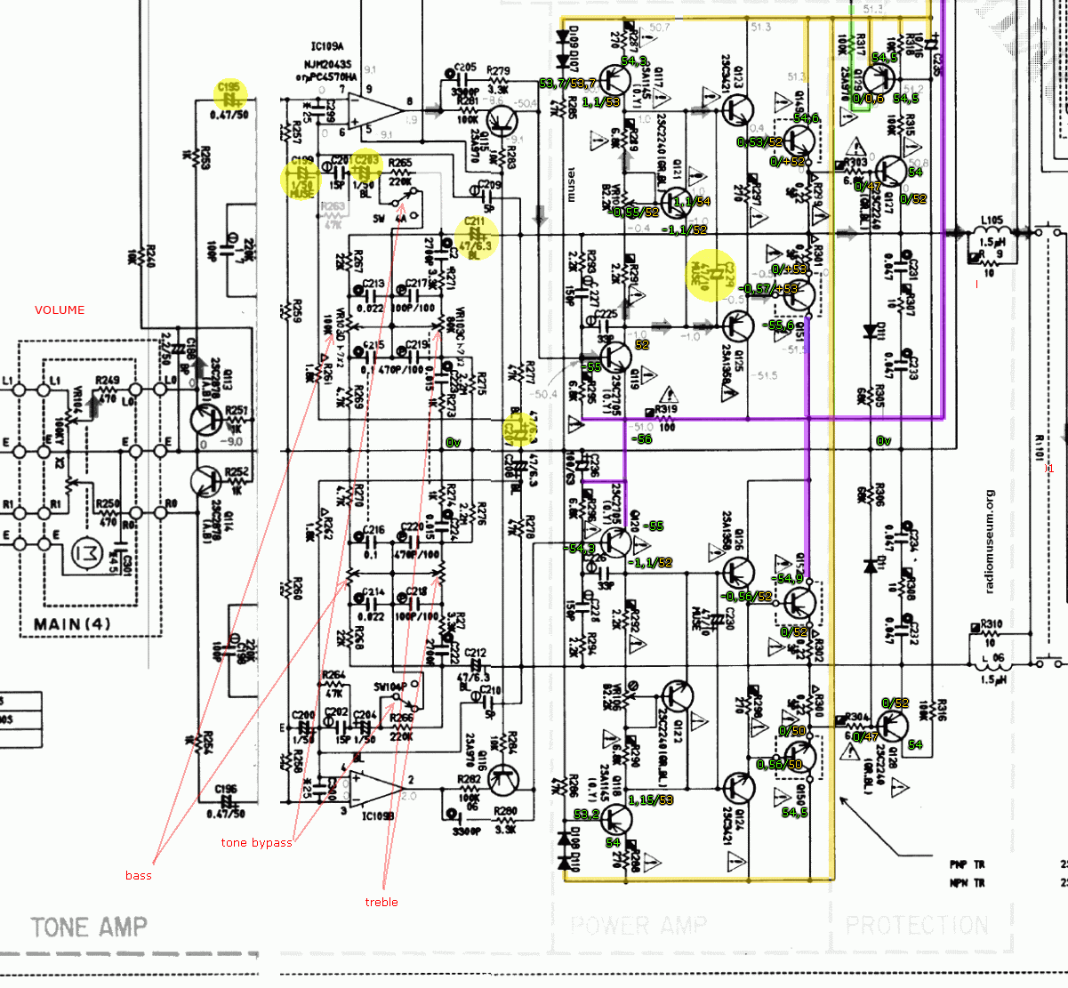

In case someone would have alternative theories, here's the schematics of the amp section. Measured values are marked green when the device is on and yellow during shut down. Yellow values are not very accurate because my multimeter sampling rate is not very high.

My prime suspects would be C207 and C211. 47µ/6.3 V caps that have never seen much DC for 30+ years are not unlikely to be seriously leaky and could cause enough DC offset for the jump in output voltage to be clearly heard when the relay engages.
You could try reforming them with the help of a DC power supply (maybe 7-12 V) and a high-value resistor (maybe 1 megohm) to apply a charge at correct polarity, though in practice nobody does that as success may very much vary. A pair of new high-quality 100 µF capacitors connected back-to-back would be a good and hopefully long-term-stable replacement. Hard to go wrong with genuine Nichicon or Panasonic or other Japanese manufacturers (e.g. the trusty Panasonic FC series). Obtain from a major electronics distributor, not some dodgy eBay seller.
This is not the only possibility though. There is also a muting circuit on the input side. You could have DC at pot wiper level (where from though? there isn't much after C195 at all, could almost only be leakage though Q113), which would be pulled down by Q113 as it engages, or Q113 might actually not be doing anything when it actually should. These muting transistors do fail. Compare voltages with Q114 and consider removing Q113 for testing purposes.
This case would be one of those where having an oscilloscope would be super handy.
