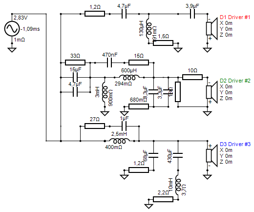

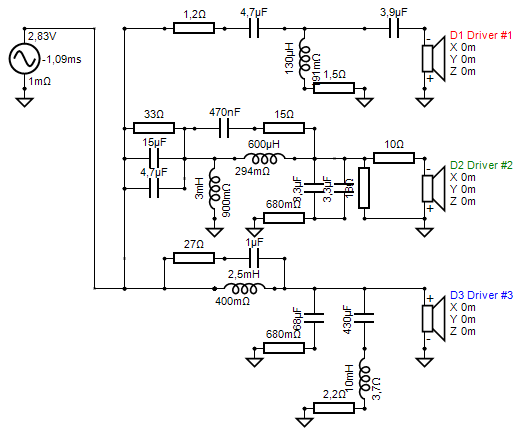

Woofer XO: Notched a pretty bad cone resonance at 3k, so I notched it with a R+C parallel to the inductor. The LP was also high Q, so I damped it a bit with a resistor in series with the cap. There was also a bump in the response around 100Hz from the coil and woofer impedance combination, so I added a impedance smoothing circuit to tame the upper impedance peak of the woofer.
The mid had a bad 'wrinkle' in the response around 2k, abt 5dB from peak to dip. I figured it was a classic cone-surround issue, so I put some Mod Podge in the area. It improved it to abt 2dB, and I left it at that. The HP was high Q and not well phase aligned to the woofer, so to make them work together better, I used a high value resistor in parallel with the HP cap. I have seen Troels do this on some projects, and this is the first time I tried it with good results. LP for the mid was also high Q, and I grounded the LP cap through a low value resistor to tame it. The level of the mid was boosted in the stock speaker, so I figured I would try a series resistor on the mid to bring the level down, and also reduce distortion. I measured distortion with and without the resistor, and it made a significant difference, 5dB distortion reduction from memory. The increased impedance seen by the mid around resonance worried me a bit. I stuffed the mid enclosure full with sheep wool to damp it a bit, and it sounds ok to my ears.
Again I added a notch to tame some cone resonances out of band (6-7k).
Tweeter: I had to change from 2nd to 3rd order (electrical) to align the phase of the tweeter to the mid (only changed cap value and added a large cap. Also a small resistor before the XO to give the FR a gentle downwards slope as I like it. I did not bother to put the resistor on the tweeter side, since tweeter distortion was way lower in level than mid anyway. I figured I would prioritize the load on the amp in this region, since the impedance was a bit tricky here because of the original filter design.
I kept the same XO points, since I did not want to redesign the complete XO and buy new components. This is why I did not bother to take complete off-axis measurements, but stayed with only the on axis.

I have done some thinking and listening, and realized the low load on the XO for the mid was causing the high Q (dough!). Some more adjustments to align phase and tune FR too.

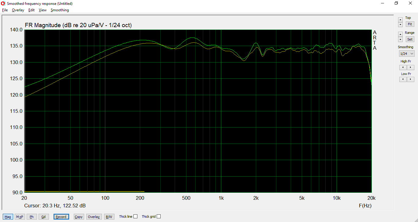

I have not spent time documenting everything with graphs and pictures (and that's why it has little value for others..) but here is a basic FR shot of left and right speakers. Just a sanity check after the latest mods to verify polarity was correct etc. Mic close to speakers between mid and tweeter, and speaker standing on the floor, and not the exact same distance to speakers either, so only a indication.
The 2k wiggle from the mid is clearly there, and possibly got a bit worse again since the Mod Podge has dried completely. Anyway, it was a lot worse before modification. There is also some corresponding peaks in distortion, but not too bad. Can's say I can hear it. Subjectively they sound pretty good.

When that surround reflection resonance is there and its more extreme than 2 or 3 dB, it really sours the midrange in a rather unfixable way. You can flatten it with EQ or xover all you want and it will still sound bad. You need a more viscous material when it dries and use a little more of it. Liquid latex, the kind you use for molding masks and other body parts, is the best stuff I found for this. It dampens much more effectively than anything else I've tried so far.
What material is the mid surround made from? I assume its a simple rubber surround and not the coated fabric Yamaha uses on their older hifi drivers?
Thank you!
I guess my ears are not that sensitive to the resonance, they sound pretty good to me and a few friends who heard them, but I guess the main issue is the reflective room in the garage, masking how the speakers actually sound 🙂
The surround is the coated fabric type, and the cone is a fairly hard paper cone. Any reasons why they use the fabric surrounds?
I don't want to add more parts and complexity to the XO, this is more about trying to improve the sound at minimal cost. I spent a lot of hours measuring and modifying, but that is 'quality time' in this hobby 🙂 I don't think I ever tried latex on surrounds, Mod Podge has worked well before, and maybe I could put a bit more of it to see if how they improve, since I have it. I only did one thin layer so far.
