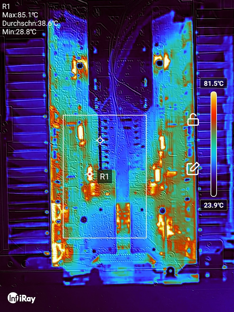

on the thermal image, you can see the right lower gets warm, thats the Left channel -HB APS
its dead cold on the left side (right channel) but the output transistors get quite warm at 90V and 22mA biasing..

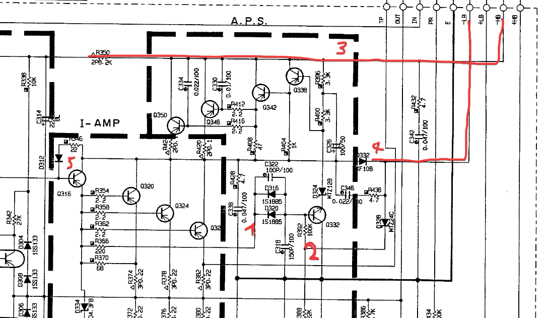

im working on a Yamaha MX-1000 right now and got a weird problem i couldnt fix despite trying for hours.
This amp uses a class-h topology with +-40V and +-90V rails.
On the right channel, the negative supply is stuck at -HB (-90V allways on the transistors) for some reason. it should be -LB.
+LB and the other channel work just fine at +-40V
ive taken out all transistors multiple times, measured them, bought new ones and put gain matched ones in there (+-10%)
i looked at every solder joint, redone the whole right channel in the end..
tested every diode.
also checked the resistors and connections inbetween as best as i could.
the power transistors are new, all tested and gain matched. 3 PNP, 3 NPN for output, 2 PNP 2 NPN for high rail switching.
This is the schematic of the Right amp board:
this is my problem area:
1, 2, 3 ,4 are identical to the other channel.
the Rail that feeds Q320 Q324 and Q328 on the left is stuck at -90V, it should be at -40V.
i checked (and later replaced for good measure) Q350 and Q346.
also measured every resistor on this board, all are fine.
All diodes are fine in their normal direction, all zeners are fine in their reverse direction.
no caps shorted, non are noticably leaky.
Q342 is good
Q338 is good aswell, so is D324 (12V zener) and Q332.
aswell as D328 (24V zener) and D332
(flipped image..)
i wrote down all differences to the other channel
Right channel | Left Channel
across D319/D320 87V vs. D316/D315 23V
across R392 71V vs R391 7.7V
across Q332 Vbe 0V? vs Q331 Vbe 0.61V
(but weirdly when i measure from ground to Q332 base its 87V, but to Emitter its 80V. maybe the internal multimeter resistance is playing tricks?)
across Q332 Vce 80V vs Q331 Vce 24V
across R400 and 396 0V vs across R399 and R395 50V
seems like Q332 isnt turning on.
its a 2SC2705
when i take it out, it measures just fine using every transistor tester i have. tried with a new one, no luck.
maybe because Vbe is 0.. but where should it come from?
Both diodes in parallel are 1s1885.
and measurements past R392 are identical to the working channel.
i checked the positive HB side aswell maybe it affects the negative, but didnt found any obvious problems.
Board pics: (too big to upload here)
im stuck, can anyone help?

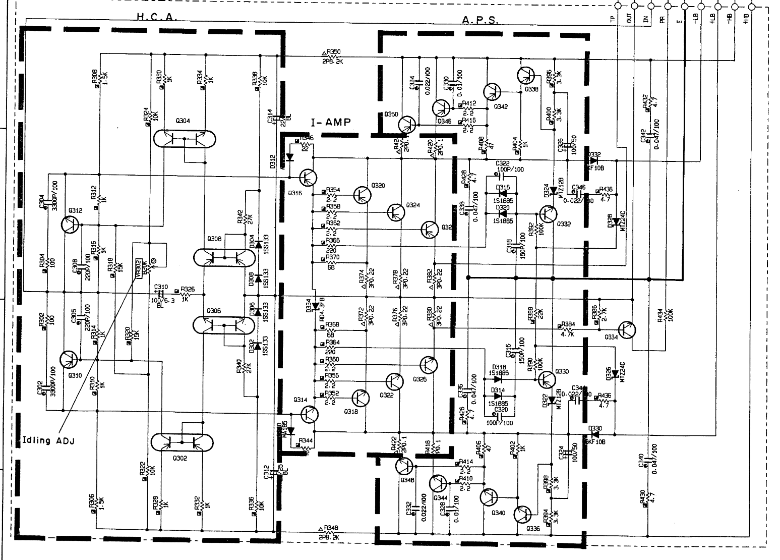

My first though is D324, but you indicate that is good. Short the collector to emitter of Q332, does the rail drop to -LB?

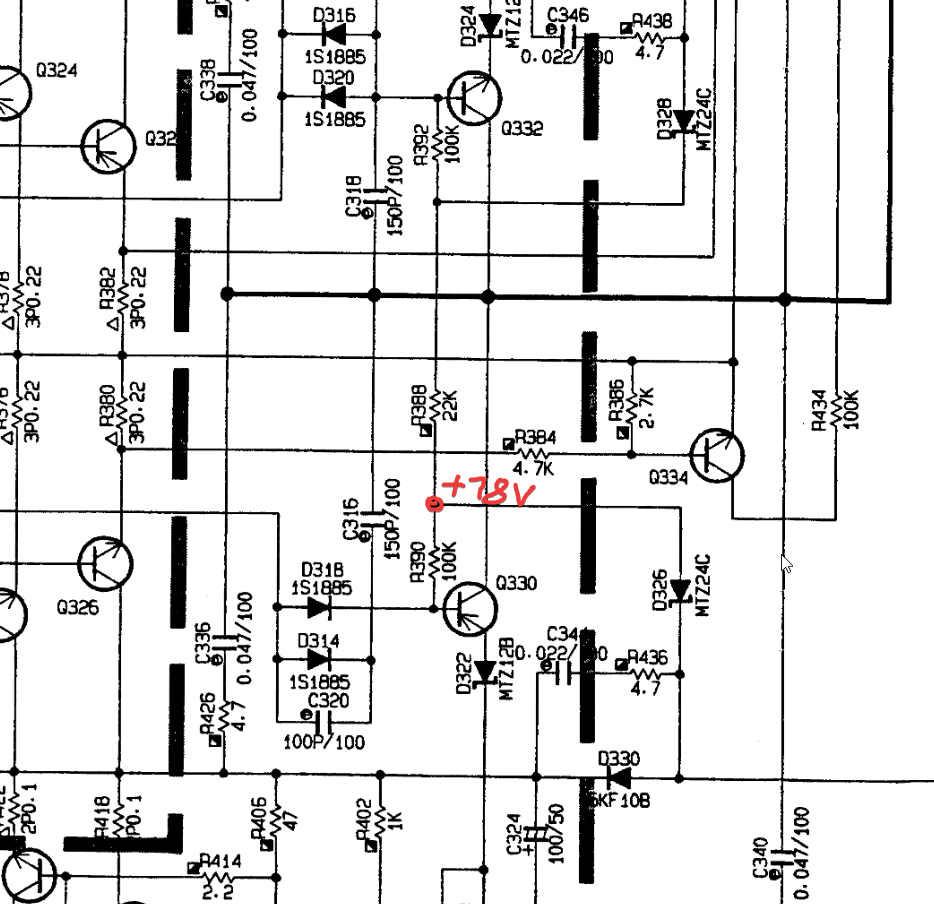

If shorting Q332 C-E does NOT cause the rail to drop to 40 volts, then (with the short still attached), measure the voltage at the junction of D324/R400/Q338-Base.
just tried your suggestion.
Shorting C-E of Q332 did indeed switch it to Low-rail. D324 and everything after gotta be alright.
something isnt driving the base, may have to look further into HB+ section of the APS.
the only part connecting them together is R388 (22k) which measures fine.
measured a few things again on both channels to compare.
drop across R388 is 32.6v, R387 is 32.9v
drop of R388 and R387 to GND is both 16V.
drop of D328 and D327 is both 23.9V
drop of R392 is 73V, R391 is 7.6V. both measure 100k as they should.
drop of R390 and R389 is both 7.9V

What do you see on the Emitter of Q332 to ground?drop of R392 is 73V, R391 is 7.6V.
Q332 Base to ground?
One side of R366 to ground?
Other side of R366 to ground?
Q332 base-ground -91v
Q332 emitter-ground -81V
(other side is -24.5 and -25V)
im confused as if C346 is leaky or something. gotta check that later
R366 both sides 0.6V

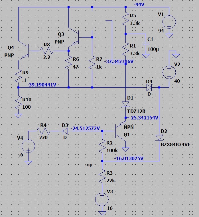

If is a rather confusing circuit. Pull Q338 and re-measure Q332 emitter/base.
with Q338 removed
i measure on Q332
Vbe 0.6V
Vce 41V
(g = ground)
Vgb -40V
Vge -41V
i measured the transistor (2SA1145) i just pulled, it was fine. replaced it temporarily with a 2SA1013 but didnt change anything.
measured R404, was also fine. 1k.
also checked if the silkscreen is wrong, but its all correct.
i noticed the 100k resistors R390 R392 and so on are not in the parts-list anywhere. but they measure 100k, all of them.
i measure on Q332
Vbe 0.6V
Vce 41V
(g = ground)
Vgb -40V
Vge -41V

you removed Q338, not Q332.
i measure (With all transistors in the circuit) -26V on the R392 D328 junction. which is werid, i once measured a 24v drop across D328 before but that doesnt add up to the stuff i measured here... gonna replace it, its just a zener.
edit: replaced all, all measured fine out-circuit but meh just give it new ones. no difference.
Yes, removed Q338 as I had you do in post #11. What do you measure at the junction of R388, R390, and D326? If there is no current through R388, the ener won't drop that full 24V.

With Q338 removed what is +18V? Do you mean the emitter of Q332 is -18V?with Q338 removed it is +18V.
other sides junction of R388, R392 D328 is -17V
Junction of R388, R392 D328 at -17V is OK.
