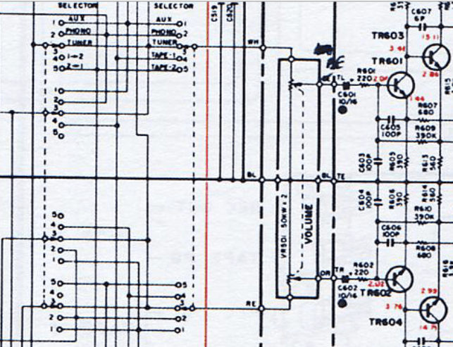

I've got a CR-820 which has a problem upon cold start-up - after the protection relay engages, the first 5 seconds of using the volume knob produces loud static noises. I need to wait a while to reproduce the issue, hence cold start-up only.
I have a feeling it's a capacitor - DC voltage on the pot would explain the noise, cap charge and discharge time would explain why the problem fades and then doesn't return until the amp is cold again.
Am I on the right track? Any tips on where to starting looking would be appreciated!

Yes, this is either a dirty pot or a leaky capacitor near it. If the problem goes away with warm-up,
it's more likely to be a leaky capacitor. First clean the pots with deoxit D5.

Capacitors that could be leaky: (The values are hard to read)
C650/C657 (2.2uF)
C709/C710 (4.7uF)

+1, also check C601/C602 could be the culprit.this is either a dirty pot or a leaky capacitor near it. If the problem goes away with warm-up,
Is the noise happening on all inputs or just the tuner?
Yes, in fact those capacitors are the most likely ones to replace,
if it is the volume knob rather than the loudness control that makes the noise.

Noise happens regardless of input selector position, and always on the volume control only.
