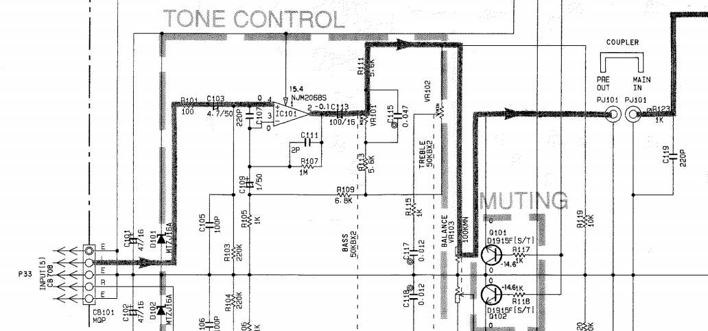

I have a Yamaha RX-V670 amp. It sounds well musically but has quite a hiss through the headphones in both channels but a bit louder in the right. It's the same no matter which input I select and doesn't respond to volume changes. That is with no audio signal and turning up the volume, no difference is heard with the hiss. I don't have speakers to hook up yet so I don't know if the problem exists there or not. Any ideas please?

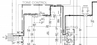

For a test, remove bridges COUPLER (PRE OUT / MAIN IN). Silence?
I think this whole volume / tone amp thingy has rather a lot of gain, rather more than 20 dB in normal operation. The power amp has a voltage gain of 27 dB, so it's not like you'd need more than 18 dB or so.
C109 (C110) = 1 µF is also a bit skimpy. Should be more like 10µ.
I don't really know what's up with the tone control - does it really have a bass boost "baked in"? Does it really use linear pots (the bias trimmers are also 'B', and I doubt these are anything but linear)? The noise results seem to indicate a bit more than 300 µV at the power amp output, so the spec seems to be about right.

The headphone output is fed via two 330 ohm 1 W dropper resistors in series, nothing high-tech about that. This could be upgraded by swapping these for a 3-5 W variety and adding maybe 33 ohms (1/2 W) in parallel to each output after them to form an L-pad. (These values can be varied depending on how sensitive and impedance-critical the used headphones are.)
Perhaps it would be best to bypass all of this mess altogether and attach a dedicated headphone amplifier to the tape loop instead.

I mean, it certainly wouldn't help if the likes of C109 or C103 (or even C113) had dried out and gone high impedance. This receiver is over 25 years old now. You could try soldering known-good caps of similar value in parallel once you get around to it.

The right-channel equivalents of the abovementioned capacitors would be C110, C104 and C114 (the first two being my foremost candidates in case of excessive noise). They all should be rather close together on the board anyway. Could also be just a bad solder joint on the opamp (NJM2068S in an oddball 9-pin SIP à la µPC4570HA - looks like this may have been the original SIP package, and then the later SIP-8 dropped the extra V+ connection at pin 1 but left all the rest, so if necessary, an NJM2068L would drop in if offset by 1 pin).
