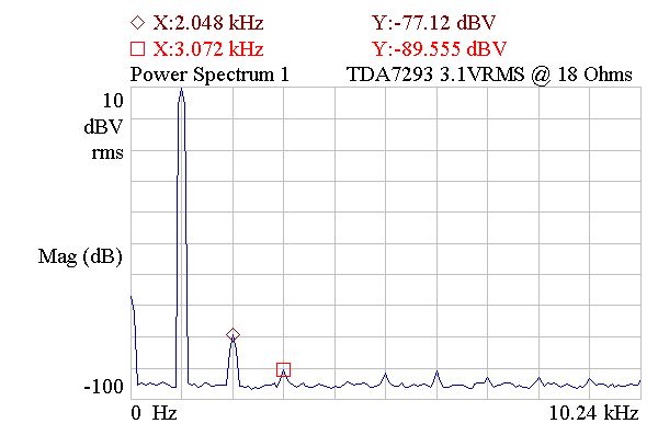

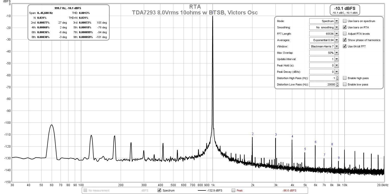

Here's 1kHz distortion at 1/2 the maximum level into the load I'll be using it at (driving electrostatic headphones). This setup measures very clean, all harmonics except the 2nd are basically in the analyzer noise floor. -87dB= ~0.004%. This is a better result than the LM3886 I'm also building. Impressive early results!
DC offset also very low, even with a 10k input pot and no servo...

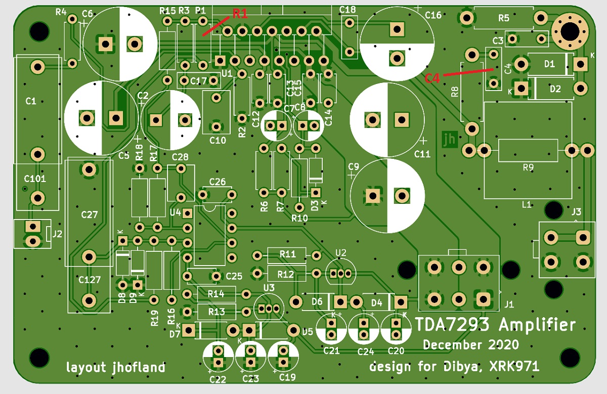

Hi Jbau,
Sorry you had some startup issues - I assume they are all resolved as you now have measurements? C4 is the Zobel cap and must be in place as you found out. Some switch mode PSU's do not like to see a large cap bank upon startup. There are exceptions - like the superb ones by Cresnet (Micro-Audio) they do not have any issues driving 40,000uF upon startup. Some of the silkscreen is unfortunately, obscured by vias. Most notably, R1 looks like "P1". Please let us know how the amp is working now. You will drive headphones with it? Wow, didn't know that was a possible use case even.

Your measurements look promising but limited by your audio interface I think. I measured -102dB distortion at 8Vrms into 10ohms:

Thanks xrk, my problems were both errors on my end. I misread the silkscreen and loaded C4 into C3 position - hence no Zobel. This chip needs the Zobel for stability.
My measurement system is 16-bit (HP 3565S) so it may not resolve -102dB harmonics. With averaging, the noise floor is about -105. Because I'm using a pot on the input, upsetting the impedance balance, I expect to give up some THD as a result. No way to avoid that, unfortunately. No worries - any amp with HD that measures near -90dBr is bound to sound pretty good - I think I can "suffer" with it! :)

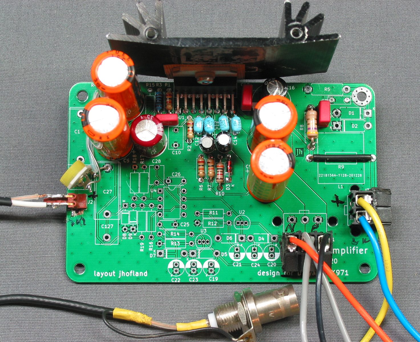

Can you post a pic of your built amp board?
Here it is, configured for testing. Once everything is finalized, the trim pot will be replaced by a panel mount one, the connectors will be removed, and all connections soldered to the board. No Molexes!
BTW, even this heat sink is about twice the size actually needed for my application...

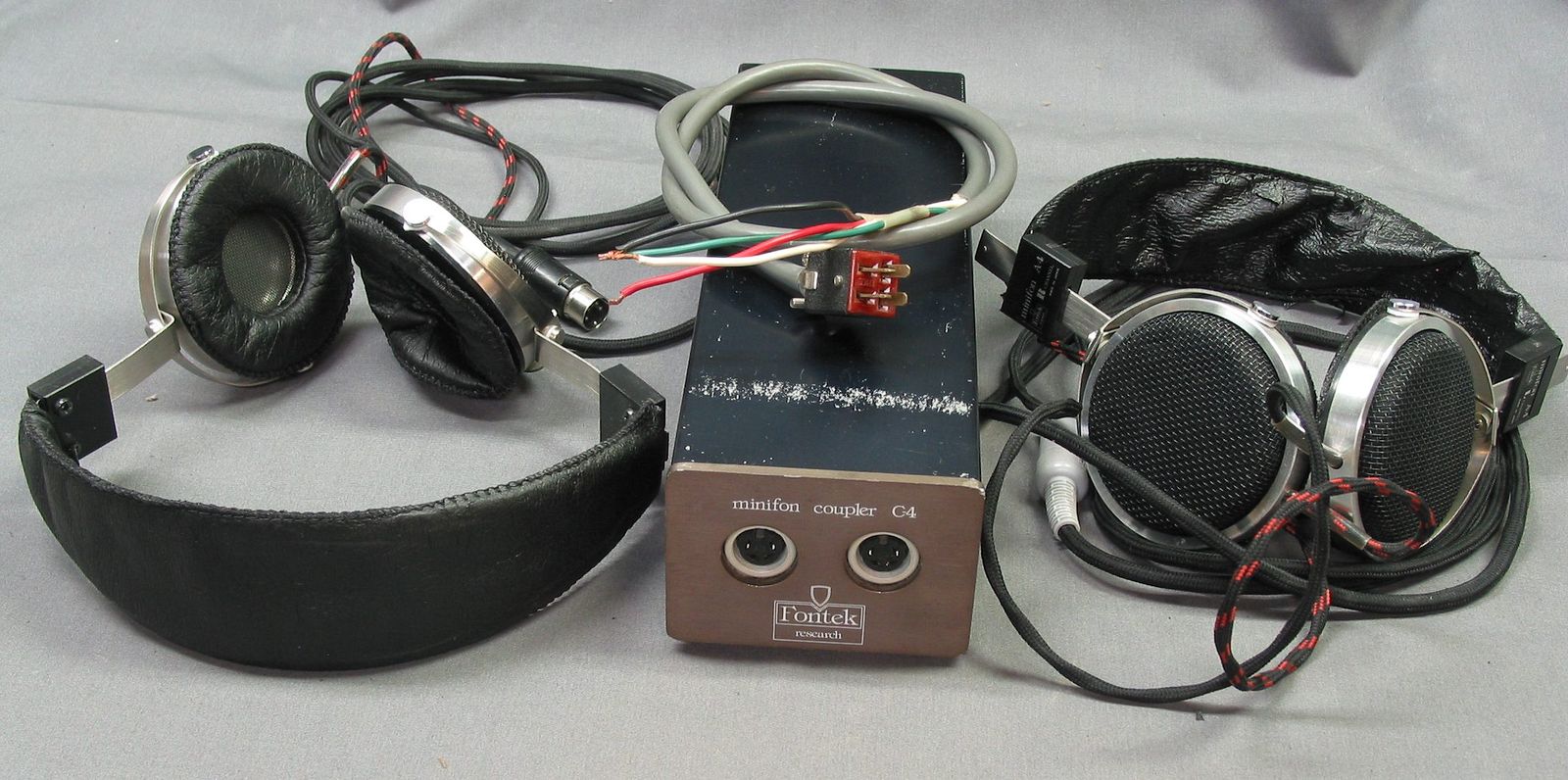

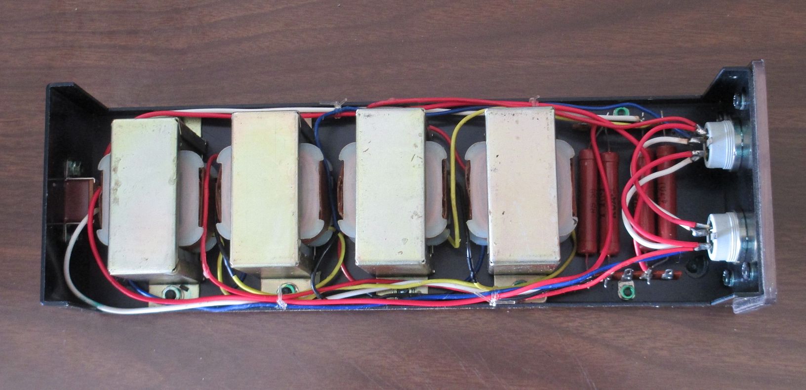

The coupler has a 4.7 Ohm series R internally. I played with different values and it makes a big impact on the sound. They want to be driven from a low impedance. I don't think I'll mess with a series R.

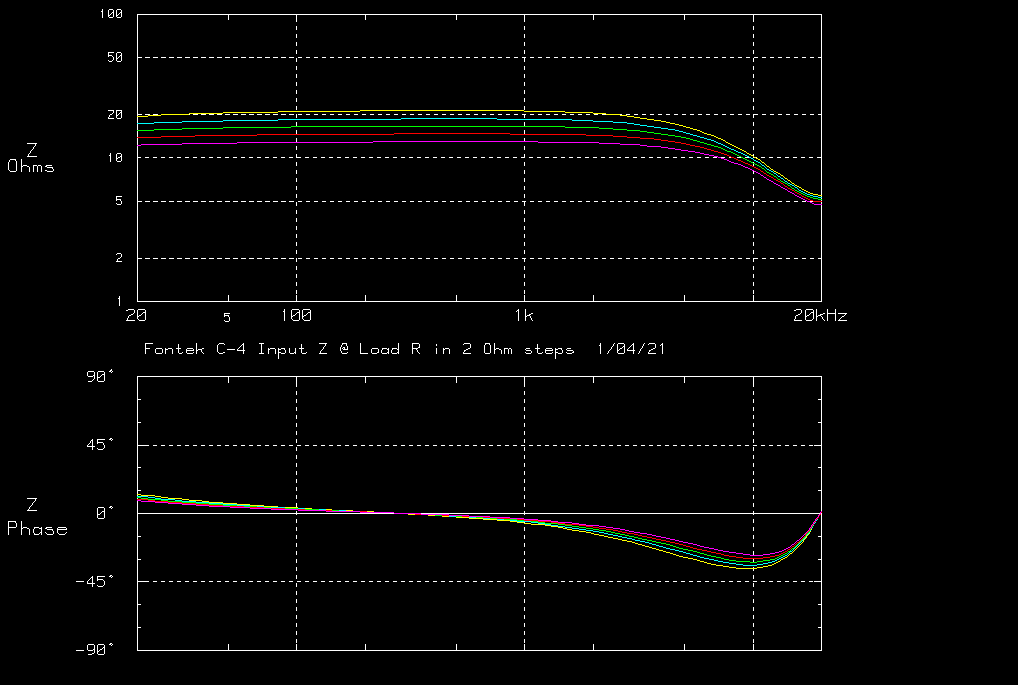

The last attachment is the input Z of the system, i.e. the load the amp will be driving. I was playing with various xfmr primary terminations. I'll be using the light blue curve, roughly 18.5 Ohms 20Hz - 5kHz.

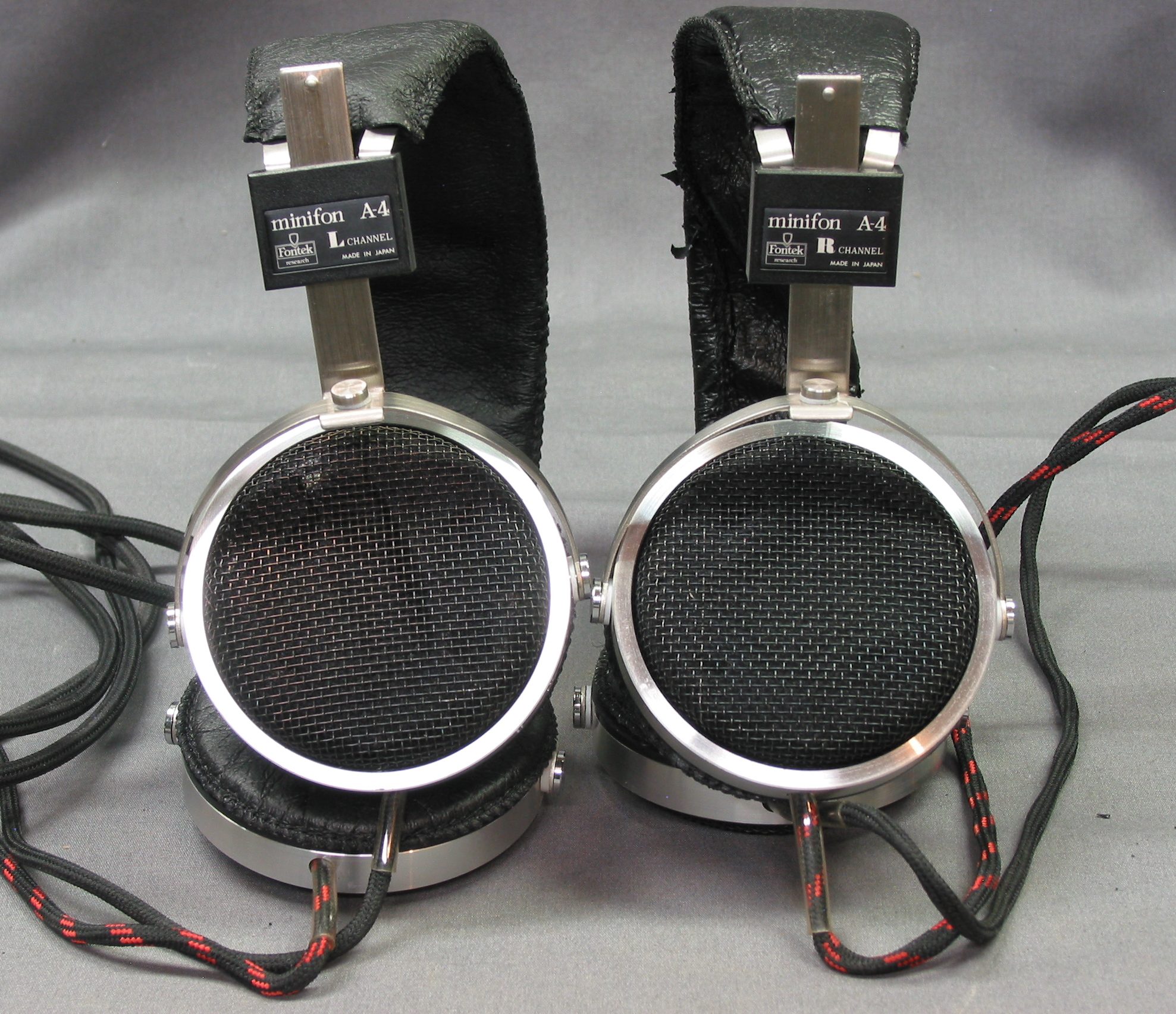

What headphone are you using btw?
Fontek electret electrostatics from the 1990's.

If you have 4.7ohms internally already that’s perfect. Don’t add anymore. Thanks for sharing the details. Do you know how many volts this outputs?
I often use microwave oven transformers as inductive loads for SE Class A amps. It doubles the voltage swing. I never use the secondary HV windings - they are left unconnected. They are designed to make 2500v from 120v. I wonder if I tapped into them I could get a nice transformer coupled Class A electrostatic headphone amp! They sure are quiet.
