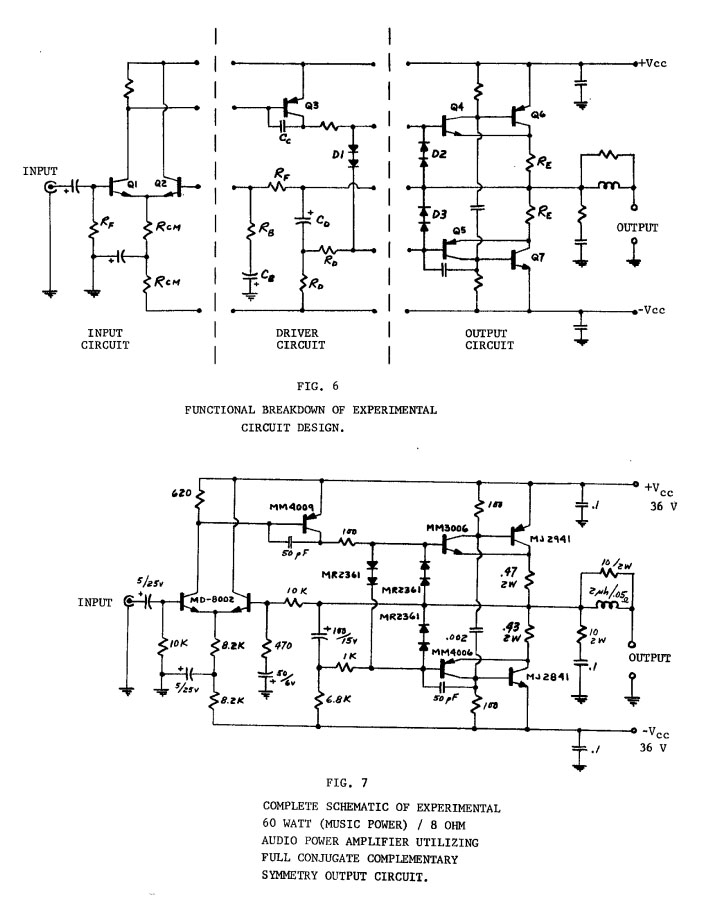

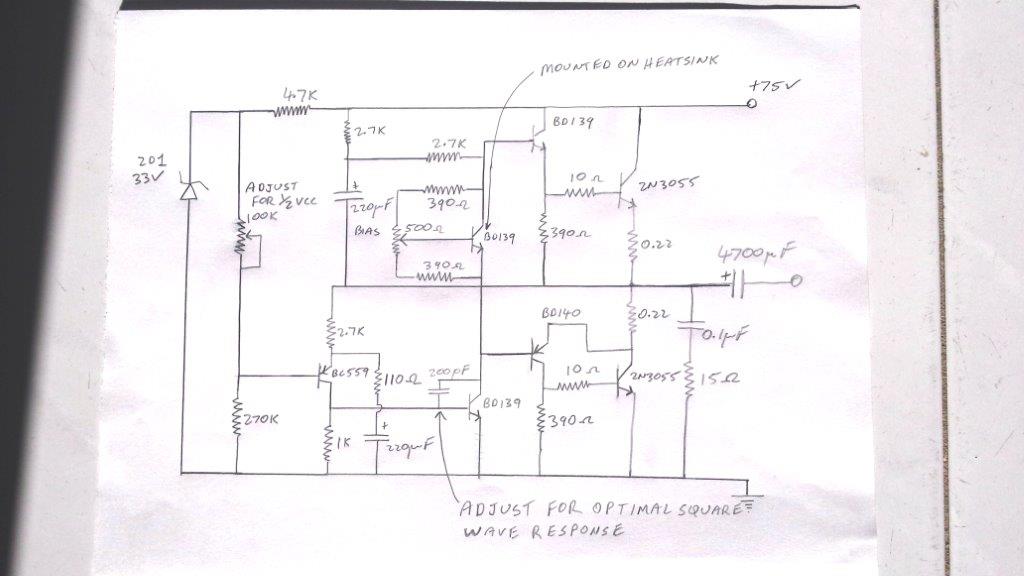

I see only 6 transistors, 1 TO92, 3 TO5, two TO3. Depending on whether the output transistors are npn+pnp or npn+npn, I'd take a standard schematic diagram and try to trace the differences. Here for example is the 1967 Haas Motorola 60W complimentary amp presented at AES.
By contrast the 60 W amp by bilbo has only a single input transistor, which looks like maybe what you have.
Main limiter to distortion on these very old amps are the slow output transistors. Four $3 MJ15015 quasi comp or pair MJ15015 and MJ15016 could pep the sound right up. Don't forget the 10 ohm base drive resistors shown on bilbo, they are required on modern fast output transistors to prevent oscillation, especially as the output transistors are remote from the board. I flew 1 W 10 ohm resistors in the air on the ST120, instead of the wires from the PCB.
