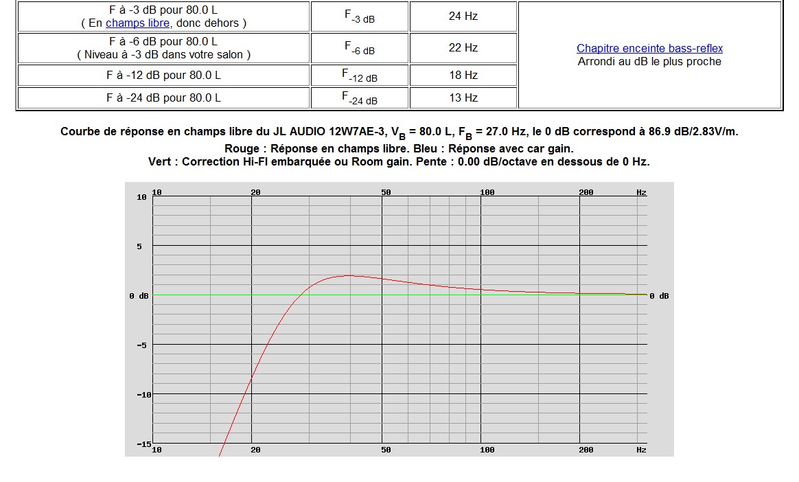

That's presuming it's a BR, a sealed type looks also great?! A sealed 100L looks good for home environment with a Qtc = 0.65 (sealed good from 65-200L).
Note: the Sealed Enclosure Specifications is good maybe only for car with only Volume (net int.) 1.375 cu ft / 38.94 L
Following your line of though, with easy build enclosures not mentioning horns/others, I looked at a good alignment from VB = 100.0 L, FB = 22 Hz what would be good maybe in open space/freefield with very low F3~19/21Hz (in room/freefield).
Again , jlaudio shows for ported Volume (net int.) 1.75 cu ft / 49.6 L, what might work in car not home (65-150L)
You need to have in mind that this is a subwoofer and you have to much of infra sound. A smaller box VB = 80.0 L, FB = 20Hz might work. 27Hz tunning (look below) makes a bigger lob @40Hz that might compensate rolloff, I don't know, without further measuring or simulating. Maybe you are using active equalization or other means of control that I'm not used to/or don't use. Please criticize this.
deebeez92, what (calculations/simulation) base do you have to say that. So I can follow you up...The enclosure will be tuned to roughly 27hz.
