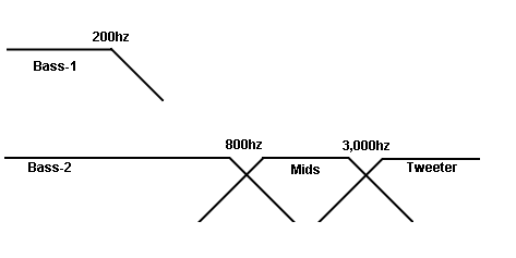

Well, it's a compromise, but your existing components might support a 375hz & 3000hz crossover. That is generally regarded as a very low crossover for a standard 3-way system. That is also pushing the upper limits of your midrange. It's not terrible at 3000hz, but lower would be better. Crossing over that low should leave the break up at 7khz well out of the circuit. If you are custom designing a crossover, then try to squeeze the Mid/High crossover a little lower. Still, everything is a compromise, we have to do the best we can with what we have.
Also, while I can say this can be done, I'm not able to say it should be done, there are many other factors to consider that are beyond my limited knowledge.
Now all you have to do is design the crossover and the box. Shouldn't be that hard (he said with a wry sarcastic smile).

I'm not really sure you understand what Tinitus is saying. I think he is saying you need to change your whole design approach, and skip the WW and just go with MMT. Or he is saying modify your existing design into what we might call a 3.5 system.
In your design, if you incorporate Tinitus's principles, you are simply adding a .5 to an existing 3-way system as seen in the attached diagram.
In my example/diagram, between 20hz and 200hz both Bass-1 and Bass-2 (WW) are in the circuit, but above 200hz Bass-1 starts to fade out and Bass-2 takes it the rest of the way to the normal 3-way crossover.
In a 2.5way system, as is commonly found in TMM systems, the 'M' stands for MidBass, not just Mid. Again, at low bass frequencies, both MidBass drivers are in the circuit, then one fades out, and the other MidBass carries the high-bass and mids up the the crossover point of the tweeter.
If you apply Tinitus's idea to your existing design, you are in a sense adding another component to the crossover system.
I think Tinitus, though he is free to correct me, is telling you to, in a sense, start over with a completely new design philosophy which will probably mean buying different speakers, which you don't seem to want to do.
Trying to crossover BOTH woofers at 200hz to the Mids, then crossing over from mid to high in the 3000hz range is less than ideal, but still possibly workable. You are getting down near the bottom end of your Mids workable range, and I would still recommend a minimum 375hz crossover bass/mid. Also, keep in mind that if you drop your low/mid crossover to 200hz, you can lower your mid/high crossover to 1600hz, but that's too low for your tweeter. But, I think it still might be functional in the 2000hz to 2500hz range.
Since you now have these odd and unusual crossover points, you will either have to design your own crossovers, or you will have to use two 2-way crossovers, assuming you can find them. One 2-way the crosses over at 200hz, and another 2-way that crosses over at 2500hz, feed the second with the High Out of the first.
But, every design is a compromise and every design is an experiment. So, try it, if you don't like it, you can always change it later.
Crossing over lower doesn't necessarily give you more bass. It only isolates the bass that is already there. I think that is the first flaw in your design.
Personally, in a straight 3-way system, I can see no point in crossing over below 500hz, but that's just me.
In short, I don't think you (or perhaps I) understand what Tinitus is getting at, and I don't think you are going to gain what you think you are going to gain by crossing over so low.
If you insist on using these speakers in at 3-way configuration, I would go with a straight 3-way 375/3000hz crossover. But using Tinitus's idea with your concept and your speakers doesn't necessarily help you. You still need a standard 3-way crossover for a WMTM confirmation, and an additional crossover component for the remaining W component to give you a W+WMTM configuration.

A bit confusion it seems 😕 but to me it seems that Rinx understood perfectly clear
1. I suggested to use active plateamp on woofers, with low xo point.... mids and tweeter in 2.5way configuration...not intended fore insane SPL
2. Rinx wants a somewhere in between with a 200hz xo point, with the mids in 2.5way...hence the shown filter is fore mids solely, woofers are still running straight in paralel
3. Bluewizzard, your suggestion may be fine, but you still have to consider that woofers are mounted on the sides, which may result in strange and problematic phase behaviour, especially with higher xo point
BTW...I dont suggest other drivers and if it wasnt the case that Rinx already had these drivers, I wouldnt suggest anything other than to build a wellknown and proven design
OK, now I've got it.
Yes, I certainly was confused. But Tinitus's new explanation makes it clear. If that is Rinx understanding then we are perhaps on the right track.
Still for the mids, a 200hz crossover is pushing it. That strikes me as the absolute limit on the low end. If he wants to try that, no problem, if it doesn't work out he can always try something else. Or, am I again misunderstanding?
Thanks for the clarification.
Steve/bluewizard
