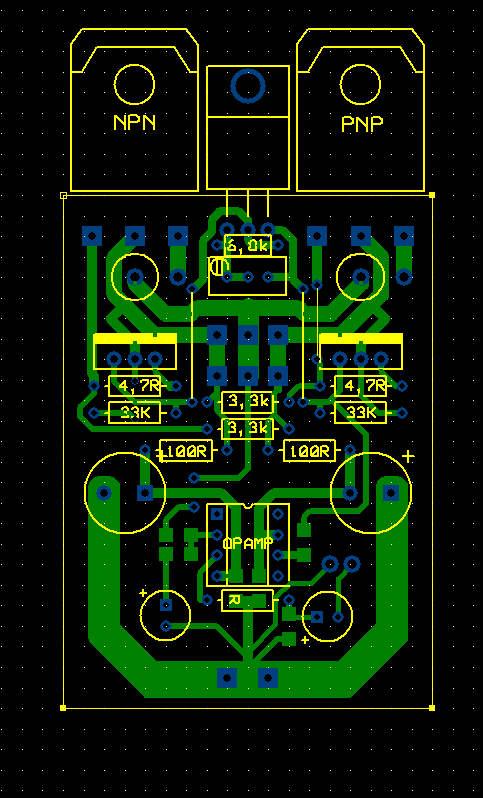

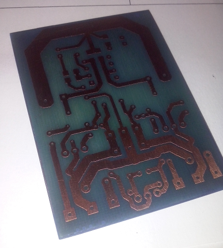

That is a quite efficient and good sounding class AB amp indeed.
It can be made very small. I even have PCB designs that could fit your needs.
Got lots of measurements of THD IMD and so on. But i have to find them first.

45x63mm
Its quite large compared to LM4781 but has better perfomance and is well balanced.

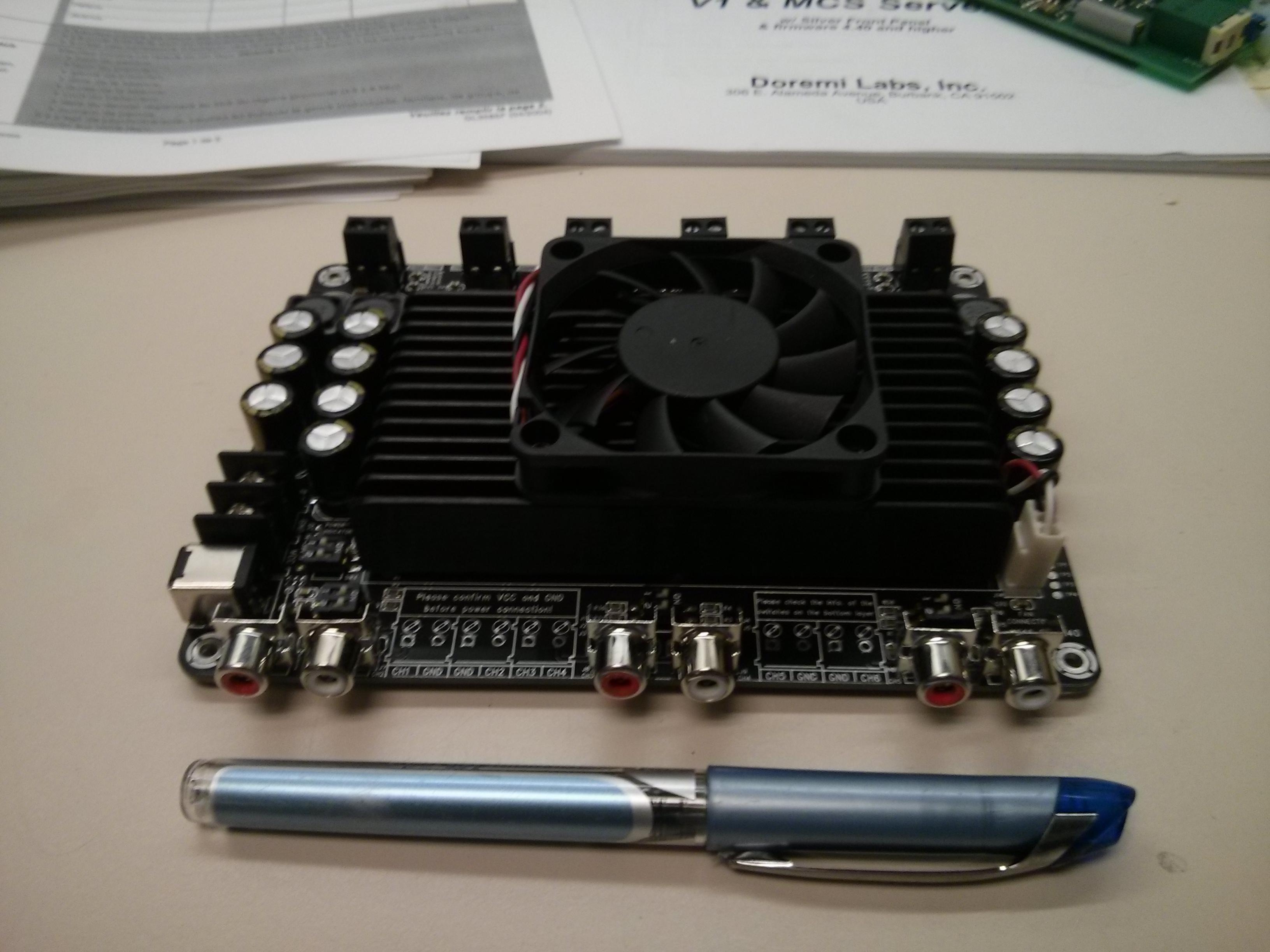

Hi all,
I've found this 6 channels class D TDA-7498 (320-307 at parts express) for $60. It would cost me at leist double to build a thing like that...
All it needs is heat sink and power supply which I have lying around in numbers...
RCAs are on it as well as terminals for power...Can't really beat this !
Anyone have experience with TDA7498?
I will probably go with that. I don't care much with sound quality (this is my TV setup, not my hi-fi one...) but I don't want background noise. I know there is a fan always on on this board, I will find a way to "muff" it. I plan to leave it on at all time.
As I don't use subwoofer, I'll have plenty of power with it I think.
Opinions?

Here it is. I just need to add a DC power supply to it...
I'll see what I can get. Reading the comments on this amp (on parts Express) it looks like I won't need to add heathsink, even I may be able to remove the fan covering it... I think I'll build a PS with tranny & capacitors, separate it from this amp in the box. I'll get the RCAs out on a panel side and I'll wire Banana female on the facing panel side.
I should not forget about the fan and give some airways to it... I usually tend to leave the things I buy like they are... too many crashes after "customizing" equuipments... "OHH that is why they did put that...".
I've just thought I may use a PC power supply... Switching 19.5 Volts 6.5 amps. Don't know about damping. I'll try it and compare.. It sure could do as for voltage & current I need. For now I'll only use 3 channels and I, by far, won't need 100 watts per channel...
Go for it, it will work just fine if the voltage is in range. I doubt you will have any issues with sound quality in HT environment.
It's just as well you didn't build the 4781 with that PCB. I got my first board done yesterday and need to fix a show-stopper before it can be put into active service duty.
