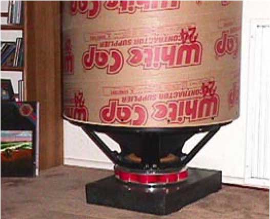

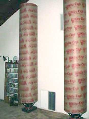

Or you could use the speaker as the foot... like Nelson did with el-pipe-o (21" woofers in a 24" sonotube....
