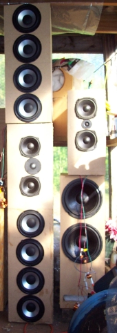

My journey to find an HT system that can play Classical to Heavy Metal took a different route. I was struggling to find a bass unit to go with my MTM's that could acheive what I wanted. As you can see in this pic I went through quite a bit of test boxes.

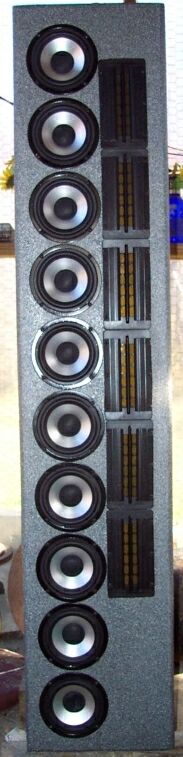

I was seriously considering a line for a while until I priced what all the drivers would cost me 🙁 Just can't quite afford 'em to get the line height I would need in my current living room that has 13 ft ceilings. To get that minimum magic of 70% height would have taken me minumum of 22 5" drivers per side. Maybe on down the road I will attempt such a thing.
BTW, that is a beautiful line you have. Maybe in a couple of years I'll have as many test boxes as you.... 🙂
