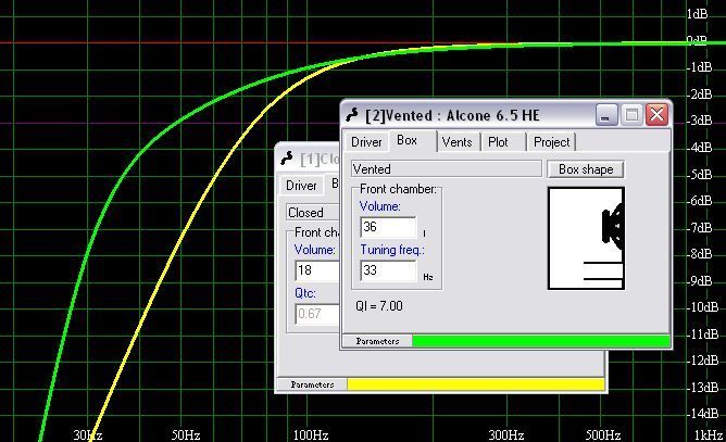

Shown is a typical current 6.5" unit actually designed for vented
loading in a sealed cabinet versus a larger vented cabinet :

For the vented box most of the extra work is done by the port in
the low bass region and output is equivalent to 4 sealed drivers.
