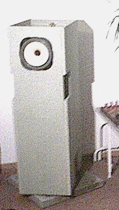

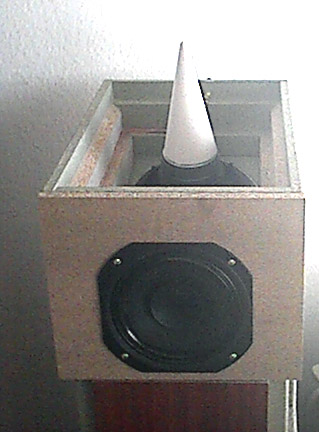

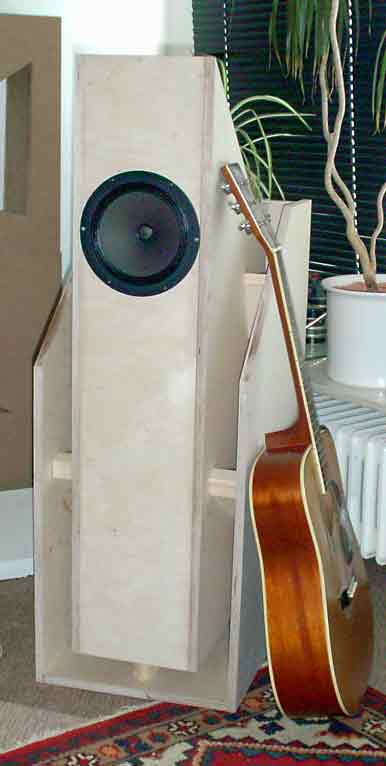

Hello,
don´t you find my HP?
take view of my SAXOPHON and
the RDH20, they would be a solution for the Fe206esr,
because of the depth may be with an extra baffle
of 25 mm.
audioray,
do you test your ears?
imho you don´t need any tweeter, fostex has enough HT
specially in your age, make measurements, 5µF seems
to much if you dont cancle the Fostex at ~3kHz

Hi, thanks for sharing the pictures, very interesting designs. I will try out the super tweeter with the fe206esr, if I feel they are not needed then I will remove them, I agree with the cap value being high.
