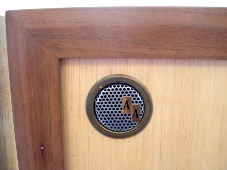

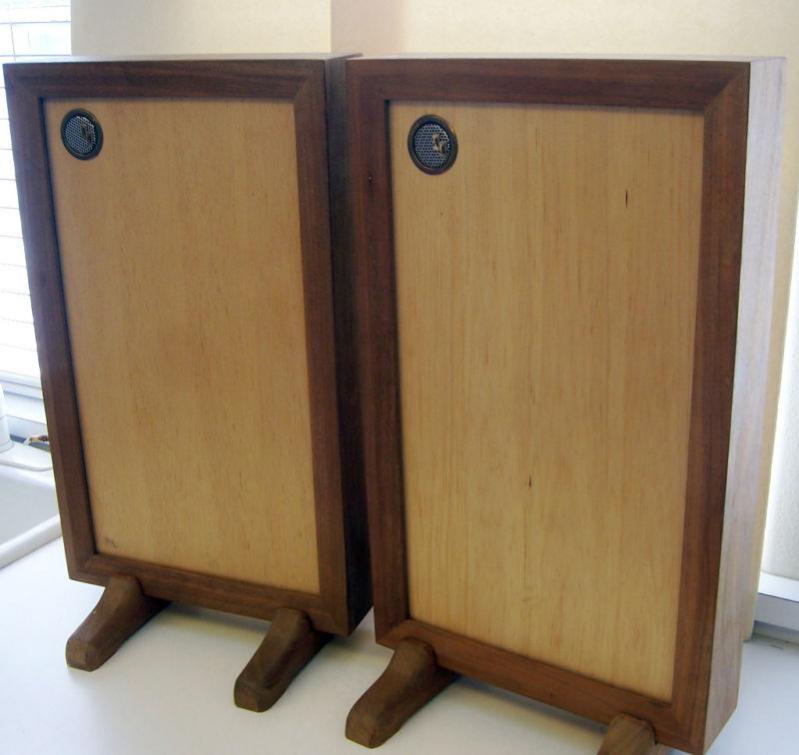

Anyone ever attempted to reproduce this form of speaker? Apparently it's a wood panel piston-ic action driver with a helper tweeter. Produced by a company called Advanced Acoustics. It was termed a bi-phonic coupler.

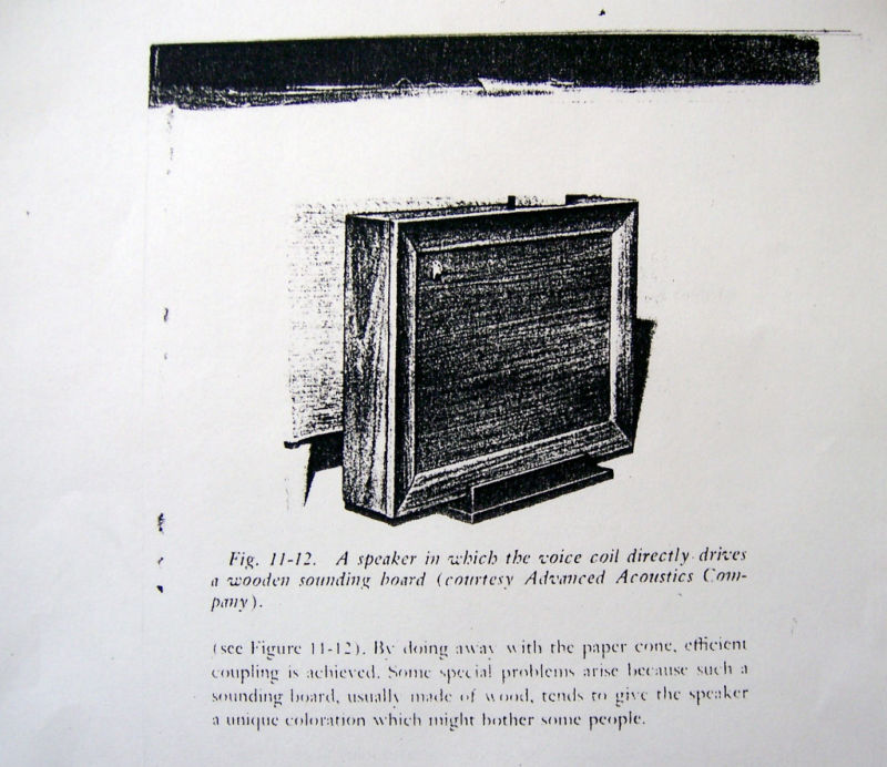

In the March 1962 issue of Audio..Page 60 "New Products" I found a short description and picture.
But I am intrigued about how this puppy works exactly. Any ideas? The fact this seems to work at all is amazing to me and with all that old 60s and 70s rec room paneling out there in suburbia screaming to be torn out and re-purposed, the raw cone material (if I can call it that) for this type of implementation seems readily available...knotty-pine, pecan, ranch-style etc etc. Gives the term "wall o' sound" a new dimension, doesn't it?😉

Both the front panel and rear panel flexed by virtue of the voice coil being fixed to the front and the magnet to the back panel.Hence, in the descriptive title of 'Bi Phonic Coupler".The only reason I can think of why it did not become popular was it needed bass boosting to equalise the falling L.F. response caused by the lack of compliance caused by the very small internal volume.This needed care to achieve good results and it may have been difficult with contemporary amplifiers.I believe it was designed by an American audio pioneer,Abraham B.Cohen.

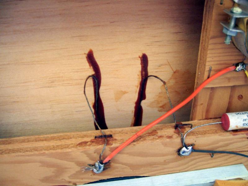

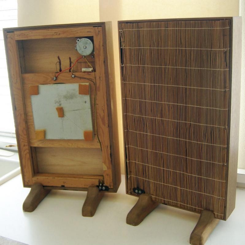

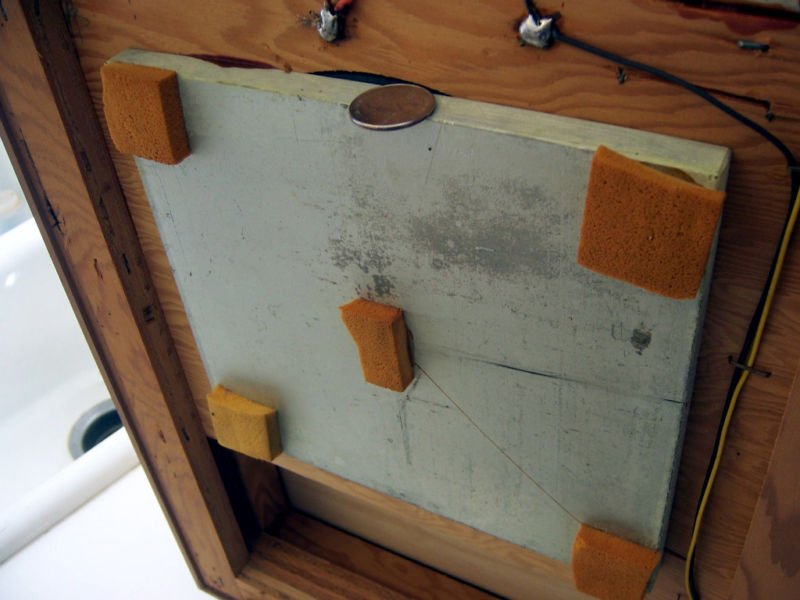

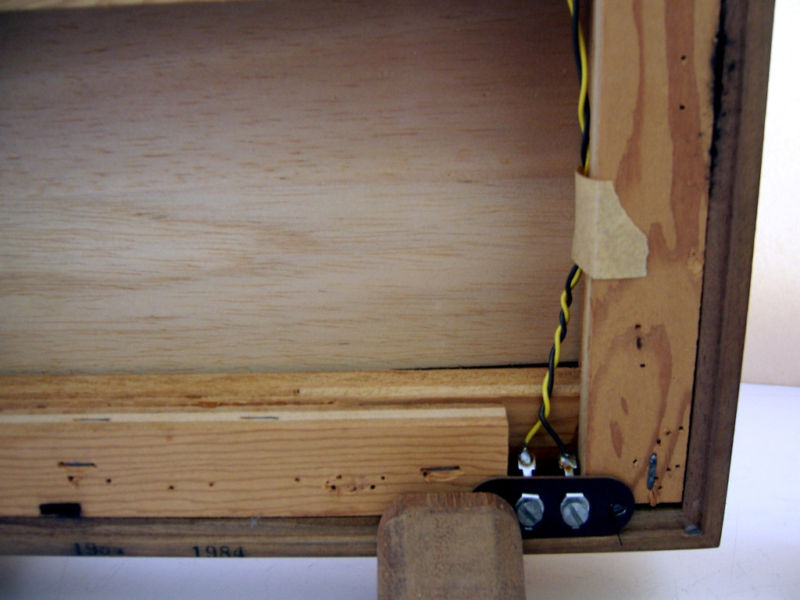

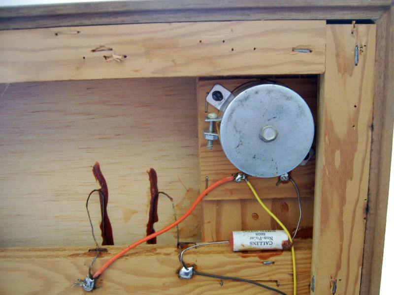

Finally some detailed pics on these
Lifted these pics from E-Prey...that give us a much better glimpse in to what was going on inside these wood panel Bi-Phonic speakers...😀😀😀
Wood(sic) love to see what's going on under neath that rectangular cake pan!
I'm still thinking conventional motor stuck to a board...
IMO nope!...otherwise why the need for the baking pan cover? And it looks as if there are some kind of leads affixed directly to the front panel.
I have the feeling that once put together,the means of re-opening would have been a mystery.In the pictures presented so far,it seems that the original rear panel has been pried away if the black strips(rubber or felt) were what held it in position.The leads to the front panel are the voice coil leads and I would think the magnet is compliantly mounted in the sub-frame in such away that it can be aligned with the v.c. but be reasonably free to to move back and forth.A mechanical crossover system is suggested by the 5 foam pads that are spaced on the magnet rear surface and these would have driven the original rear panel.The bamboo 'thing' appears to be a ring in.
