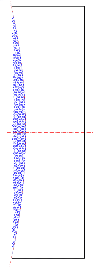

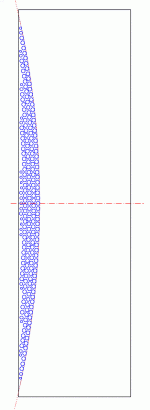

I am not equipped to make a proper curved back, so I'm going with a straight cut on the back of the speaker. Here I've just clamped it together, nothing is glued, so I can get a realistic size evaluation. They aren't small. I'd say they are comparable in size to a Martin Logan SL3.

Like the FH series they will be compromised without the curved back (which is a functional part of the design -I didn't put it in for jollies / to look pretty ). If you can't do it any other way, mark it out with ruler & pensil, roughly cut to ~'close' to the outer edge of the line with a jigsaw or similar & shave with a plane to reach the target curve. It's worth it.

I'm just not setup to make a clean cut with a jig-saw on a curve right now. I understand not having the curve may have an impact, but for now I'm working with the tools I have. I may look at improving my curve cutting ability on v2.0.
That's why I suggested 'roughly cut to ~'close' to the outer edge of the line with a jigsaw or similar & shave with a plane to reach the target curve' -you wouldn't have to make a clean cut with a jigsaw -just cut it as close & neat as possible to the target and then use a plane (or a spokeshave) for the finishing work, as they did in ye olde days. Once you have one, you've effectively got a template, so the others should be quicker & easier to refine. That said, I'm no woodworking expert. On the other hand, for the sake of a couple of extra hours work with a plane, it seems a shame not to.
