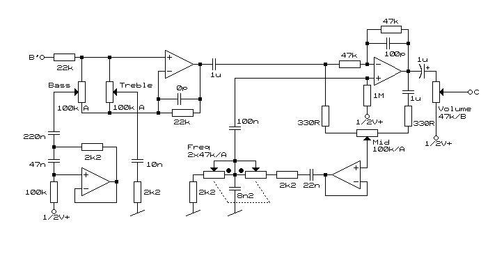

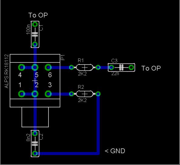

K kendarmstat Member Joined 2011 2011-08-24 4:53 pm #1 2011-08-24 4:53 pm #1 Does anyone have a schematic or wiring diagram for the dual gang pot in this circuit? Attachments 61876921.jpg 25.5 KB · Views: 146 C CJ900RR Member Joined 2006 2011-08-25 11:17 am #2 2011-08-25 11:17 am #2 Hi, I would have done it like this, considering the two "dots" in the center of the pot on your image. Note, the image is as if you are looking at the pot from the top... Attachments pot.JPG 28 KB · Views: 143 K kendarmstat Member Joined 2011 2011-08-25 1:39 pm #3 2011-08-25 1:39 pm #3 I will give it a try. Status Not open for further replies. Share: Facebook X (Twitter) LinkedIn Reddit Pinterest Tumblr WhatsApp Email Link
