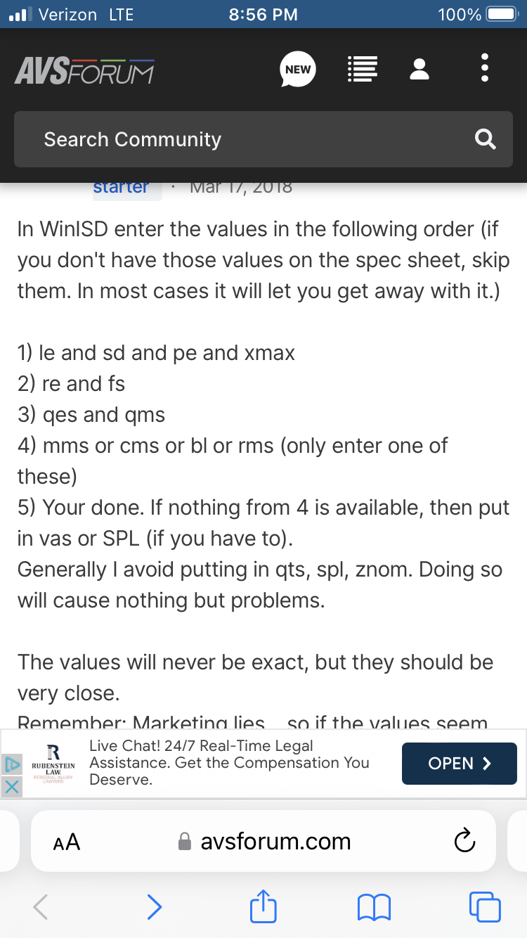

No idea why someone would think this is important. What is important is letting the software auto calculate some of the values.I’m not sure why but apparently it’s important to input the drivers t/s parameters in this specific sequence.

WinISD calculates some parameters as data is entered. If the data is entered in the wrong order it's sanity checks can fail. The ones it calculates may be slightly different to the ones on the drivers data sheet. Actually the version I used states this in it's help file and suggests a data entry order, There are a couple of tutorials around that do as well. The one I used was this one
https://midwestaudio.club/?page_id=14662

Pretty much the problem I was having is I didn't realize that changing your number of drivers only influenced the m/s tables. Then you have to adjust port size and number manually to get m/s where you want them
