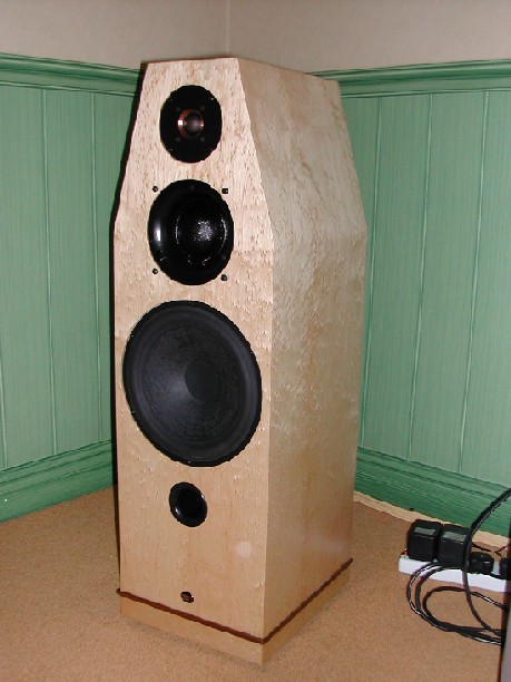

Just in case anyone is interested, after a demo I went and bought the Wilmslow Forte kit.
Cabinets are assembled, crossovers wired but I'm waiting on a friend who is a furniture maker who is veneering them in lovely bird's eye maple for me.
The kit's cost so much it seemed to me they deserved a very nice finish to make them look the part as well as sounding good.
Should be done for me shortly and I can't wait ot listen to them!
Bertie

Here is a picture of my new babies, well I'm very proud of them!

The Drivers are actualy Seas Excel tweeter, ATC dome mid and Scan Speak woofer. Good work identifying two of them. To quote from the kit spec....
"The key to this extraordinary open and natural sound is undoubtedly the Seas Millennium tweeter, a more, clear and detailed treble would be hard to find and it's compatibility with the ATC SM75-150 is nothing short of remarkable. With a smooth mid/treble transition which is seldom bettered, combined with the Scan-speak 25w8565-01 carbon paper bass unit, producing clear, accurate and precise bass at all listening levels, the Forté is definitely a hard act to follow."
Treble: Seas T25CF-002 Millennium
Midrange: ATC SM75-150
Bass: Scan-speak 25w8565-01
The crossover uses SCR caps in the bass / mid and Hovland Musicaps in the tweeter sections.
They're the best thing I've ever heard, and I've listened to a few expensive commercial speakers, glad you like them.
