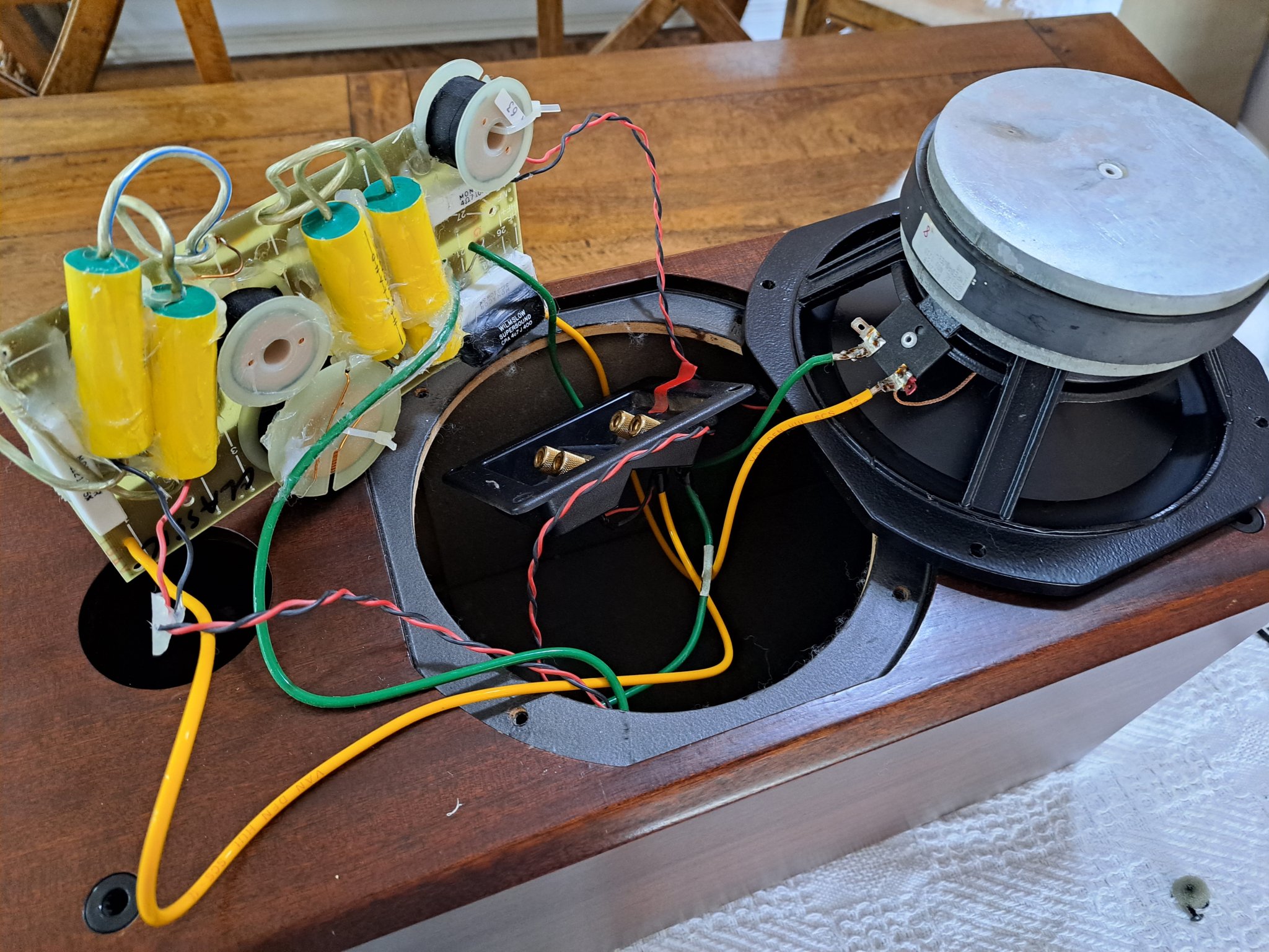

I pulled them apart to investigate…
So what do we have…
The boxes are very presentable, nicely veneered and absolutely solid. A quick calc of the port tuning suggests they are tuned to around 34Hz. The Volt literature claims it works in volumes from 20 to 50l, so should be no problems there. I'll point out at this stage that I paid about the same for the speakers as Wilmslow add to the SM108 kit price for an mdf flatpack…
First thing I noticed is that there’s a sheet of white acoustic stuffing wadded up behind the bass driver and the port. Not right intuitively, and not where the Wilmslow instructions tell you to put it. Yes, I got the original build instructions and invoice with it (£759 for the kit in 1999). Pulling that out added some bass but obviously does nothing for the crossover region.

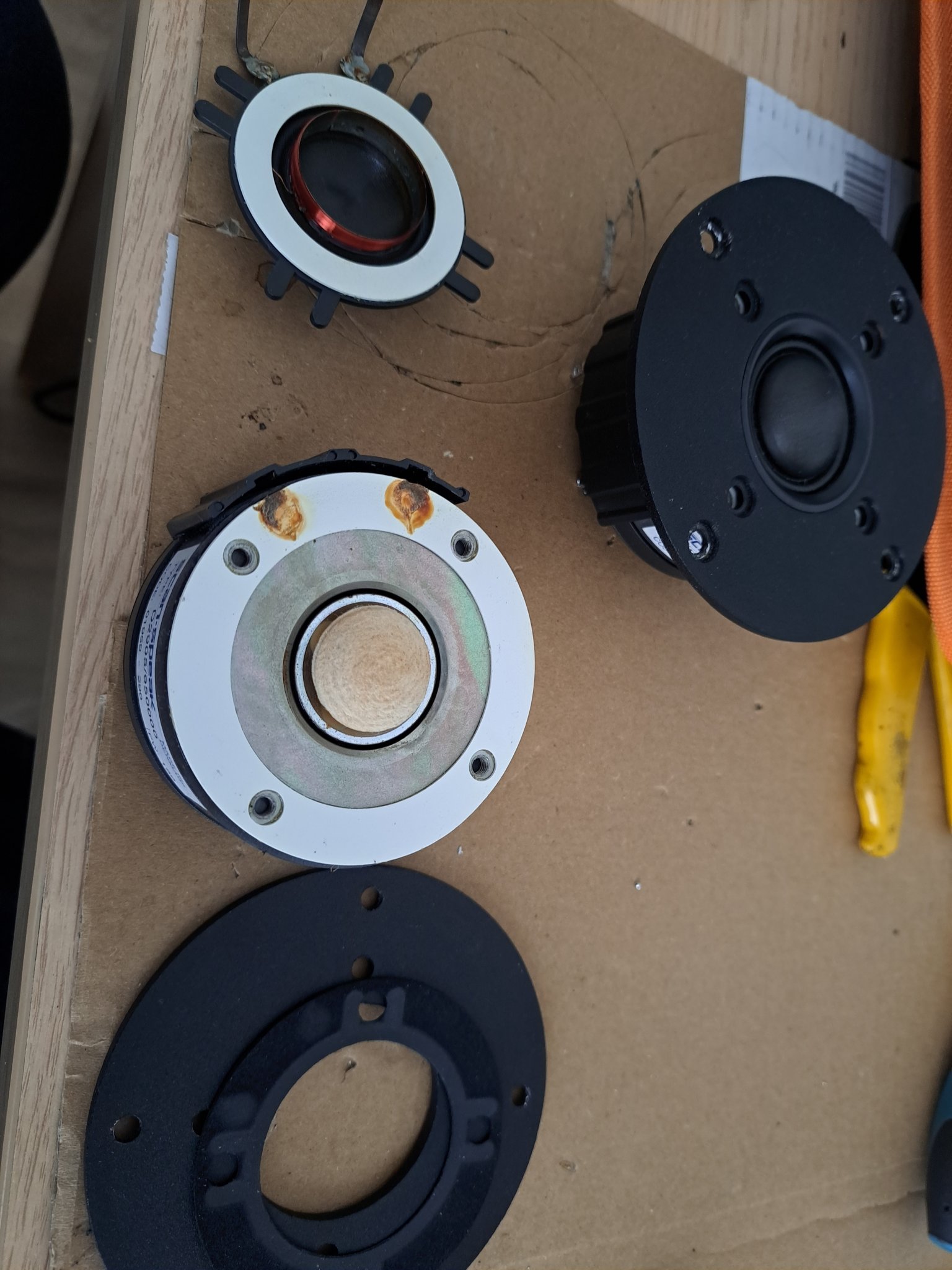

Drivers are in visually good condition. All four are working. I can only assume the Volts are good as new. If weight is anything to go by, they are serious items at about 3.5kg each. The tweeters looked fine but a clean out revealed slightly damp and dirty coil gaps and no actual ferrofluid… Gave them a good clean out and popped in some new fluid I happened to have left over from the Mirage build.
Internal wiring is interesting. Van Den Hul (CS16?) on the LF circuit. Thinnest unmarked wire on the HF. I’m sure it was done for a reason, but no idea what it was!
Which leaves me with what should be correctly working drivers in each speaker and the crossovers…

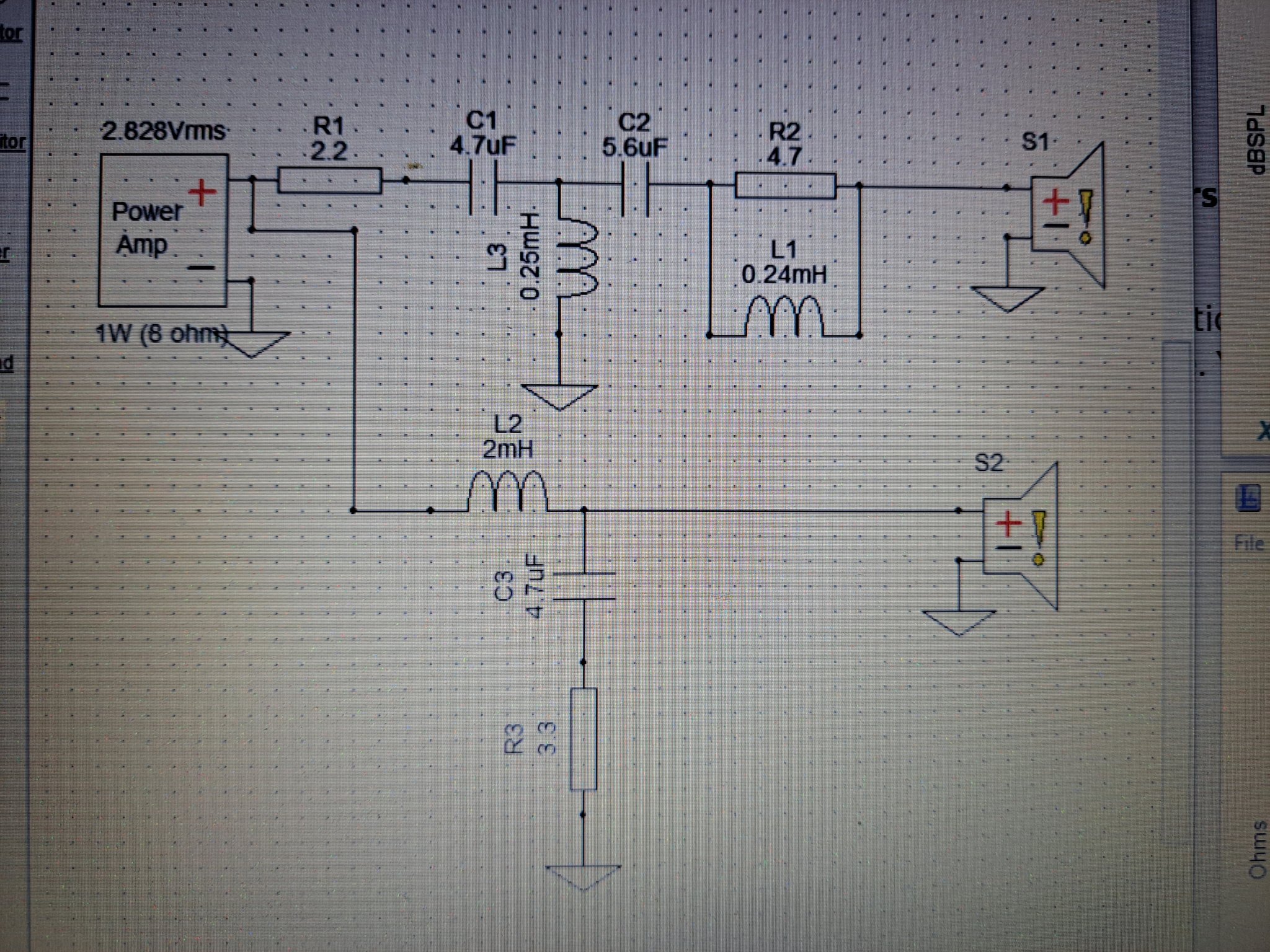

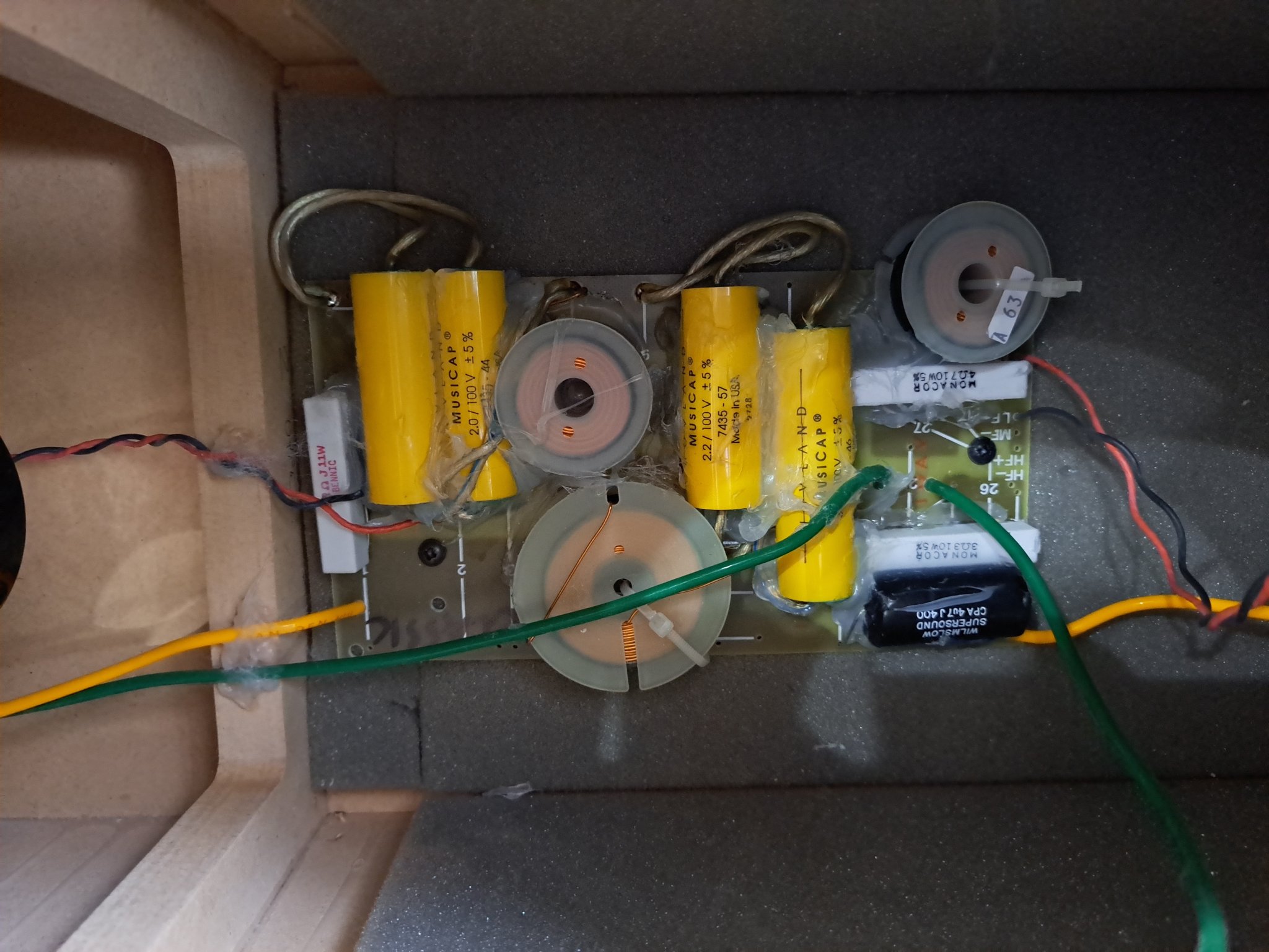

Ah, the crossovers. These were, in theory at least, supplied from Wilmslow ready-built and with a “Hovland Musicap” upgrade. They contain these expensive film caps and air cored inductors on a circuit board. I’ve chased it through, measured values where possible and mapped out the circuit. It didn’t really make sense to me. I’ve been attempting to get Wilmslow to send me a circuit diagram, or at least confirm that what I had is what they intended, but I’m getting no joy… A) “they’ve been archived” (lost?) and B) “we don’t give out circuit diagrams willy-nilly”. I’ve sent my layout of the circuit to them for checking, but I’m not holding my breath.Their customer service technique appears to be ignore you and hope you go away.
I modelled the crossover in X-SIM (shown). The tweeter circuit had an inductor and resistor in parallel, both in series with the tweeter. This after a third order high-pass, so what LF the inductor had left to pass through, and why you’d want to, I don’t know.
In the absence of any info, and with dissatisfaction in the way they sounded, I assumed they were wrong and that the inductor should be across the tweeter to earth to complete a 4th order filter. Doing this in X-Sim drops the output in the 3-5kHz region without affecting much else, so I got the soldering iron out and moved the inductor output to the earth line to try it.
Bingo! Sibilance all but disappeared and they now sound nicely balanced; still detailed, but much smoother without the harshness that was there before. Still no idea if this is what Wilmslow intended, or how they measure, but they sound perfect to my ears, so they’re staying that way. Next step is to reassemble them with the crossovers back inside, clean up the wiring etc. and get on with enjoying the music.

Reading your old post again, sounds like the Kord had problems in the crossover as well...
The 2mH inductor rolls the Volt off from low... maybe below 1kHz... it seems the design uses the sharp mechanical roll off of the driver at 3kHz at the crossover frequency, which seems to be up near there. Unfortunately, I suspect the low roll off sucks the midrange out. At one point I was running the tweeters through the (original) crossover and running the Volts full range... it sounded better to me. I'll have a play at reducing the roll off in the LF circuit in X-Sim and see what happens.

Hmmm... A 2 way involves a lot of compromises particularly in the crossover region. It is going to be nigh on impossible to do a reasonable job particularly w.r.t. to identifying issues and sorting out the crossover without basing one's decisions on reliable information such as that provided by measurement.
I had a bit of a brainwave this morning. In the absence of the ability to measure the speakers, I can add some EQ until they sound good, and work out what's wrong in the frequency response.
Connected an android tablet as source, then played with the EQ in Spotify's internal equaliser. After much fiddling the problem is simple... reducing everything above 4k by 4dB (and 2k by 2dB) sorts them out. Found some old 22k resistors and fitted them in parallel with the tweeters (and removed the strange inductors) which (according to XSim) should drop the tweeters by about 2dB and immediately they are much more listenable if still a bit bright.

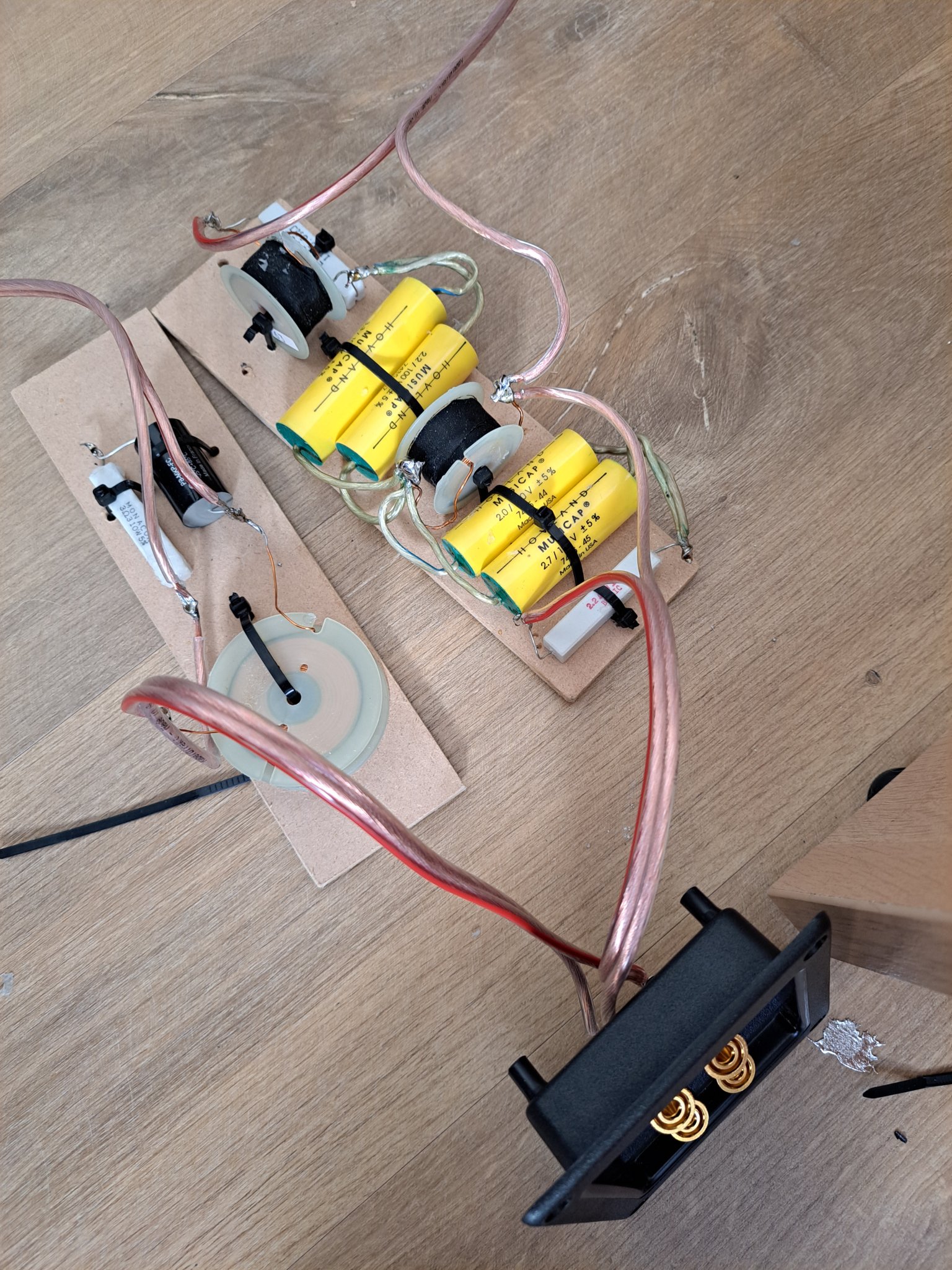

After playing a bit, I deconstructed the old Wilmslow crossovers and used the bits with one new cap in the LF circuit and some different resistors to build my own. Point to point wiring, inductors all at right angles, completely separate boards for LF and HF, and fitted them in the bottom of the cabinets away from the drivers.
I've settled on a circuit with the odd series inductors removed from the HF (still there in the pic, no longer connected), tweeters reversed polarity and padded down about 3dB which sounded right to me.
