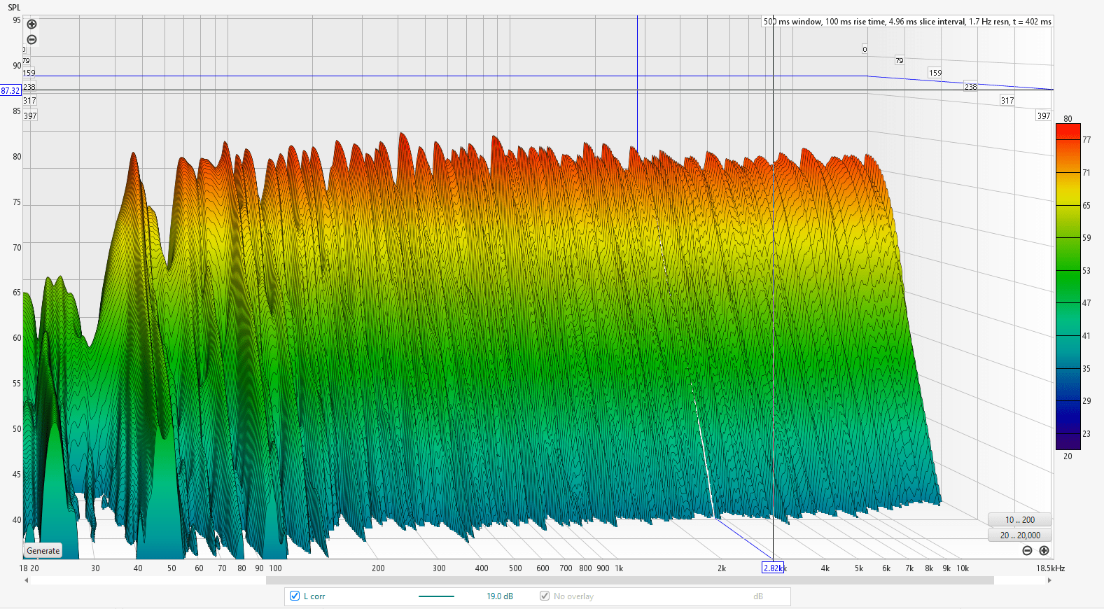

I'm not really getting the point about substituting the PRs with activate woofers. 1 PR is €28 which is quite cheap I think? Also I cannot find a (suitable/acceptable) 8 inch woofer which is cheaper than this, plus I'll have to do a crossover (which I've never done before) and will need to buy crossover components which will also add to the cost. That does not mean that I don't think you're right with that idea, 2 active woofers with a crossover is definitely better, but also more complicated.
Nothing but tons of smeared stored energy from that design…..a combination of internal reflections, resonances, etc
If you want to do a wide band driver design, the ‘simplicity’ of it can’t boil down to a driver in a box……the delicacy of the light weight thin cone that ALLOWS these drivers to play over such a wide frequency must be respected.
