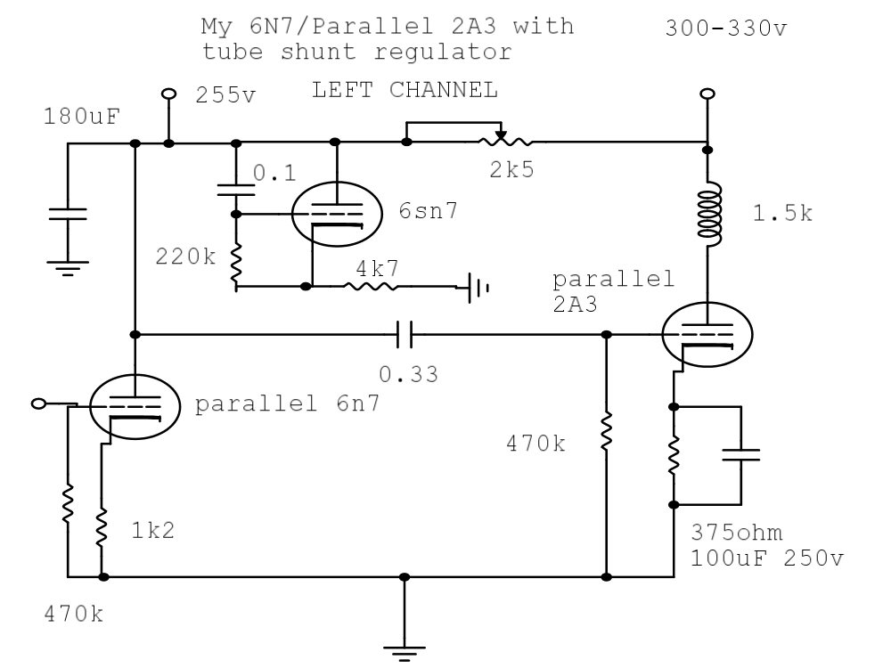

I was hoping someone could give me a value for this.I was thinking somewhere between 22k and 47k.

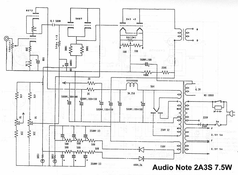

If you like to get higher power output, I would suggest you go for the 300B instead running the 2A3 in parallel.
There are lot's of famous PSE schematics like Audio Notes around that you could use.
Johnny
Johnny
It is much more complicated to drive the parallet 2A3. Also, the OPT is harder to get.
You're absolutely right. And it doesn't sound that good. I would never understand why not use a more powerful tube or even go for PP if power is important.
