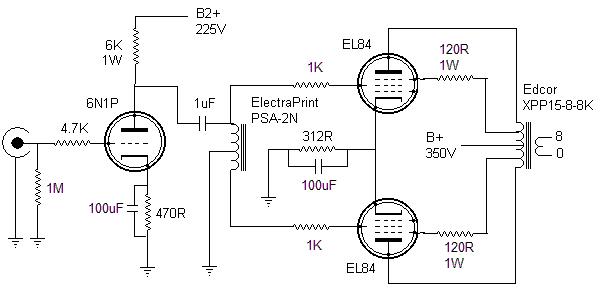

I have two amps with transformer phase splitters, my recent 6S4S PP amp with LL1660S ITs and an older junkbox build with triode wired PL81s as output tubes and Edcor XSM10k interstage transformers. The XSMs are actually used as autoformers as (as in the EL84 schematic above) after a mishap where the primary winding on one of them went open circuit.

Except for the Ultra Linear Negative Feedback, that is as near to "Forward Facing" as you can get.
I designed and built a simple push pull amplifier with the ElectraPrint PSA-2N.

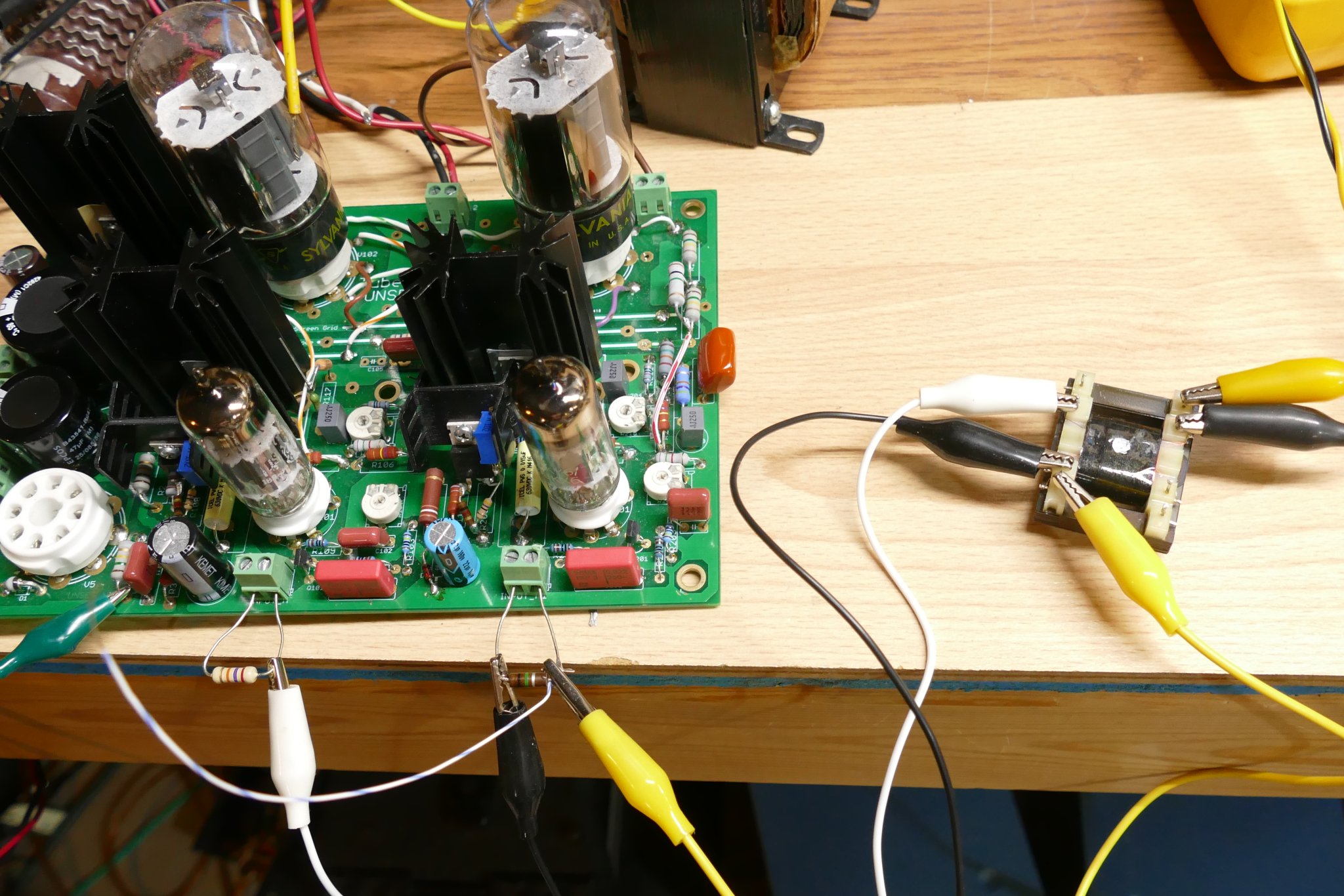

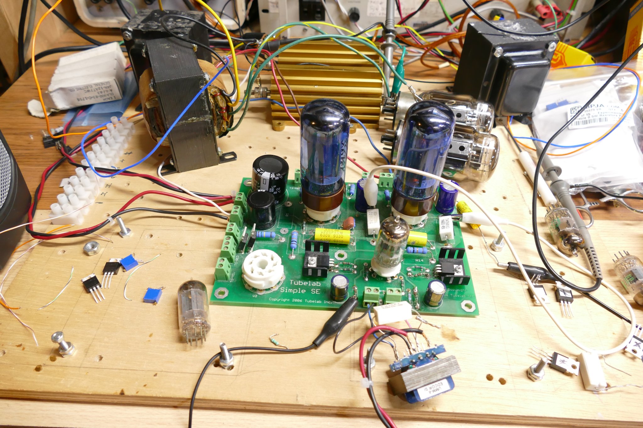

Here you can see a Tubelab SSE board, which is a two channel SE amp board for 6L6GC, EL34, 6550 and other tubes with a similar pinout. I used an Edcor UMM 8 transformer to split the phase on the input of the amp and simply wired a push pull OPT across the two plates with the CT tied to B+. Output tubes were "RUBY" 6L6GC's. This works quite well when driven from a low impedance source. When fed from a 600 ohm audio oscillator I got very low THD numbers like 0.724% at 1 watt, 1.035% at 10 watts and 1.99% at 35 watts where visible clipping was present.
My crummy old LG DVD player did not like the transformer load. I did a similar experiment with a small Parts Express "LEPAI LP-2020A+" solid state amp driving the transformer. I also used an old Hammond 1608 OPT instead of the guitar amp unit in the other experiments. I fed this from my PC through a Focusrite Solo and ran some tests. Clipping and OPT saturation were evident at low frequencies due to the 10 Watt OPT and power was lower due to the 8000 ohm load, Same Ruby 6L6GC tubes. Connecting up a speaker provided some really good sound, with minimal low frequency artifacts. My Yamaha NS-10M Studio monitors have very little output below 70 Hz despite large cone movements and they are in the 20+ ohm range below 100 Hz. I can't seem to find any of the old data though.
More recently I did the same thing with an UNSET board with similar results due to a request from the past. See post #563 here:
https://www.diyaudio.com/community/threads/unset-beta-board-build.376124/page-29
I tried the push pull hookup to see how an UNSET board did in push pull. It is likely that my ongoing guitar amp development project will use UNSET output topology due to its ability to transition smoothly from triode to pentode mode at the turn of a knob.
