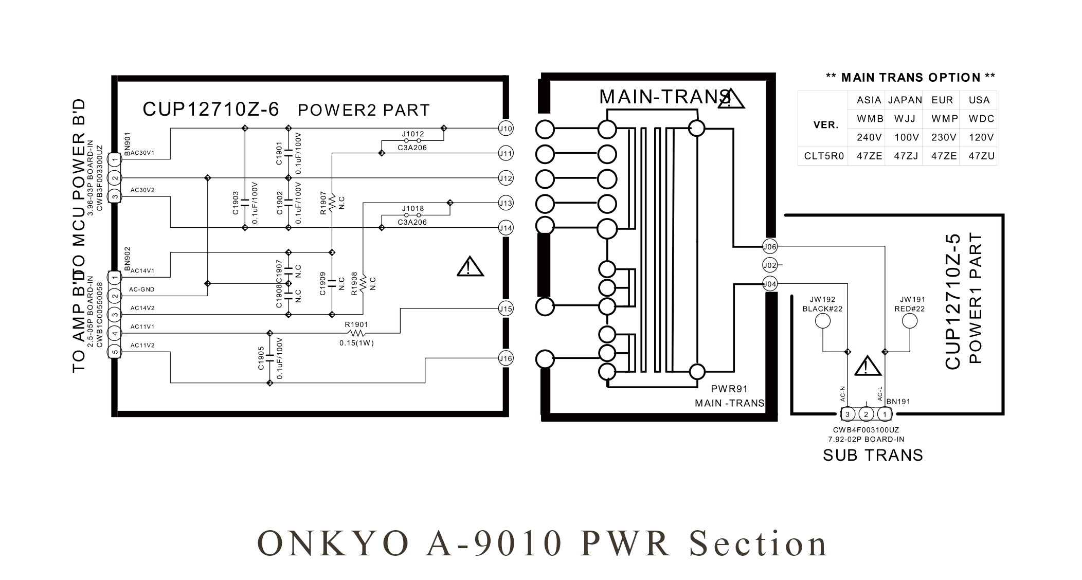

Since people are talking about the PWR possibly being a reason to the sound quality, here is that section from the service manual.

Which is fine. If it is not broken, why fix it.
I am a firm believer in that a good circuit is a combination of excellent components, good layout and good grounding plane. But could there be, lets say, physical damping attributes in transformer that reduce the electrical interference and audible sound. They are certainly using a EI transformer just like Yamaha and many others.

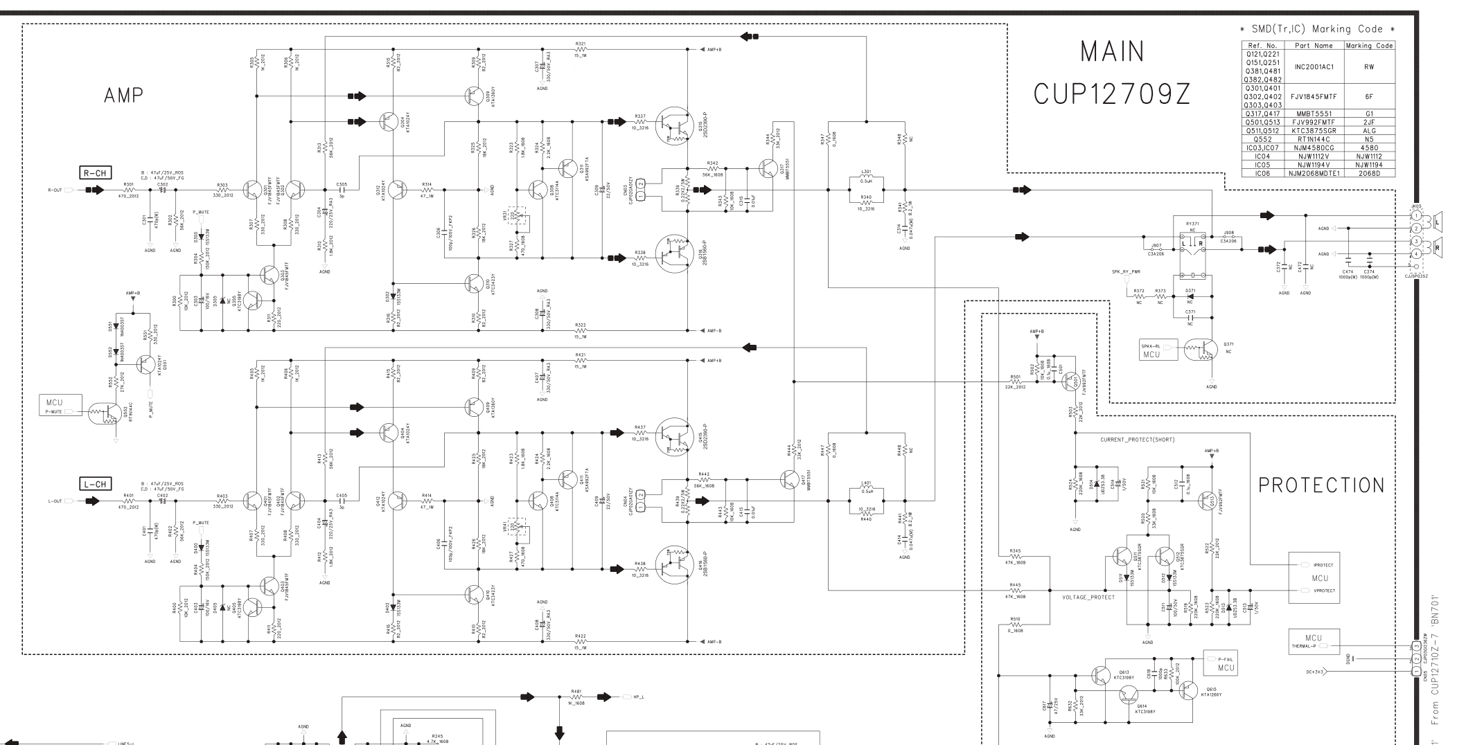

Without being able to measure ripple, EM, RF etc etc, besides only two complementary transistors in the output per chn, what could - hypothetically - be the reason for the clarity and low noise people report ? I have attached the amplification section of this amplifier, discarding the input section for now.
- EDIT -
Since I am learning I want to ask if anyone can see DC Servo. I know such a circuit is important and signify a good amplification.
some observations -
1 large emitter degen resistors on input diff pair will minimise "hard" slew induced distortion
2. symmetrical VAS with local feedback (just an observation, not necessarily a factor)
3. connecting the base of the centre PNP transistor in the differential VAS circuit to the driver collector common-mode cancels Early effect distortion (this is a potential factor)
4. Phase lead compensation reduces high frequency distortion (around 2-20kHz) compared with Miller compensation
Overall gain however will be low and distortion figures could be around 0.02%- not as low as can be achieved but nevertheless this would be OK (if it is that low).

some observations -
Point 1; Harsh as in steep ?
The others are also interesting observations.
