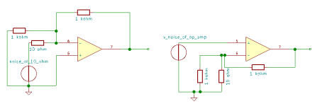

Because of the negative feedback. The 10 ohm resistor and 1 kohm feedback resistor set a gain of ideally -100 for the noise of the resistor. The equivalent input voltage noise of the op-amp gets amplified 102 times; model it as a noise source at the positive op-amp terminal, switch off all other sources and you see that for the op-amp's noise, the circuit is a gain of 102 non-inverting amplifier.

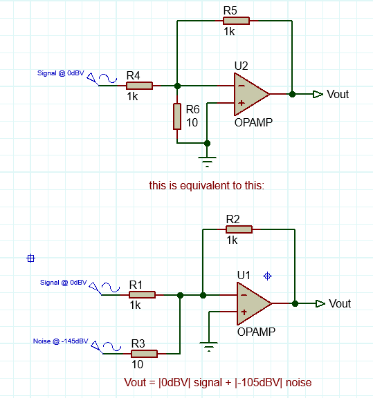

Ahhh! I can see it as a summing amplifier, amplifying the source 'signal' via the 1k a factor -1, amplifying the 'source' [10R noise gain resistor] a factor 1k/10.
As in the attachment?

Noise gain is the output voltage change divided by the differential input voltage change, assuming the amp is out of circuit and the output voltage is driven by a test signal.
If you model the noise voltage being between the two inputs, this is the amount it must be magnified by the opamp such that the feedback exactly cancels it - i.e. the closed-loop gain the noise is subjected to.
I think a lot of texts are very obscure about this, its a simple concept. Signal gain is about the output relative to the input node, noise gain is about the output relative to the differential input voltage, which are both properties of just the feedback network if the opamp is ideal (infinite gain).
Noise gain is also the critical parameter for stability, the opamp doesn't know about the signal gain, it only knows about the noise gain. For instance the NE5543A is stable for noise-gains above 3.
There are some subtleties this notion fails to capture, for instance the effect of capacitances between amp internals and the supply rails are ignored in the statement "the opamp doesn't know about the signal gain, it only knows about the noise gain" - its an idealization.
A simple follower has a noise gain of 1, but a unity gain inverter has a noise gain of 2. The inverter circuit is a resistor divider that halves the output at the opamp input. For instance the NE5534A should be stable for non-inverting gains down to 3, and for inverting gains down to -2

My confusion was from reasoning that whatever is 'hard' between the input pins (noise or otherwise) is amplified by the opamp ol gain. It has to; that is the way the opamp is build.
The noise gain resistor is 'hard' between the pins, but the noise source it is associated with is not; this noise source should be considered in series with that resistor.
As in my post 4 attachment. It is that resistance that allows the feedback loop to work on this source.
Makes all the difference.
