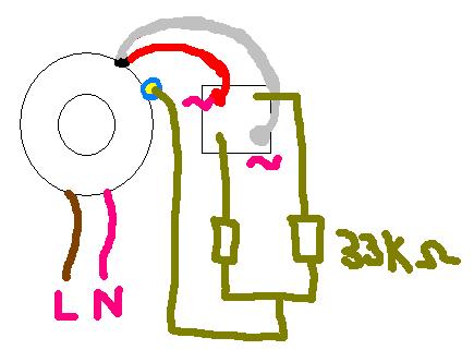

I have read numerous safety notes about "if you unsure about making a power supply, then don't!" But I figured that there is a first time for everything. Anyway, I have all the bits together. My 500VA transformer is rated as follows:
Prim: 2x115V Brown/White - Black/Pink
Sec: 2x40V Red/Yellow - Blue/Grey
* Because I'm in the UK (240V from the mains), I soldered the White and black together.
* I wanted +-55V so I soldered Yellow and Blue together to be ground.
* I soldered the Brown and Pink to the mains socket, via a 4A fuse and a switch
* I soldered the Red and Grey to the AC sides of the 35A rectifier.
* I didn't have enough solder for the caps, so I soldered two 33k resistors to the + and - of the rectifier to the Yellow/Blue
* Nothing is touching the chassis.
When I turned it on, there was nothing! I was expecting 57V (ish) AC from the rectifier, but the fuse had blown! This happens repeatedly!
Any ideas?! I have included a picture to confuse you even more!

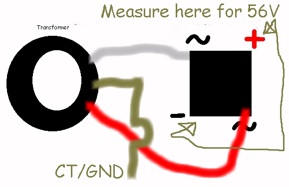

C
CryingDragon
try taking the center tap off you you have 3: your CT your + and - and test from the + and - to eachother and from them to the CT you should get yes about 56V from - to + and your rated voltage from each one to the CT. It seems like your shorting the secondary (you don't need those resistors).

OK, thanks for the great response!
* Nothing is touching the chassis nor Earth. Just Live and Neutral.
* The fuse was rated at 250V 4A. Ceramic type.
* All testing must stop until tomorrow when I get new fuses!
* The reason I put the resistors there was so that it would pull a current, albeit under 50mA. I thought power supplies overloaded without a load.
* I did try without the resistors first, but the same thing happened.
It is a brand new xformer and I'm sure that it all connected the right way around.
Gaz
