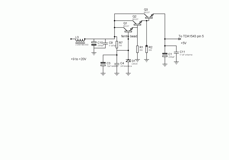

Peranders, I agree with you, this is not a cap multiplier. It would be if the 431 was replaced by a resistor, in such a way that the base of the first transistor is a fraction of the unregulated input and is "following" this input.
Also, there really should be resistors from the base of each transistor to its emitter or possibly another point to control the leakage. Look at it as the load resistor for the previous transistor: the voltage on this resistor becomes the input voltage for the next stage. If you leave it off you have no idea what is going on in the circuit and you might as well randomly throw in a handful of parts and hope it will work better.....:rolleyes:

Improved (?) Circuit
Jan Didden
Hi Jan,
I did throw some parts together again in the reaction vessel and this came out. Couldn' t resist it. Improved circuit ? I dunno. Slight of thin in the bass.
This circuit also works a a pure <B>capacity multiplier</B> when you replace R7 by 2M (two 1M in series) and the LM329 replaced by 1M. [You do read carefully Peranders?] Yes now the voltage is a fraction of the raw supply voltage and follows the variations in the mains volatge. But this is also a <B>working</B> circuit. Voltage after the inductor is 17.9V in my supply. Am I listening to euphonic colorations?:confused: :confused:
Elso, Per-Anders, Jan,
Since you are arguing about whether the circuit is a capacitance
multiplier or not, perhaps you should all define what you mean
by this term. I have a strong feeling you mean different things
with the term so the argument is rather about this term than
about the circuit.
Cap Multiplier(?)
Hi Christer,
I wil stop arguing about the term cap multiplier as Jan is right: the circuit with the resistors as I indicated is the original cap-multiplier circuit in the Low-Noise Electronic Design book.
Wether my circuit with the TL431 or LM329 is a cap multiplier or not I find in fact totally uninteresting. What counts for me is how it <B>sounds</B> and if it <B>works</B> in conjunction with the TDA1543 as a NON-OS DAC. Just in search for a better sounding supply regulator for the TDA1543, triggered by the finding of Patwen and the remark by Fred that quote: <B><I>The Jung regulators can be problematic with digital and D to A circuits because this resonances are more easily excited by the large high frequency currents. </b></I> (First page of this thread):angel:

Elso,
I just picked up on your quote from Fred and I do not completely agree.
The Jung regulators should get a capacitor at the output with a not-too-low ESR. Walter (and I, for that matter) have on various occasions (also IIRC in the AA article) explained that those very low ESR film caps everybody likes for coupling are NOT GOOD for any regulated supply bypass.
Every professional supply designer will select bypass caps with a close look at the ESR. If you keep yourself up to date on the modern low-dropout designs you will see that the capability to work stably with low-ESR caps is a big issue, because it requires specific design adaptions.
Unfortunately, most audio affectionados are so obsessed with very high quality low ESR coupling caps that it is automatically assumed that they are good for supplies also. Not so!.
