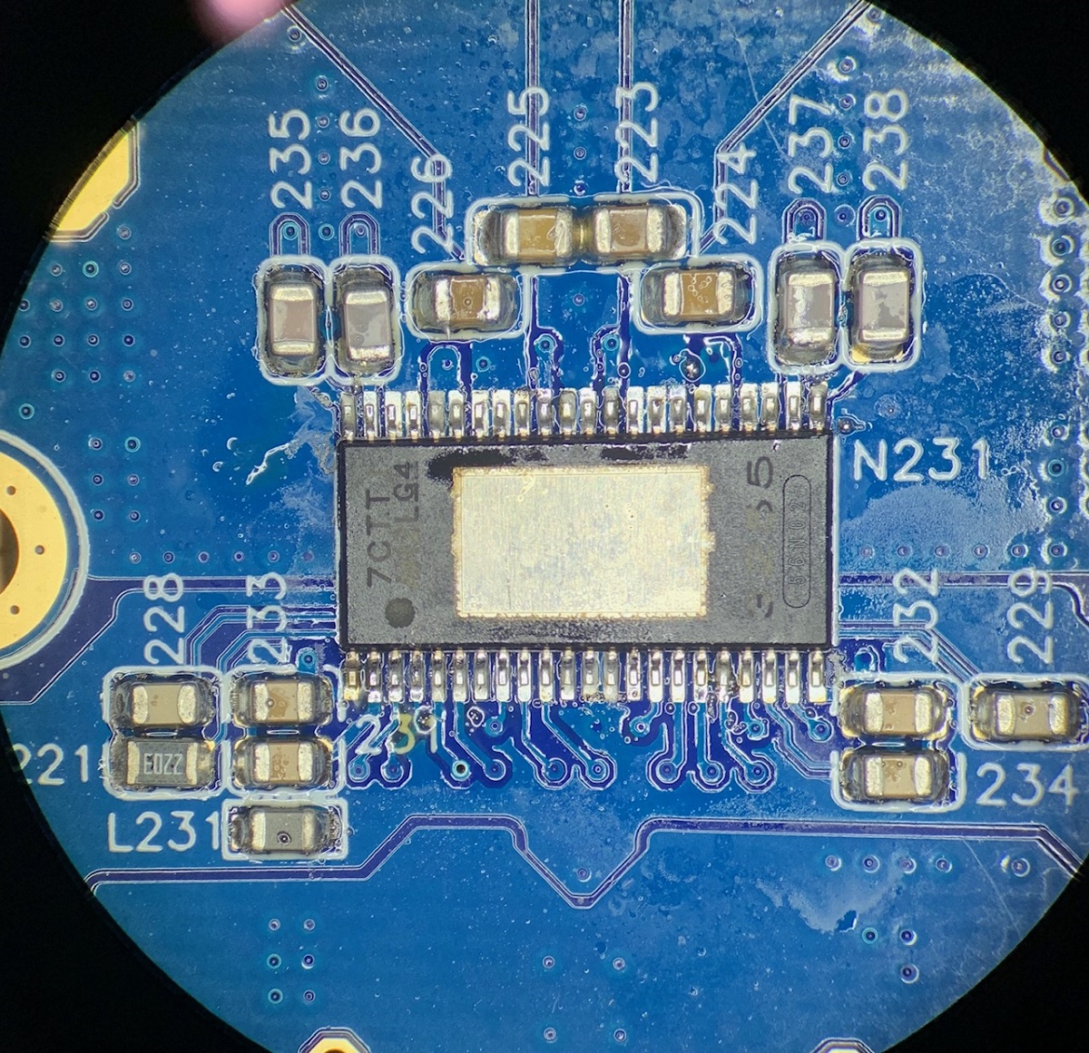

You may not get consensus, but you can believe that having a hot air pencil is important. Here is the sort of stuff I do with it.
And I have actually used it to pull this TPA3255 out and replaced it with a new one. So desoldering works too:
It is always helpful to have some added heat from the bottom side to preheat the board to a temp below the melt temp. This reduces the heat needed from the hot air above.
Edit - even a hot plate and skillet works for reflow or preheating the bottom:
Produces these:
Produces these:
