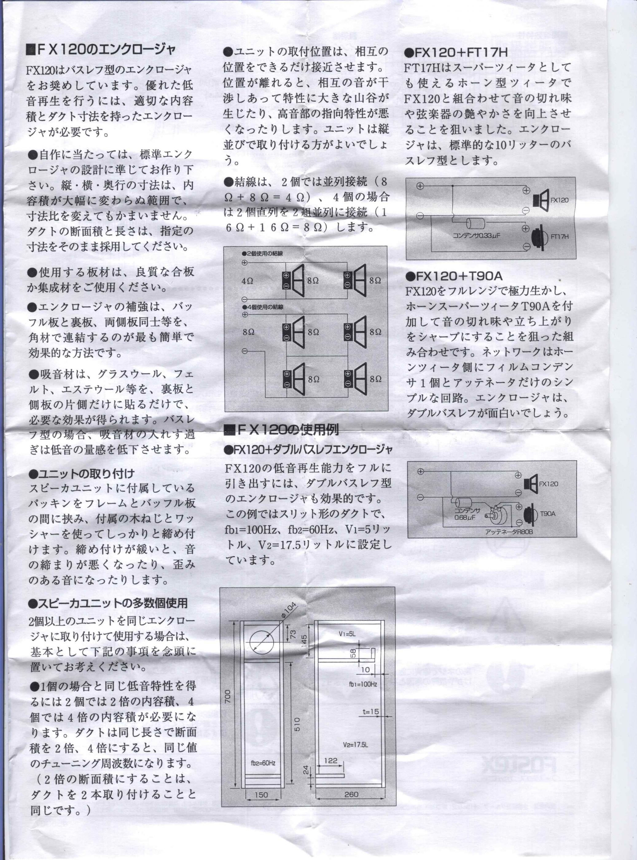

This is the recommendation for FX120 from the Fostex plans that came with the FX120 I bought. Don't understand a word, but it's clear the 2 alternatives.
Do you think the FT17H is good enough? as good as the equivalent in HIVI's?? or as the Fountek ribbons??
Also as simple as it is mentioned in the picture: just a Capacitor!!

PD if any body understands what does it say in these plans I would much appreciate your help.

That supertweeter is ~10db hotter than that FX120. The single cap method uses a cap which nominally crosses it over at say 40-50kHz, so that it is a the right level in the audible range. This might be annoying to dogs... ;)
You could also just use a 1uF or maybe .68uF cap with an L-pad control to match the level. (like the second diagram)
