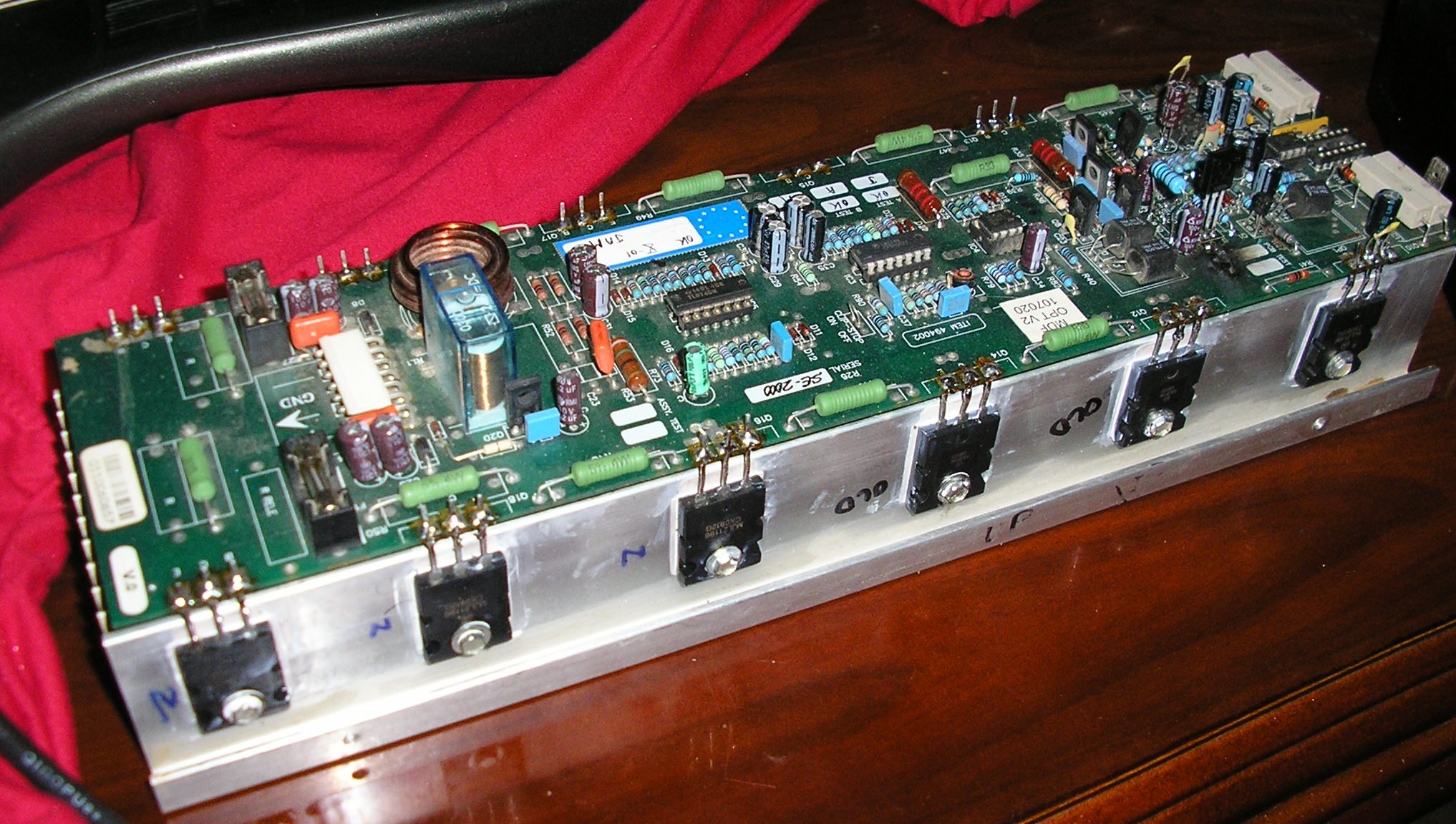

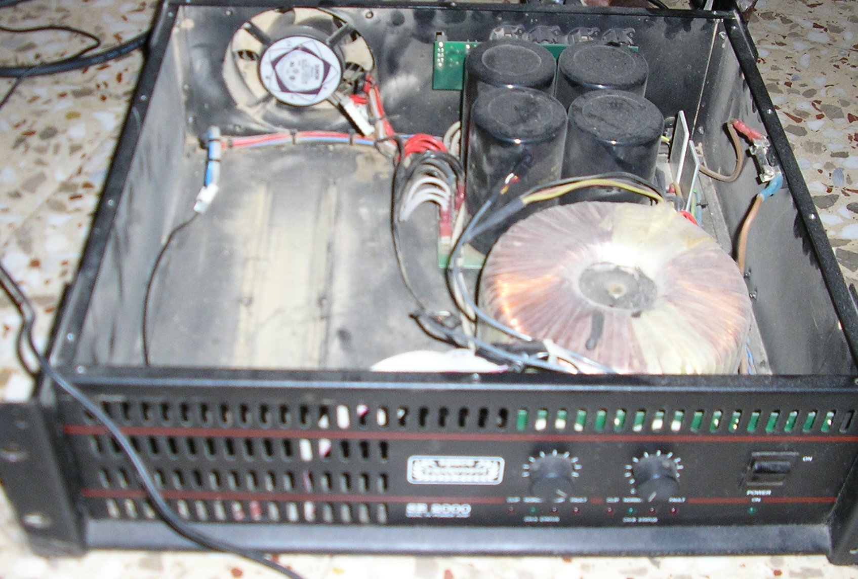

Last month, a cousin brought a 1kw per channel rack, one channel faulty.
After opening the rack I saw about ten resistors burnt and when checking the output transistors (MJL21196) they were shorted, so I replaced them and all the resistors, some MJE350 and MJE340, a BC238C. I've seen these amps in different cases and I suspect they're made almost identical in different brands. Anyway, each channel has 12 mjl21196, 6 on each side of a heatsink, and I've seen logic gates IC's and op-amps as in a crown schematic available on their website as "discontinued". Anyway, the issue is that since I've never touched a PA like this I have no idea where to start, two resistors keep burning, and I really have no clue where to start, I have the equipment (oscilloscope, signal generator, etc), but since I can't found the schematic for this amp, It's a bit frustrating. The fault is not on the power supply nor in the control circuit, I plugged it on the other channel and still the same. I guess you will suggest I study first the basis of the amp, but I have no idea if it's a class H or a class G. I've read that these amps are not worth repairing, but since the output trt's had been replaced, It seems worth trying. I've purchased some op-amps in case they are the problem, more trt's (small signal) and the optocouplers are difficult to find at reasonable prices.
I can read and study the topology, but as I said I have no clue where to start, I have the sloane book and I think It could be a start, but well, you guys know better than me these amps and maybe could give me a few (or a lot) of tips on what to read, and If I'm lacking some equipment to properly repair (I hope) this amp.
Here are some pics to help:
Rack Top view:

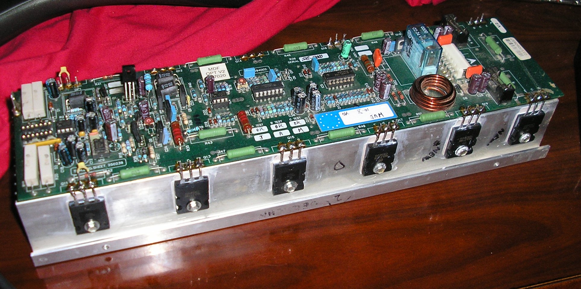

Power amp side view (1):
Power amp side view (2):
Power amp top view:

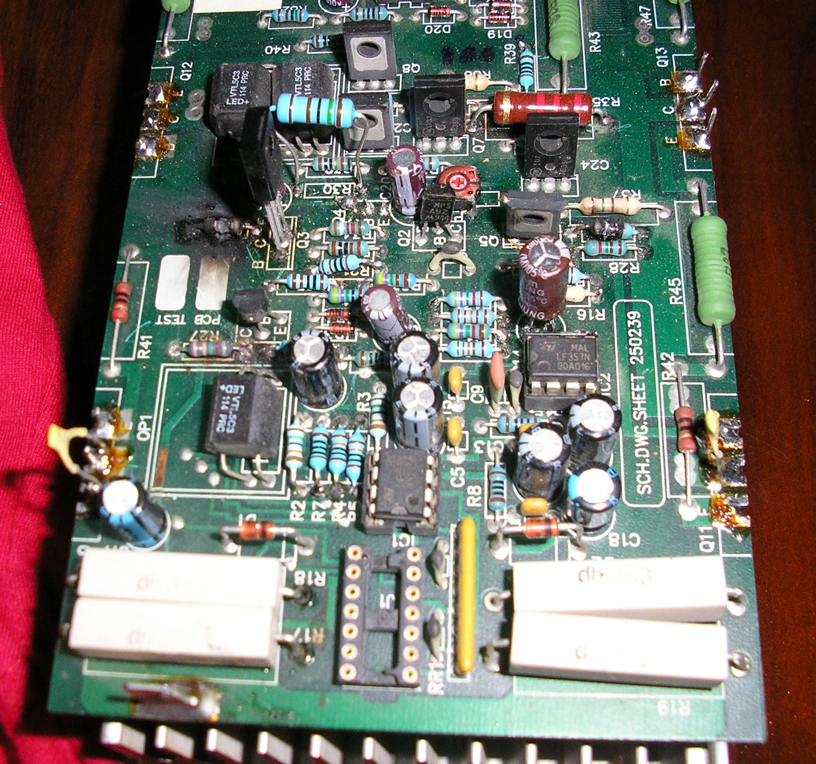

Power amp input section and burnt components (there is a BC238C on the bottom side of the pcb with thermal paste to the heatsink)
Kind regards.

Does it have multiple rail voltages or only one? Is it +/-X volts, or +/-X and 2X volts? I don't *see* anything on the boards that can be immediately identified as a rail switch or commutating diodes. If it's only a single rail (per side) it's just class B. I don't see driver transistors either, unless it's using one of the TO264 flatpacks as a driver.
Connect a 60w lamp in series with your 110v/240v supply, and disconnect the ok module.
Try running it up and see if ok at idle.
If not,the lamp should help prevent burning/blowups while you determine the fault.

Well, the manufacturer is "space equipment" and the model is SE-2000. I've seen them often in Spain, the pcb says It's made in the EU.
Did you mean this?
Did you mean this?

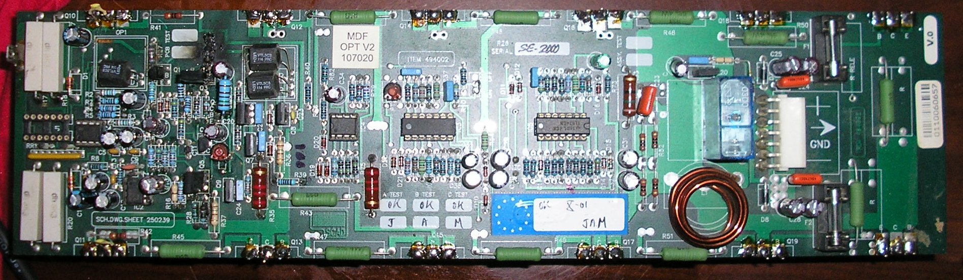

So it's just +/-110V, with no +/-55V mid-rails? Running class B at those voltages is ASKING for trouble unless the outputs are in series-parallel. Even then you'd want a few more.
I've checked the power supply inputs on the module, there are two wires for each +/-110V, but checking continuity they're the same, I'm going to check the power supply though, It seems that this feature is to avoid thicker wires on the power supply rails.
I'm a little confused, class B is push-pull, and all of the output transistors are npn, correct me if I'm wrong. It just doesn't add up If this a 1kw PA.
Edit: Must be a quasi-complementary design, the large inductor before the relay to the speakers now makes sense.
Probably 1kw into 2 ohms. Supply voltage is a little high for that - all you need for that is +/-95 and it would be more reliable. That's probably why the outputs keep burning out. The old QSC 1310 is 1k into 2R, and it runs on +/-95 and has 8 TO-3 outputs per bank. That's what you'd expect to see unless it's a class H - but that needs 4 rails which you don't seem to have. I wouldn't go blasting it or running subs on less than 8 ohms. For lighter duty maybe 4 ohms - but for that you don't need such a big amp.
All NPN designs don't make much sense for these things. The price on TO-264 NPNs and PNPs are the same. And I can't see the production volumes being so high that they'd get the massive breaks on say, a million pieces.

The other module works with this supply voltages, so I guess It must be my voltmeter that needs adjusting and/or replacement.
Anyway, the first two pairs of mjl21196 are not connected in parallel. As seen on the pictures there's 12 of them, the first row has 5 of them in paralel, same on the lower row, the 2 on the left must be the drivers, anyway the components that keep burning are two resistors which are associated with a mje340, a bc238C and a mje350. The BC is under the pcb and there's something wrong there, why they chose to put it in such a strange place I cannot understand, the BC burns and then the resistors, I will solder a new one on the top but It must run hot when it was put in contact with the heat sink. I think a better option would be a better trt in to-220 or similar and attach a small heatsink. The resistors burnt at the point that a track underneath was pulverized, I soldered a wire but that wasn't the problem. I'm running out of resistors to check.
I will keep posting when something besides burnt resistors happens.
I really don't know if they're really 1kw per channel, I'm missing the manual and on the back, where you expect to find this information there's nothing about that. The manufacturer changed since 2001 and now It's called mcm audio, located in Spain, It was the first thing I did, contacted them a month ago requesting information. No answer. This morning I tried to open their website and It's been hacked, so it's a dead end on this. Any suggestion on getting a replacement for the bc238c ?
It must be the bias regulator, when needs to sense the temperature of the outputs. When the outputs/drivers/predrivers fail, it can take this out. When I have a failed output stage I always replace this device (and its associated resistors) because it's so critical and easily destroyed. Just be mindful of the pin-out if you replace it with something different. The BC's are supposed to be CBE, but I've seen them both CBE and EBC. It's NPN, so collector is positive (it will connect to the base of an MJE340 predriver - with maybe a resistor in between).

Yesterday I checked some more components, There was a quad op amp lm354 shorted, the tl074 is fine as are the dual op-amps. I forgot to say there's also a temp sensor attached on the bottom of the pcb, but it's located more to the right and as for now there's no time to check this since the resistors burn before even the relay to the speakers connect.
I was checking one of the optocouplers and seems faulty. I have to talk to my cousin. I'm thinking that besides the output trt's that have been replaced It would be a good option to completely replace all the components, I have most of them anyway, check the PCB properly for burnt tracks, and most important, make an schematic that could allow me to understand this amp. Anyway, the suspect now is a vlc5c3 optocoupler (the led side).
About the schematic I remember that once I did this using the PCB, locating all components in altium and then back to an schematics, just the opposite of the workflow, It was for a 80's computer interface and worked fine, lots of tracks (digital), took me a while but, well, after all we are in diy electronics because we like it.
I also suspect the vias in the pcb not making appropiate contacts so I will start a "bom" and then unsolder and make a schematic. Thanks for your tips and I will keep working.

One method that proves useful in certain circumstances like this one, and taking advantage that you have one perfect amp channel for refference is to make cold measurements.
Replace all known bad components on the bad board. Then do cold measurements in both the good and the bad boards. Do all type of measurements with your DMM, in resistor, diode, capacitance settings. Compare back to back.
You will most likely find the issue without applying any voltage.
