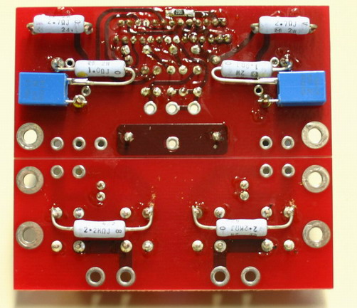

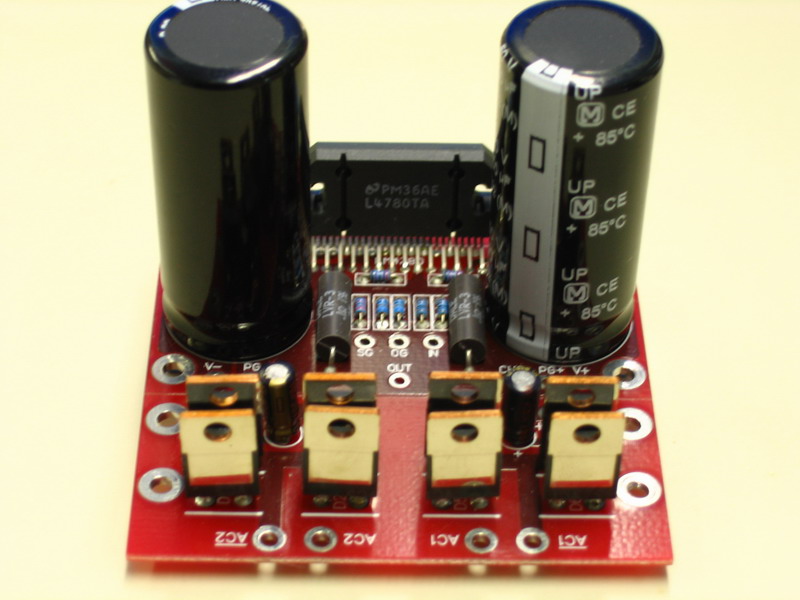

I've managed to place 6.800 mF caps just next to the chip on Peter's LM4780 board (see pics). I also put the snubber right on the caps pins. And now I have a question. Do I miss anything on the board? Can I leave out all the other bypass caps which are in the original layout from Carlos?
Cool.
But you should listen to that amp with 20,000~30,000uf capacitance per rail and the new values, as on the latest snubberized PSU.
It's a good upgrade.

vasja said:Do I miss anything on the board? Can I leave out all the other bypass caps which are in the original layout from Carlos?![]()
Who, me?
Notice that you have a good place to put the 100nf caps, you just need to place the snubbers with another orientation.
Also, the 330nf cap between the rails I use (on those boards) directly on the chip's pins, under the circuit.
Thanks Carlos
I'll use 20.000 mF with the new LM4780 board from Peter

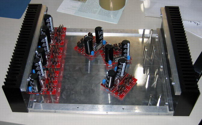

There, if mounted on the bottom side of the PCB, it is possible to use 2x10.000 mF on the chip's board and another 2x10.000 mF or even more on the rectifier board. As for the pics from my previous posts, this is one of the six channels for my home cinema setup
