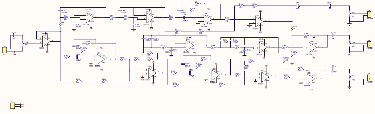

I used for the calculation the on-line calculator from V-cap.
Coupling Capacitor Calculator by V-Cap
In the design of my active crossover there are two bi-polair capacitor (47uF) in the output (bass). I have the intention to replace them by one MKP of 22uF. Although the 22uF seems to me a very high value here, it seem a good idea....or not.
If you want the AC coupling capacitor to pass all of the audio band then you must select a VALUE that gives a low enough frequency that allows all the audio band to pass.
The general recommendation for this is to allow at least two octaves or even a decade lower than our 20Hz limit.
That would put the F-3dB of the coupling capacitor filter at somewhere around 2Hz to 5Hz.
Some would choose to go even lower.
But you need to choose your F-3dB frequency and for that you need to know what filter values to use.
Just specifying 22uF tells you and us nothing about the final filtering F-3dB.
You need C and R values !
