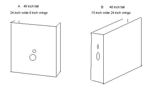

Case B will result in significantly lower bass than case A. With case B the rear wave must travel 48" more distance than the front wave, although a significant amount will take the short cut over the top. With case A the additional distance is only about 24". With B though you will change the radiation patern toward cartoid and your wings will need extensive bracing because significant pressures will be exerted on them.
chris ma said:Hello there,
If I go with case B and using active bi-amping do I still need to use BSC?
BTW I am also using H-frame dipole subs for 60hz down, not expecting OB case B to produce too low bass.
bi-amping is a little tricky. First you need to compensate for impedance variation, then listen and measure to determine if BSC is needed. If BSC is needed, you will most likely have to implement it prior to bi-amp.
