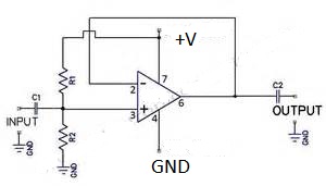

First time using a breadboard, first time making an active filter. I've done countless hours of research, and I can't seem to get this second order high pass to work. Reconfigured the board I don't know how many times, added a 5x gain path, and still nothing.
I have the incoming signal from my iPhone or iPad, output is going to a little 15w amp board. The output always sounds extremely quiet (much quieter than if I were to just touch the input and output ground and + to one another, bypassing the breadboard. Also, there is no audible change when I turn the power supply (12v) on vs when it's off. I'm currently using the +, -, and ground from the power supply, but I HD previously configured a rail splitter w/ two resistors and a cap, and hooked it up to the same power supply (power supply had its - and ground leads bridged from the factory. It's an eBay 0-30v variable power supply.

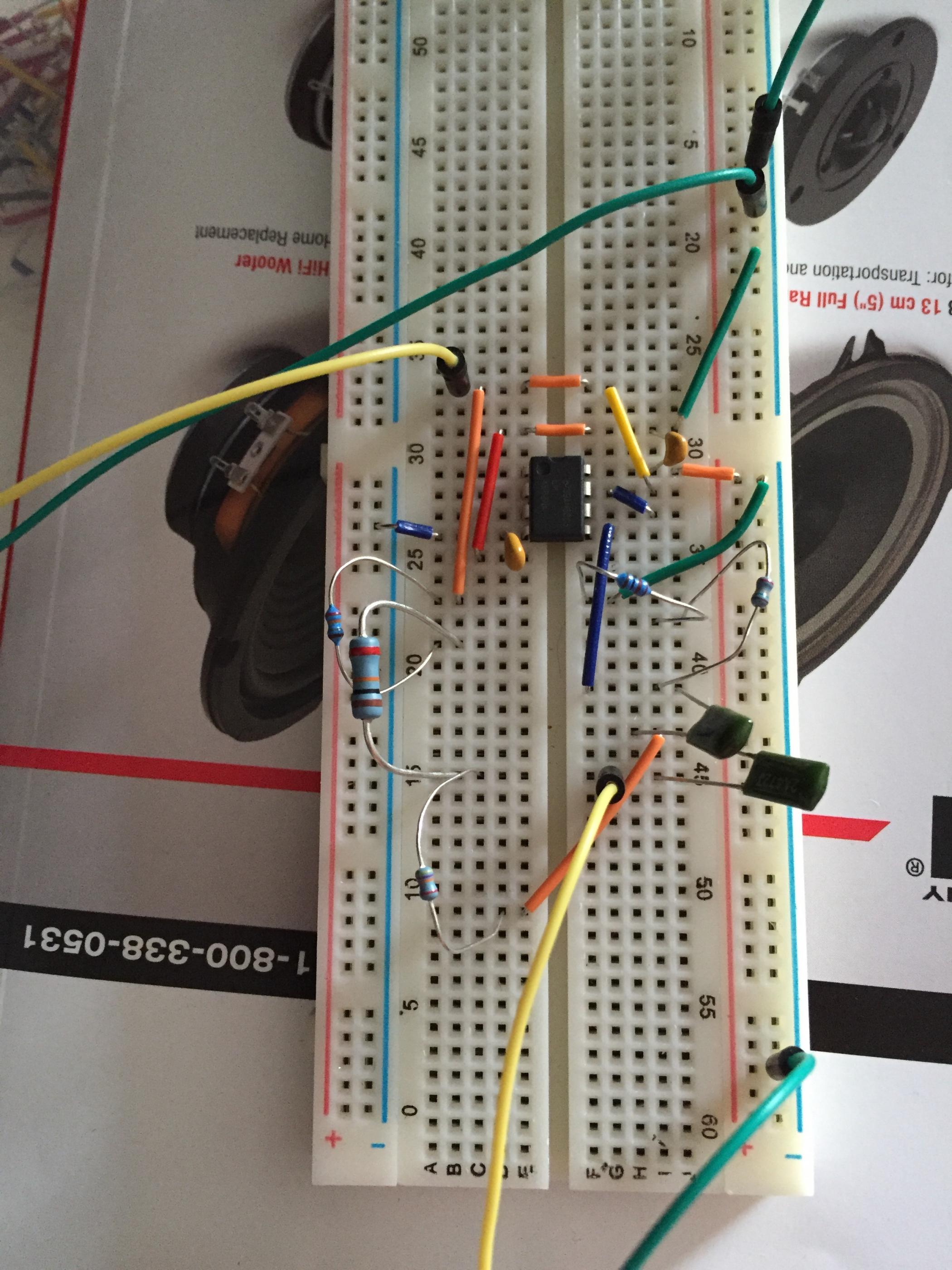

I rewired the board w jumper wires placed as clearly as possible, so I could post a photo for any of the experts here to lend a little wisdom.

Components are:
Lm4562 opamp
.1 uF bypass caps
.0047 uF C1 & C2
75k R1 (the three resistors in series)

From the looks of your connections there is no power to the opamp (though I can't see the entire breadboard). There is nothing visibly plugged into the + on the right of the board (note that with my breadboard the top half and bottom half are separate circuits as well) and similarly I don't see anything on the negative row on the left side of the board.
Ideally you should use a split supply (assuming you have a dual rail opamp) otherwise you will need an output cap.
I would not advise connecting it to anything until you have checked voltages with a multi-meter, especially that you don't have any DC on the output.
edit: posting the schematic you are working from would help too 🙂
Tony.

Lesson #1: when your first breadboard came from eBay with zero description on the packaging, be sure to pull off the back adhesive strip to check whether the + & - buses go all the way down the length of the board.
Sure enough, mine are also separate circuits.
I'll hook up my power supply to the board again tomorrow, and check output with a multimeter. I've been using the right (-) bus hooked up to the ground port on my power supply, the right (+) hooked up the the + on my ps, and the left (-) hooked up to the - on my ps.

That is the telling sign. As Wintermute observes, your circuit is probably not powered - whether by mis-wiring or because the opamp is damaged. First, verify that the op-amp is being correctly powered by measuring the supply voltages directly at the device pins.
The broken red and blue lines indicate a break in continuity.

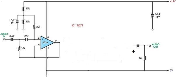

Troubleshooting can approached by simplifying the circuit.
One way would be to remove all the present connections and connect the op amp as a voltage follower (-input to output jumper), with +input connected to the voltage divider. Once you have the op amp working as a unity gain voltage follower you can precede to installing the high pass filter components.
It sounds like you have a single output power supply, you will need to bias the +input with a two 24K voltage divider to provide a voltage half way between the power supply +/- terminals. The – terminal is GND. The op amp will require two capacitors one on the output and one on the input voltage divider to block the DC voltage.
Test the voltage follower: The voltage at the +input should be the same as the output voltage. Then you can connect the input and output to an audio source and amplifier. The op amp will not drive a speaker.
You will need an audio oscillator and scope to test the filter performance and frequency response.

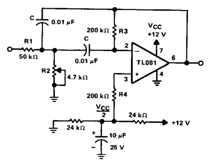

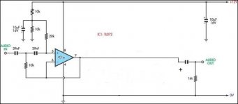

Here is an example of a single power supply High Pass Filter.

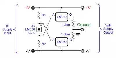

This is the virtual ground circuit I was thinking of building next:
